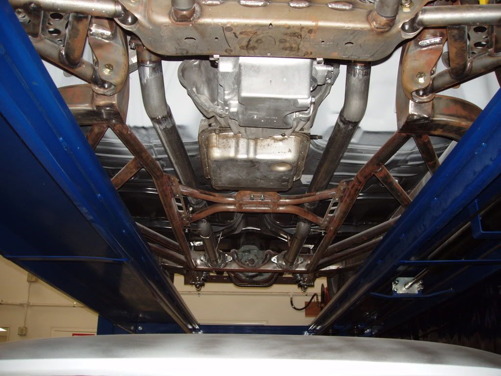

Here is a 68 Chevelle convertible that we are currently working on here @ the shop.. This build has gone the several changes from when we first started.. Saving the shell was a challenge!! The car was an east coast car & had rust on the floor, rocker panels, kick panels qtrs, doors, & fenders.. I was lucky enough to find a doner coupe that gave its body parts to this build!!!
LQ9 motor
4L65 transmission
Magnacharger
Roadster Shop chassis with Detroit Speed clip & rear suspension
9 inch Ford with 3.50 gears

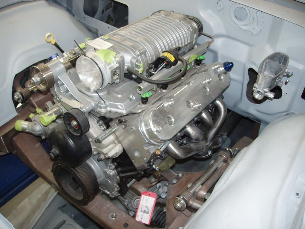

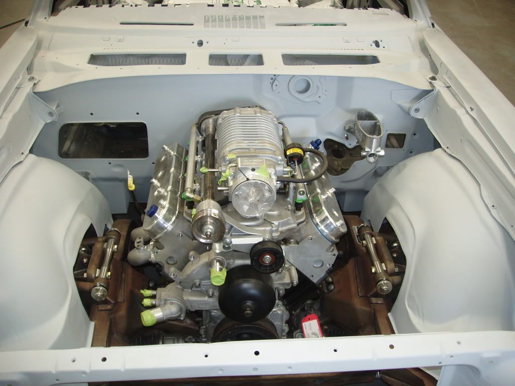

3 Attachment(s)
Yes! Here are some pics of when we did the mini-tub.. We are running Forgeline wheels on this build.. 19x12 with 345-30 19

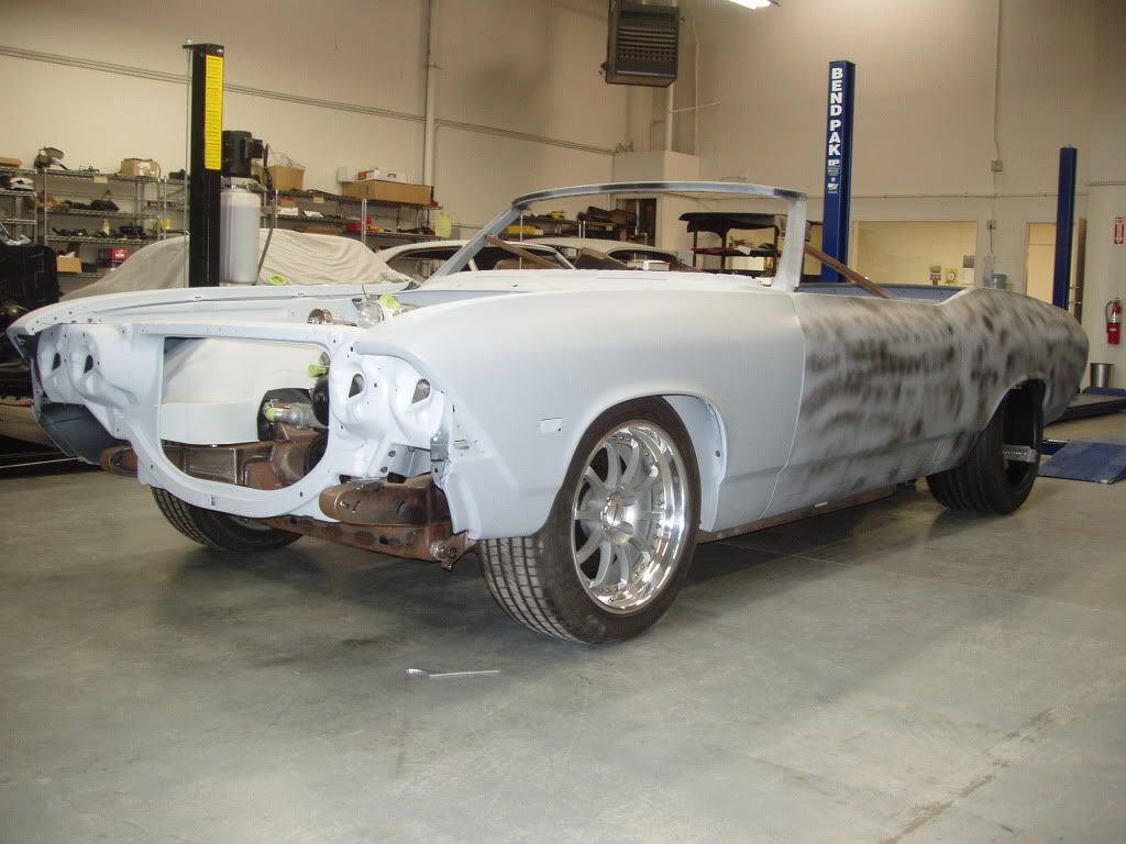

With Forgelines special on wheels, we moving forward on getting some wheels & tires on order :D We are running the ZX3R on this ride.. 19x12 on rear with 315-40-19 & 18x9 on the front with 255-45-18.. Goodyear F1 Tires..
We also have been working on getting front sheet metal on & aligned.. setting up suspension & setting up ride height :unibrow:

Thank you for the compliment! When we mini tubbed the car, the customer did not want me to cut to much into the structure that would mess with convertible top frame coming down.. We only moved the inner wells 2 inches in for tire clearance.. I remember that when I ordered the chassis you mentioned that 345 in the rear & the 275 were the biggest tires we could run underneth the car.. Also customer wanted me to fill out as much of the wheel well opening as possible, so this why we are going with the tire combination I have listed.. Did not want to go bigger than 19/18 diameter wheels!

This build has been moving slow but here is what we have so far.. Exhaust is on hold till owner determines if automatic or standard on transmission..

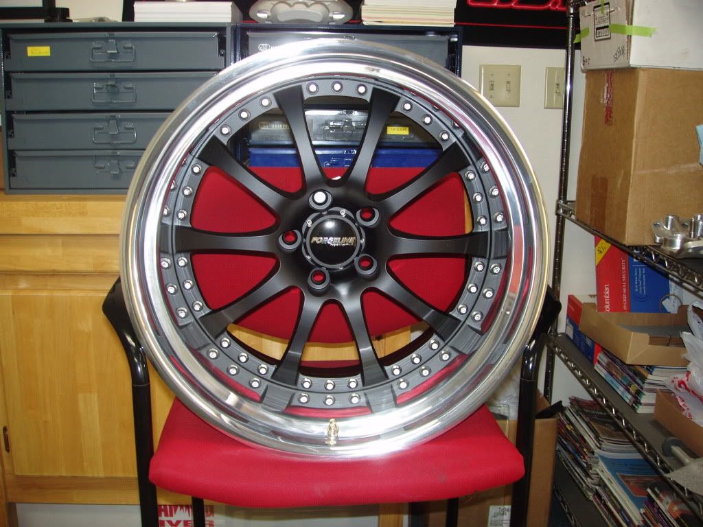

New wheels
http://i1015.photobucket.com/albums/...n/P2090004.jpg
Some exhaust work
http://i1015.photobucket.com/albums/...n/P2090005.jpg
Heat exhanger for supercharger
http://i1015.photobucket.com/albums/...n/P2090006.jpg

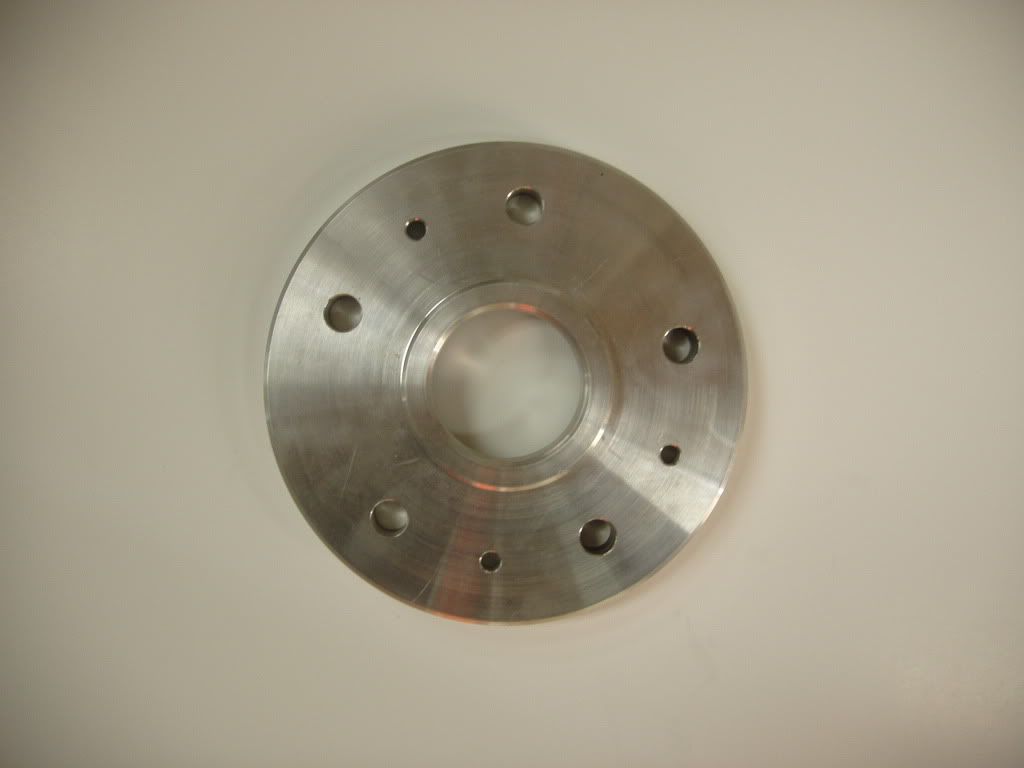

Custom wheel spacers for rear

These wheels from Forgeline are my favorite, especially with the black centers!
