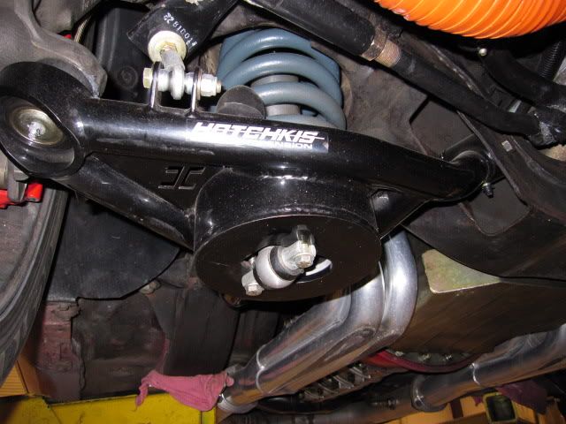

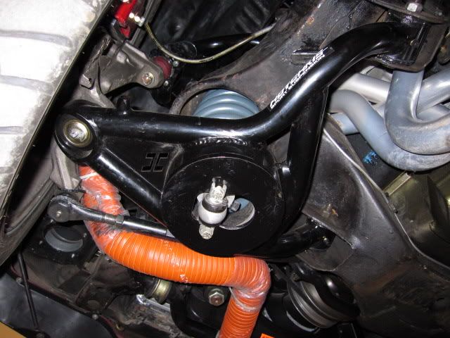

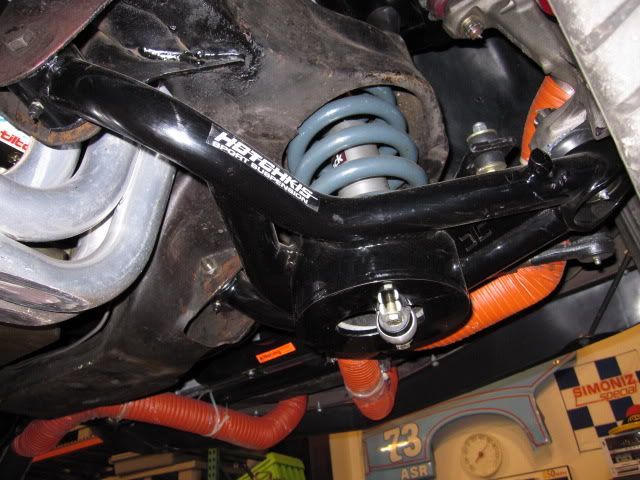

mpozziCPL 11-16-2009 08:15 PM
Here's a few pictures of the installed Hotchkis tubular control arms for a second-gen Camaro. I'll take more when I get the wheel off. This should give you some idea about the quality and appearance of the arms.
http://i133.photobucket.com/albums/q...s/IMG_0023.jpg
http://i133.photobucket.com/albums/q...s/IMG_0037.jpg
http://i133.photobucket.com/albums/q...s/IMG_0026.jpg
Mary Pozzi
thedude327 11-18-2009 08:58 AM
Mary,
Thanks for posting the photos. Seeing the arms installed on your second gen gives me an idea of how well the parts fit together. If you have any additional photos with the wheel off, that would be great.
Thanks, this has given me a good idea of what to use on my camaro.
Paul
