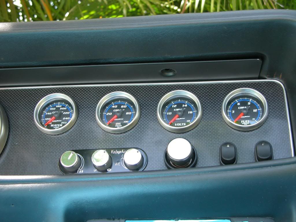

"How to" carbon fiber dash panel for a 2nd gen bird. Anvil, Autometer, Vintage Air...
I recently built a custom carbon fiber dash panel assembly to fit in the stock 2nd gen dashboard of my friend Tys car, "Freedom Bird" which is being built at Fletchers Customs. The panel was made using Anvil Auto carbon fiber. Installed in the panel are, Autometer Cobalt gauges, Vintage Air controller, American Autowire headlight/lights switch, NOS arming switch, Pypes exhaust cutout switch, aftermarket delay wiper switch, and topping off everything is a set of Twist Machine billet gauge bezels.
This thread will detail the "How To" so that anyone who wants to create a custom panel for their own car can see how it was done. The same procedures to fabricate and mount the panel could be performed using other types of materials for the panel. Below are a few pics of the panel as it was installed at the SEMA show. A few things are not quite finished in the pics due to a show deadline and pieces which had not arrived in time for the show. A shift light will be installed in the space under the gas gauge between the Tach and Speedo, a billet bezel for the wiper switch, different toggle switches and a small "bird" emblem in the space next to the VA controller. The last post containing instructions in this thread will list the companies websites as well as tools and other things needed to complete the operations.

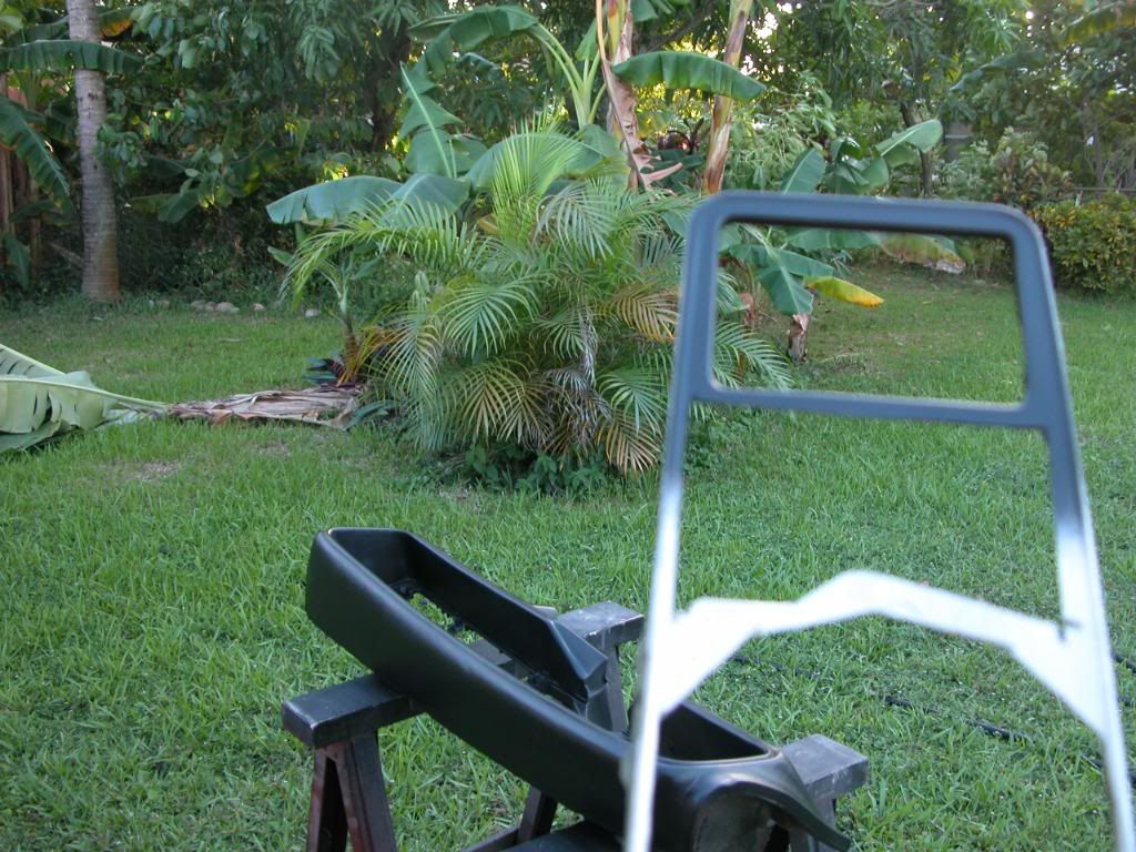

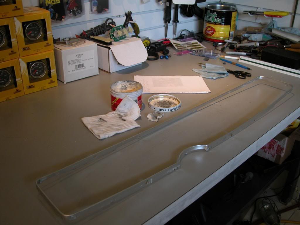

The first step is to remove the hood from the panel. This is accomplished by filing or grinding off the heads of the rivets holding it to the panel. Don't try drilling them out, it doesn't work well.
http://i240.photobucket.com/albums/f...shbuild018.jpg
Once the hood is detached, remove the 2 screw clips on the bottom of the panel where the screws that come up from the bottom hold the panel in place when installed in the dash. Be very carefull not to bend or twist the bezel which might deform it enough to see from the front after reassembly. I find the clips are most easily removed using a dental pic and small pair of needlenose pliers. PUT THE TWO CLIPS SOMEWHERE YOU WILL NOT LOOSE THEM!
http://i240.photobucket.com/albums/f...shbuild019.jpg

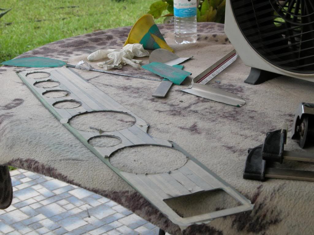

The Bezel has several folded over tabs which hold it to the facia. These tabs need to be VERY GENTLY straightened out. This allows the bezel to be separated from the facia. Remove the bezel and put it in a safe place where it cannot get bent.
http://i240.photobucket.com/albums/f...shbuild020.jpg
http://i240.photobucket.com/albums/f...shbuild021.jpg
Wiggling the individual gauge rings will allow them to be removed from the facia. Also remove the Radial Tuned emblem. Once this is done get a piece of posterboard and lay the facia on it face down. Then put a heavy weight on it to keep it still and hold it flat to the bench.
http://i240.photobucket.com/albums/f...shbuild022.jpg

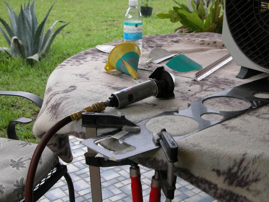

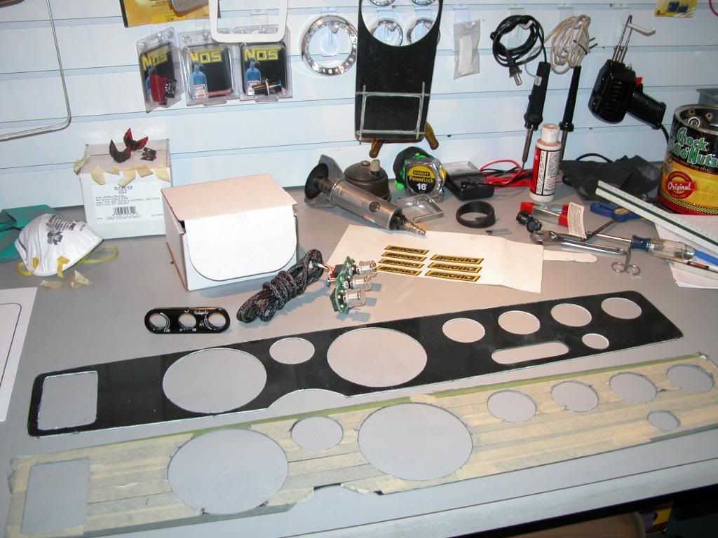

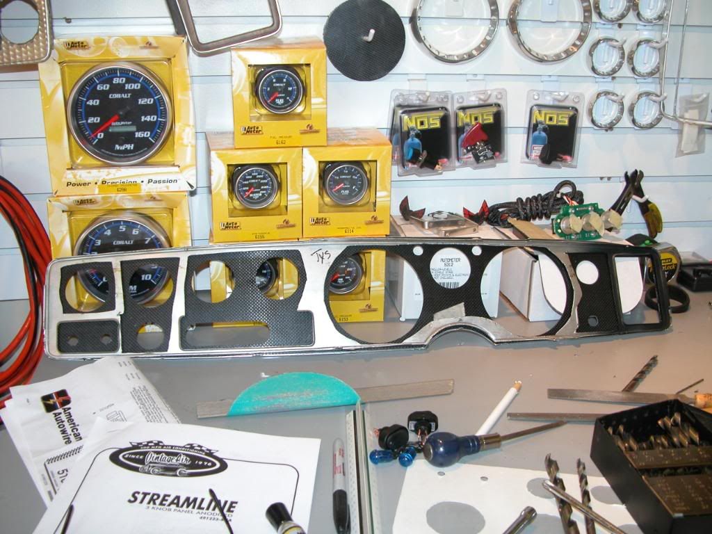

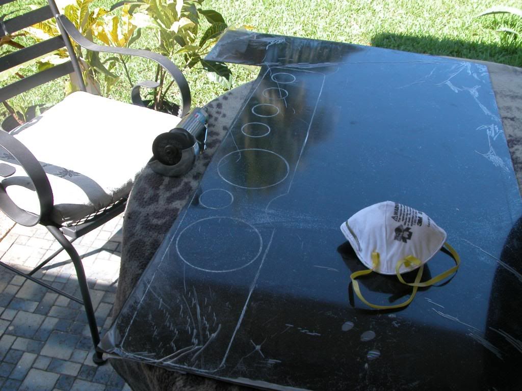

NOT A TA 11-22-2009 07:11 AM
At this point you should have a plastic sheet with all of the openings you'll need for gauges, switches, turn indicators, and the vent. You can put the bezel on the plastic sheet and test fit it one last time in the dash. If everything looks good it's now time to use the plastic sheet as a template to mark the carbon fiber sheet that will be the new facia.
The sheet comes with a protective coatiing on it. If you can't see through the protective film well you can remove enough of it to examine the carbon fiber for imperfections etc. in the weave. Most of these sheets are laid up by hand so there are minor variances in the appearance. Its not like the fake stuff with a perfect look. Also there may be minor scuffs or scratches from handling even with the protective coating. Minor scuffs or scratches can be fixed later if necessary by scuff sanding the surface then clear coating and polishing. Pick the nicest looking side and then lay your plastic template on it trying to line up any imperfections where they will end up where an opening will be cut out. Tape the plastic in place and mark the carbon sheet with a grease pencil.

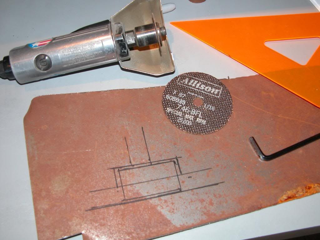

Cut the carbon fiber panel out of the sheet with a cutoff tool. Wear a respirator and eye protection. You may also want to wear latex or nitrile gloves as the fibers may irritate the skin like fiberglass does. You can not cut the carbon with a Dremel tool so forget even thinking about trying it. This is tough stuff as you're about to find out.
http://i240.photobucket.com/albums/f...shbuild102.jpg
http://i240.photobucket.com/albums/f...shbuild104.jpg

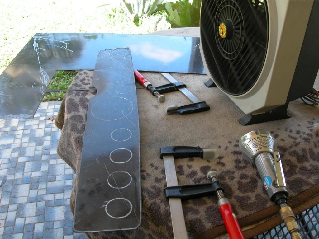

NOT A TA 11-22-2009 03:51 PM

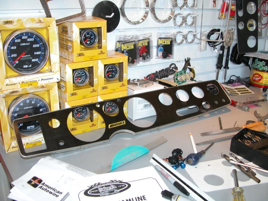

Now you need to file and sand the Carbon fiber (refered to as CF from now on) facia till you have an exact fit in the bezel. A fine toothed metal file works well to rough it in and then and finish with 80 grit sandpaper. When you think you've got the fit correct put the CF facia in the bezel and then put the original stock facia behind that and use some clamps to hold everything. This way you'll be able to check for a more exact fit.
The center area by the steering column can not be taller than the original facia or it will be very difficult to install the completed panel in the dash. It is easy to end up with the center of the panel too tall and have it still fit in the bezel when you are fitting it without the original bezel in place because of the flexibility of the bezel. If it is too tall there it will also be difficult to pop rivet the completed assembly together later so be sure the CF panel is exact.
http://i240.photobucket.com/albums/f...shbuild088.jpg

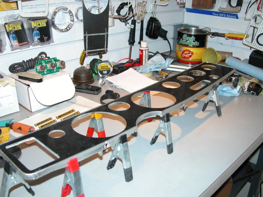

NOT A TA 11-22-2009 04:01 PM

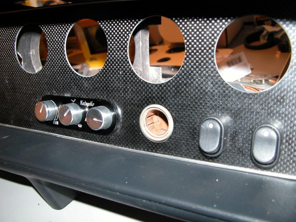

Now that you have the CF facia outline finished it's time to make all of the other openings. First cover the front side with masking tape so you don't scuff it or scratch it up. Cut the holes for the gauges with a hole saw using a drill press. Make sure you have wood under the CF facia and clamp it down when drilling. You will need Bi-metal hole saws to cut the holes. If you're using the 5" and 2 3/16" gauges you will need a 4 1/4", a 2 1/8", and a 1 1/8" for the lighter and headlight holes. Once the holes are drilled you will need to file and sand the openings to the correct dimensions.
You can cut out the vent and Vintage air controller openings with the cutoff tool and then file and sand to finish.
http://i240.photobucket.com/albums/f...shbuild118.jpg
http://i240.photobucket.com/albums/f...shbuild107.jpg
http://i240.photobucket.com/albums/f...shbuild108.jpg
http://i240.photobucket.com/albums/f...shbuild115.jpg

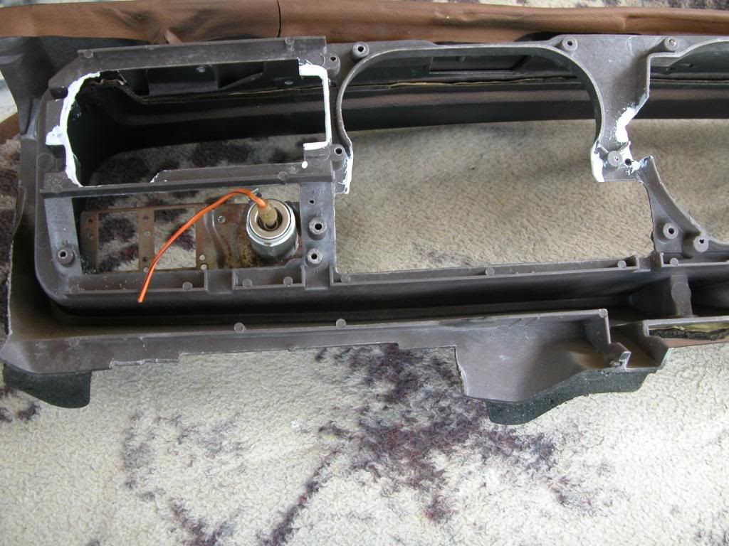

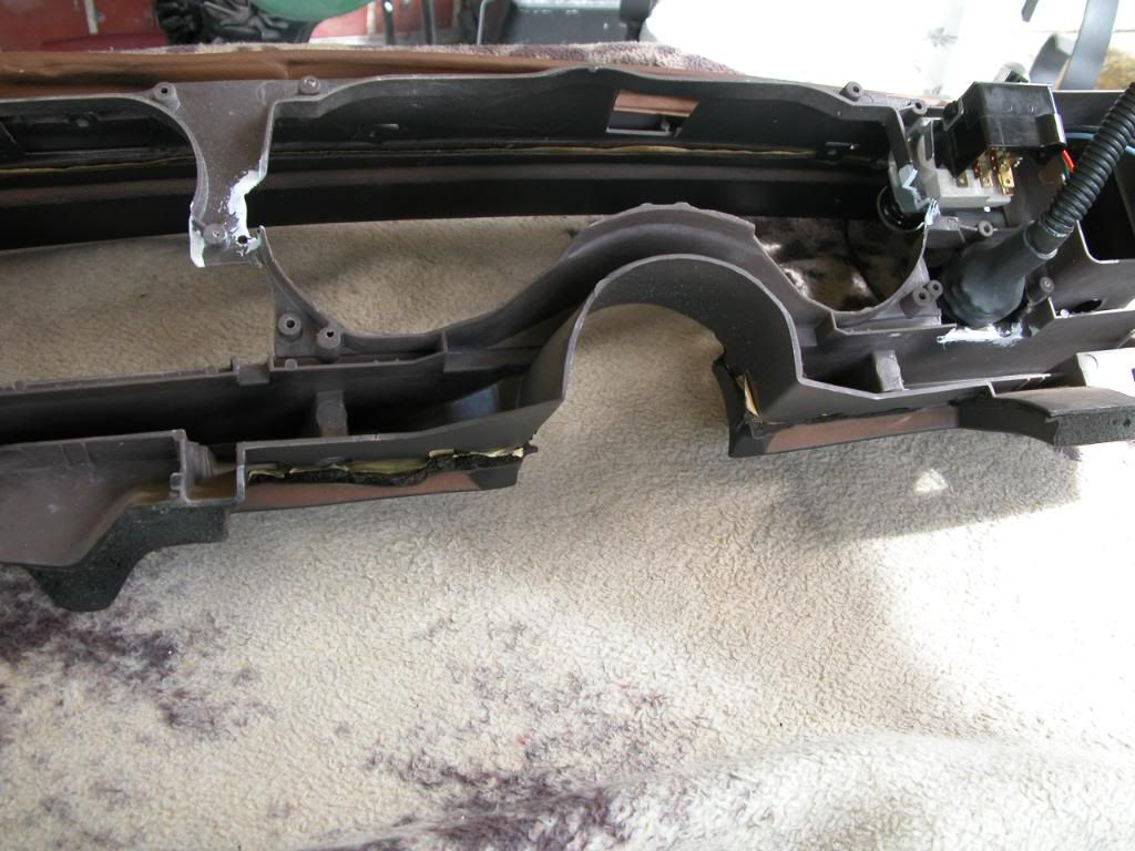

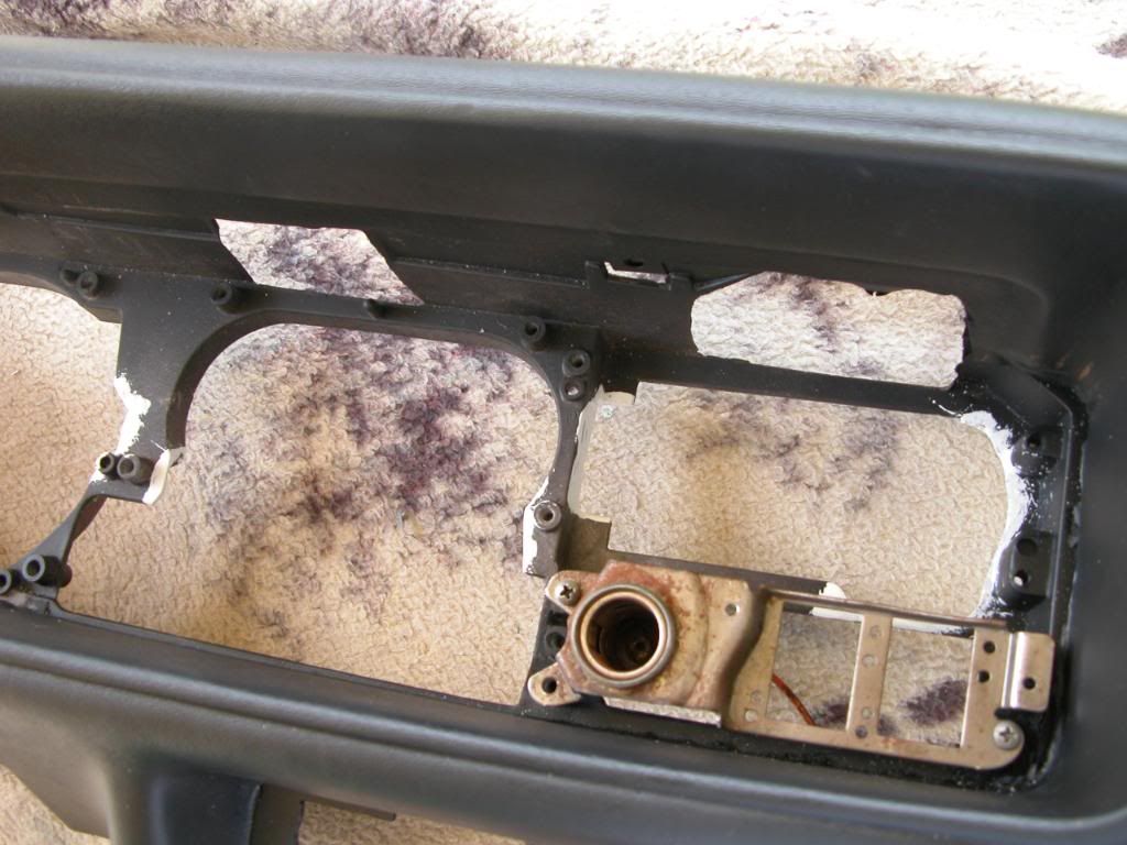

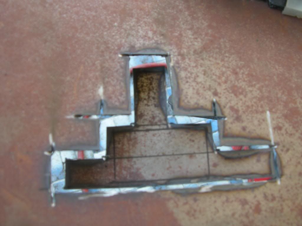

Now it's time to modify the dash structure for clearance for the gauges. You should put some masking tape around the edge of the CF panel because you will be putting it into the dash several times to check for clearance of each gauge. Do not try to assemble the pieces of the new panel yet. ONLY USE THE CARBON FIBER FACIA WITH ONE GAUGE AT A TIME TO CHECK CLEARANCE.
In the pictures below I put white paint on the areas of the dash framework where you will have to cut the plastic away. It is much easier if your dash is out of the car but if it is in the car it can be done, it's just more of a pain to work in there.
You can use a fine toothed hacksaw blade with a hand held blade holder to cut the plastic and then break out chunks as you work your way across the area where the panel fits into the dash. Once you think you've got it set then install one gauge with the retaining bracket screwed onto it in the CF facia and place the facia into position to check clearance for that gauge. Repeat for all gauge openings.
http://i240.photobucket.com/albums/f...shbuild201.jpg
http://i240.photobucket.com/albums/f...shbuild202.jpg
http://i240.photobucket.com/albums/f...shbuild203.jpg
http://i240.photobucket.com/albums/f...shbuild206.jpg
http://i240.photobucket.com/albums/f...shbuild208.jpg

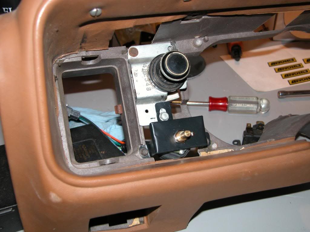

NOT A TA 11-24-2009 04:27 PM

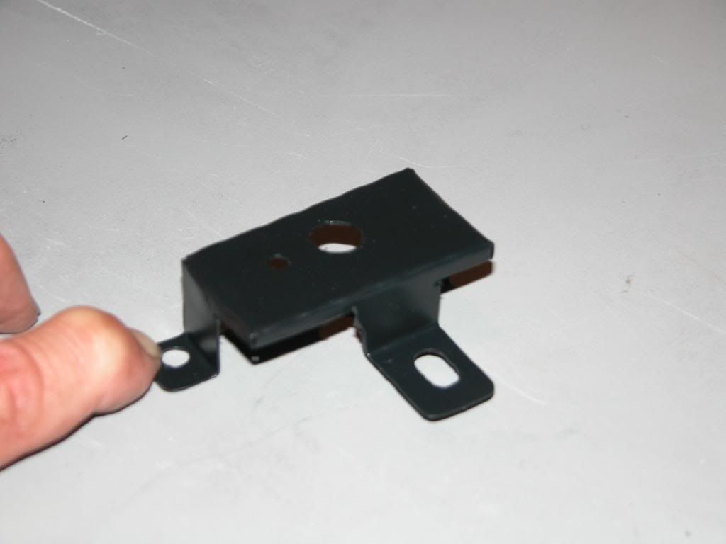

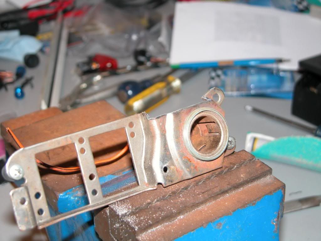

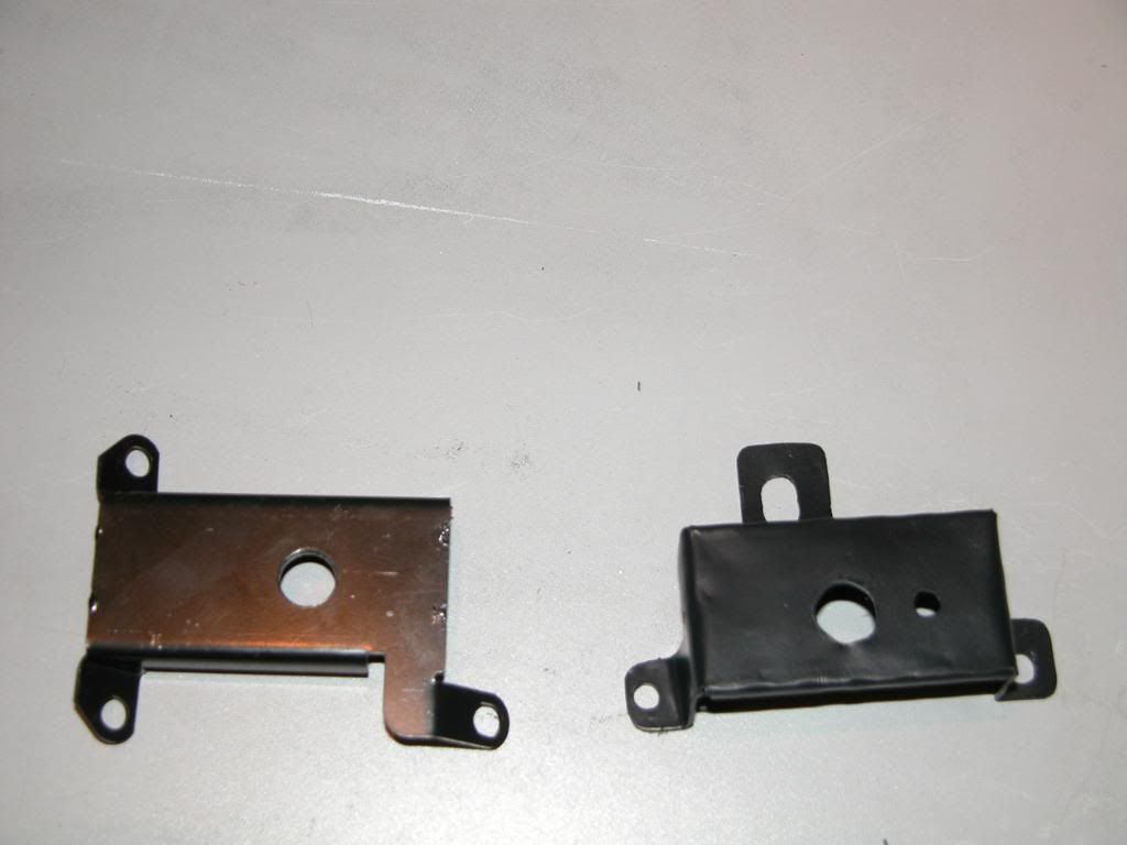

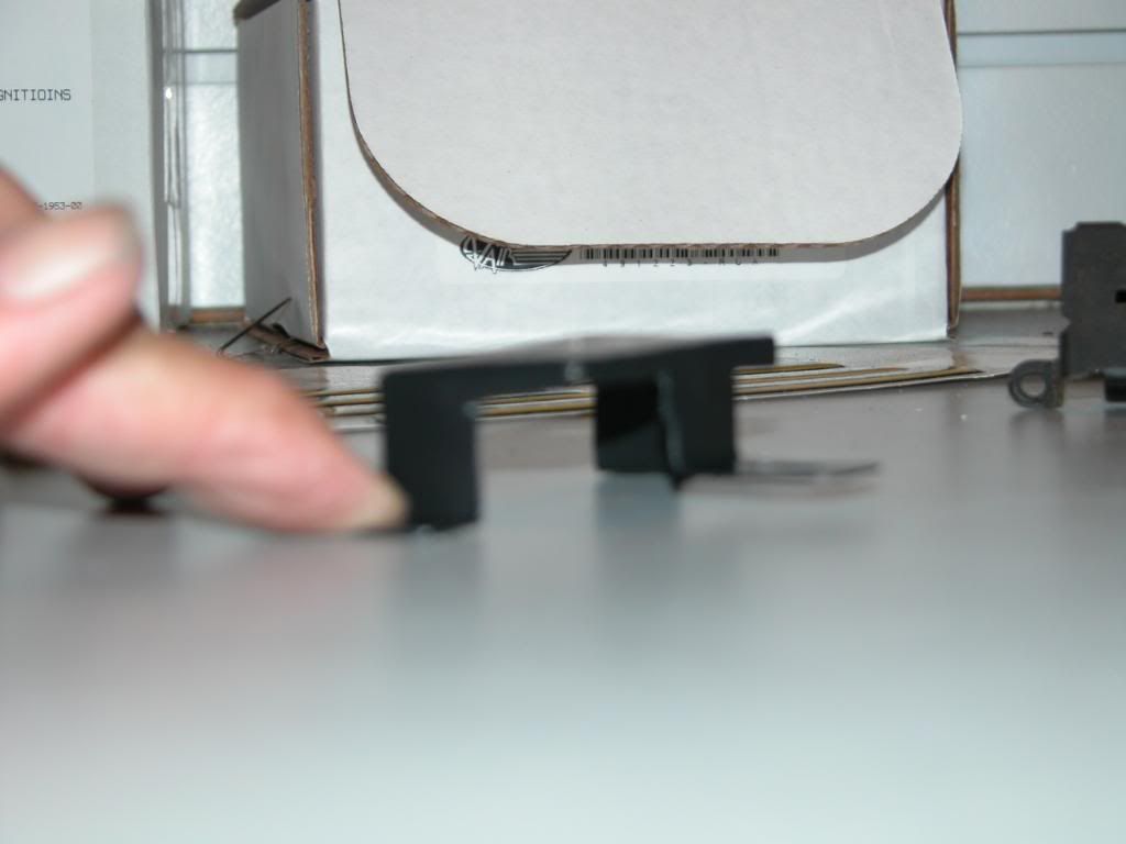

Once you've got the dash clearanced you need to set up the lighter bracket assembly. The bracket itself needs to be modified to provide clearance because it has to move out from the dash to meet the new CF facia. When the bracket moves forward it will contact the bezel so it has to be notched as shown in the pic below.
Next you need to space the lighter bracket out away from the dash panel. The reason for this is because the new cf facia is flat and the original facia was recessed around the lighter. You can do this by getting some 1/8" rubber hose and cutting three 3/8" pieces off of it. Put the little hose sections on the three screws that hold the lighter bracket in position and reinstall the bracket. Do not overtighten or you will crush the pieces of hose.
http://i240.photobucket.com/albums/f...shbuild220.jpg
http://i240.photobucket.com/albums/f...shbuild172.jpg

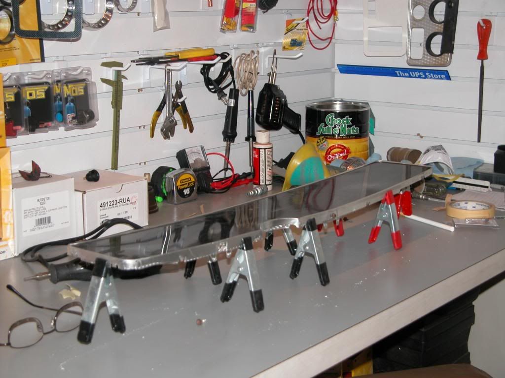

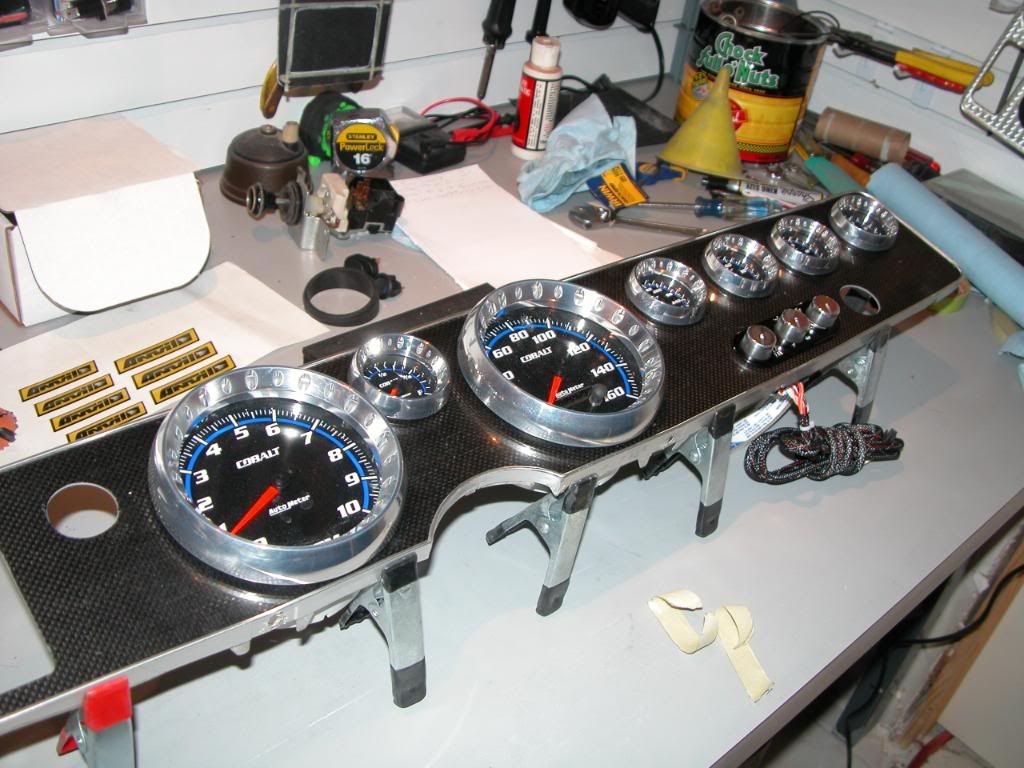

Well you're almost ready to assemble the new panel but first gently clean the bezel with some metal polish and repaint the hood. Use some wax and grease remover on the hood, sand the hood with 400 grit and then spray with SEM trim black. Use a black magic marker to black out the cut edge of the carbon fiber of the lightswitch hole and where the vent opening is. Repaint the trim bezel for the lighter that screws on from the front after the panel is installed into the dash.
Now lay the bezel, CF facia, and modified original facia on the bench and use clamps to hold it into position. Gently bend the tabs over that hold the bezel to the facia. It's important to make sure the three pieces are tight when you fold over the tabs. Take your time, be very carefull, and don't screw up! You only get one chance! Rebending the tabs again will probably break them off. GM only designed them to be assembled one time. If you should break off one of the tabs carefully cut a new tab with a hacksaw blade close to the broken one.
With the tabs folded over stand the facia assembly upright and you'll notice the pop rivet holes where the hood attaches don't line up quite perfectly anymore because of the thickness of the cf facia. Use an awl to widen up the hole in the bezel so the new 1/8" pop rivets will fit. Do not make the holes any wider than necessary to insure the bezel , cf facia, and original facia stay squeezed together tightly. Then place the hood on the facia assembly and pop rivet the pieces together with the 1/8" rivets. I add a couple extra rivets in top areas around the bezel before adding the hood to make sure everything stays tight and you're not counting on the (now weakened) fold over tabs. Be cautious on placement of the extra rivets as they may cause an interference problem.
YOU NOW HAVE A CUSTOM CARBON FIBER DASH PANEL !!!!!
http://i240.photobucket.com/albums/f...shbuild179.jpg
http://i240.photobucket.com/albums/f...shbuild174.jpg
http://i240.photobucket.com/albums/f...shbuild177.jpg

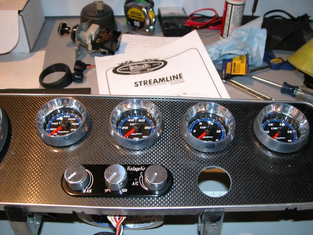

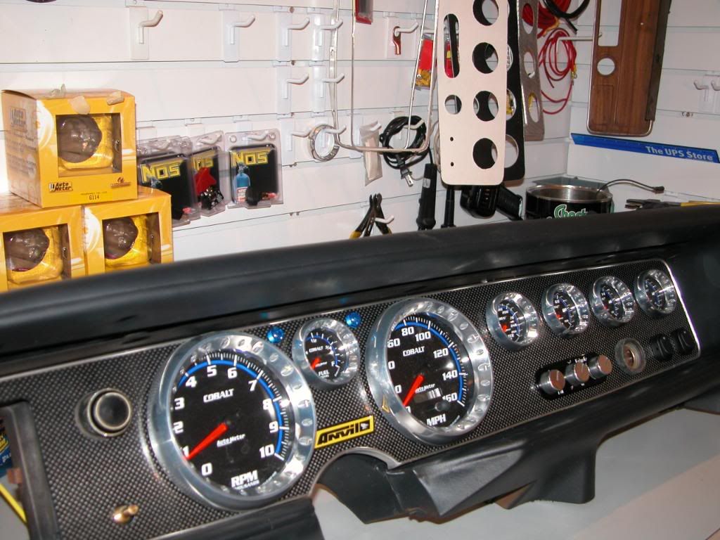

With the new panel assembled it's time for a final mock up of the panel. Install all of the gauges, switches, turn signal indicators etc. If you're lucky enough to have a spare dash to work with like I do, you can mount the switches and Vintage Air controller first, then put the panel into the mock up dash and install the gauges. If not, you can install everything and align the gauges so they are straight. If you are using the Twist Machine bezels you can position them to see how it will look but wait until the panel is installed into the dash for the final time before mounting them with the small removable silicone "dots" they come with that hold them in place.
Stand back and admire your work! Relax a bit before getting ready to install the fully assembled panel into your dash.

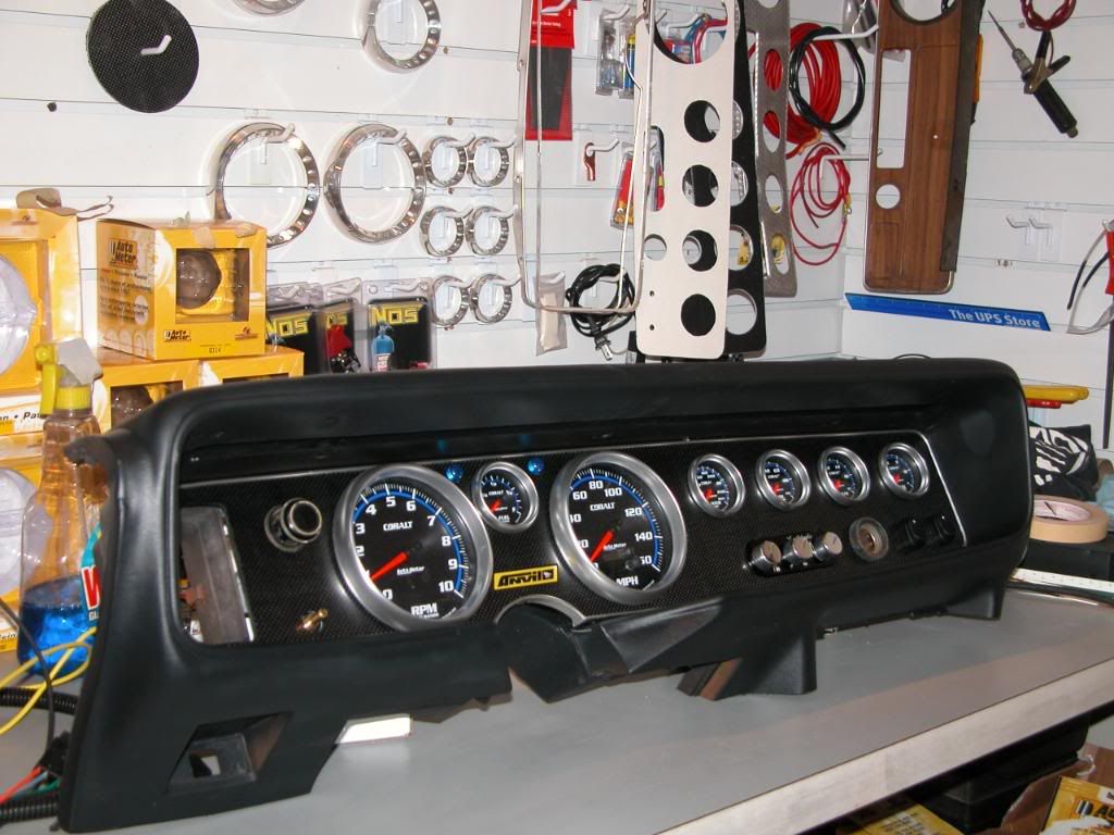

NOT A TA 11-25-2009 05:06 PM

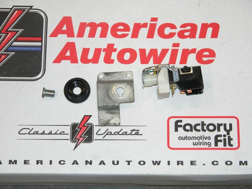

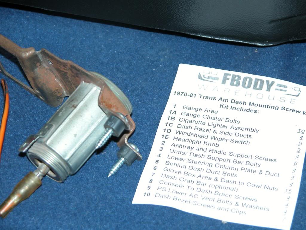

The new light switch from American Autowire needs to be installed into the dash now. You will need to disassemble the original light switch assembly to transfer the bracket and trim bezel over to the new switch. The new switch comes with a nice billet knob and a shaft you can cut to length for your dash. If you'd like to keep an original appearing knob and shaft they can also be used with the American Autowire switch. Once the switch is installed into the dash, plug in the electrical connector. There is very little space between the light switch and the larger aftermarket delay wiper switch after the panel is installed. Also, who wants to lay under the dash trying to do it afterward anyway?
http://i240.photobucket.com/albums/f...shbuild221.jpg

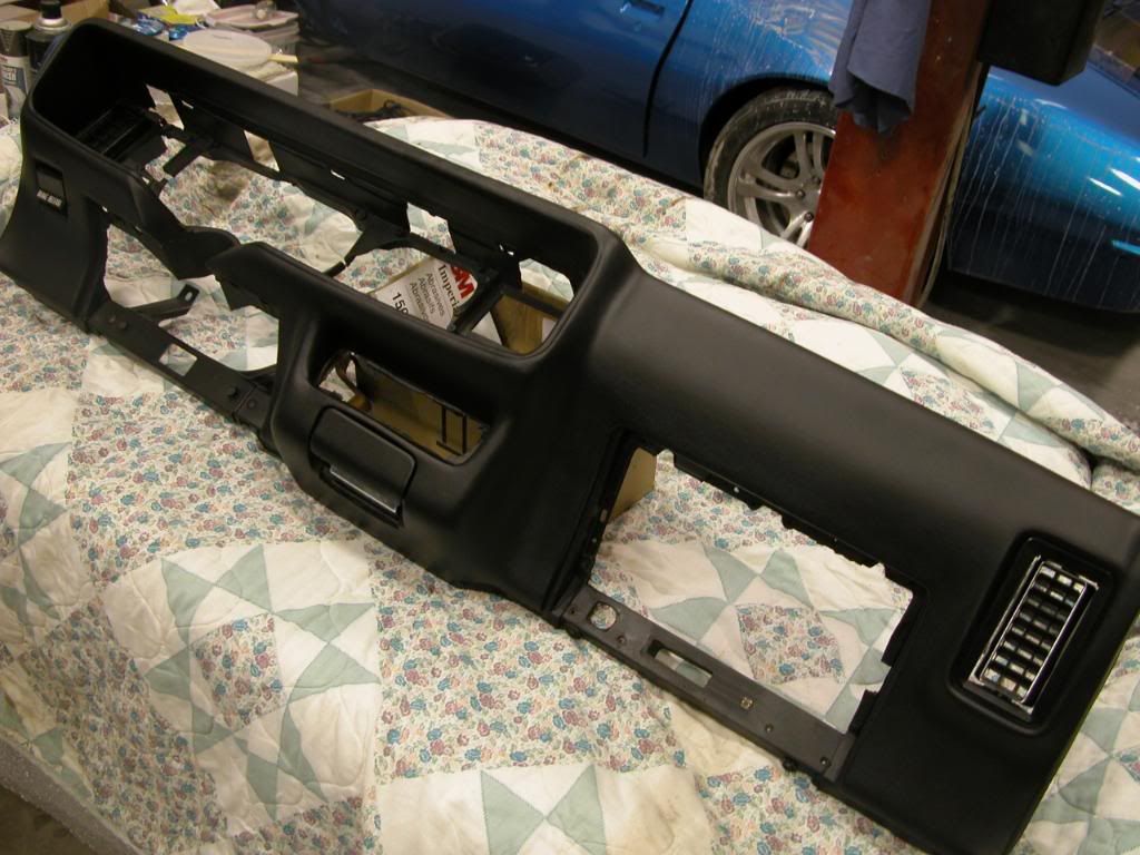

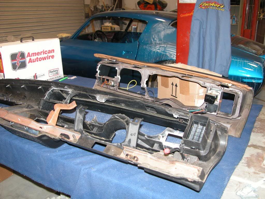

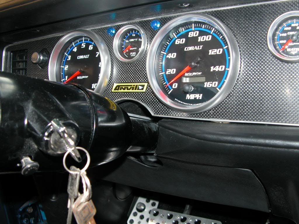

You're now ready to test fit the fully assembled panel into your dash. Because the original panel was installed without gauges and other items sticking out of the back, you must be very gentle and cautious installing the new panel. Wrap some protective sheeting in the area where the panel slides in to prevent scuffing or scratching the vinyl. This is particularly important if installing to redyed dashes. DO NOT USE MASKING TAPE ON THE VINYL OF A REDYED DASH OR YOU MAY PULL THE DYE OFF WHEN REMOVING THE TAPE!
To install the panel tilt it so the bottom goes in first and gently tilt up little before the speedo and tach contact the framework. Then push the panel straight back and the panel should settle into it's original position. In this installation we're installing the panel into a reconditioned dash from Restore A Muscle Car so I clearanced the dash on a work table and will do the final fitting to check everything before we mount the dash in the car. Restore A Musclecar are my kind of guys! They packed the dash very, very well to protect it from damage in shipping. Since we already covered clearancing the dash structure to allow the new panel lets move on!
http://i240.photobucket.com/albums/f...shbuild216.jpg
http://i240.photobucket.com/albums/f...shbuild217.jpg
http://i240.photobucket.com/albums/f...shbuild223.jpg

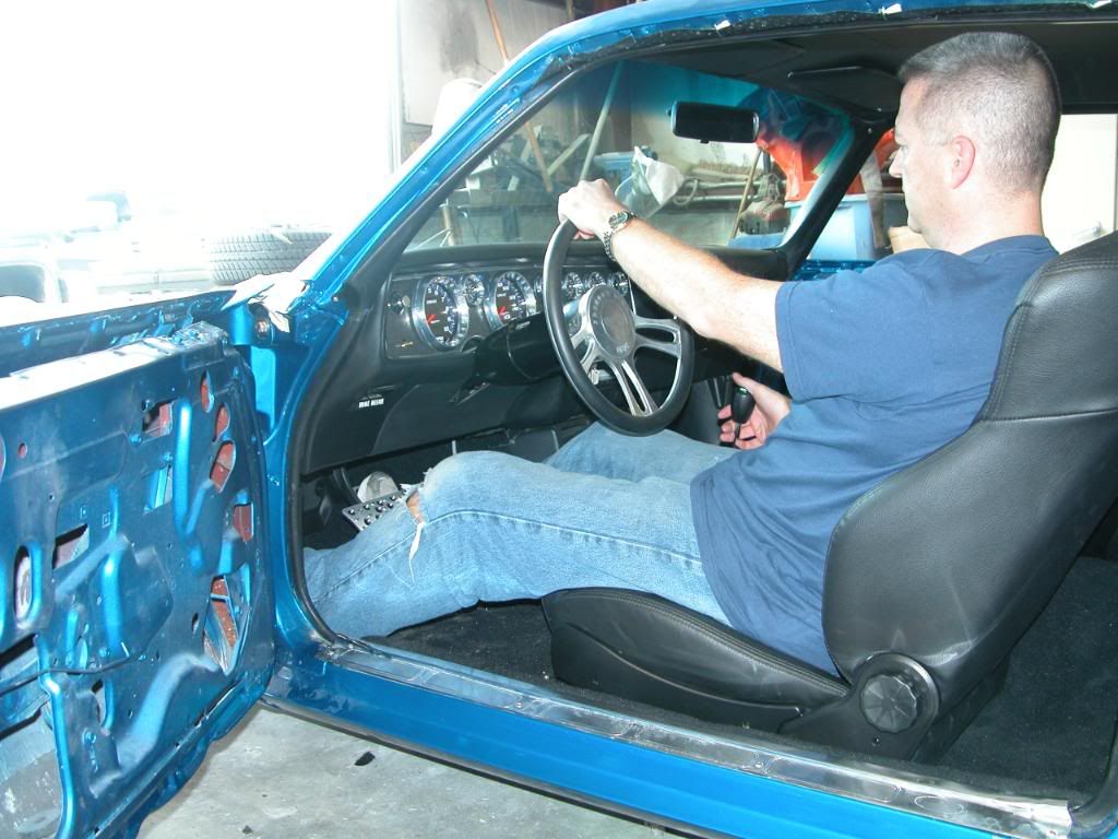

NOT A TA 12-01-2009 05:07 PM
After checking the fit of the panel in the dash from Restore a Musclecar we installed the dash into the car and mounted it into position using a screw kit from Fbodywarehouse.com. Having a complete screw kit with all of the pieces individually bagged and labeled for each part of the dash and related assemblies is great for anyone who has lost any of the original nuts, bolts, screws etc. or for cars where previous owners have replaced the original hardware with whatever they could find laying around. Most of the 2nd gen cars have had portions or all of the dash apart over the last 30-40 years and people lost or broke some of the pieces. The Fbodywarehouse dash screw kit even contains the plastic T bolts that hold the plastic panel under the steering column, AND the inserts that fit into the dash framework that the T bolts insert into!

With the dash installed into the car it's time for the installation of the gauge panel. Each Autometer gauge has a wiring harness with a plug attached to it. Plug each one into the corresponding gauge and then coil up the wires for each gauge separately and install one of the labeling stickers provided with each gauge which names what gauge those wires are for. This way later on, when you're upside down under the dash trying to wire everything you don't have a big mess of wires to sort through trying to figure out which wires go to which gauges.
When installing the panel use some protective sheeting only on the ends of the panel where it is most likely to scratch the vinyl. If you use the sheeting all around you won't be able to see where the screw holes line up and it will be very difficult to remove the sheeting on the top and bottom with the panel fully into position.
Install the panel into the dash remembering to tilt the bottom in first, straighten it up, then push straight back. Once the panel is in position pull out the protective sheeting and then loosely install the three screws in the hood where it screws into the dash, then the two hidden screws that come up from the bottom of the dash. You can then loosely install the lighter trim ring, center up the panel where you like it, and snug up all of the screws. DO NOT OVERTIGHTEN!
If you are using a replacement screw kit the two long hidden screws that come up from the bottom may be Torx head screws. If they are Torx heads then tape a note to the back of the plastic panel under the steering column saying that they are Torx heads otherwise someone in the future will be going nuts trying to figure out why a phillips won't work up in there because its so dark they won't be able to see the heads. It might be you when you're old and senile and can't remember or a future owner but someone will be in there eventually. At this point in time we're just caretakers of these cars and the cars will probably be around after we're gone.

The Twist Machine bezels can now be installed on the gauges. It is a very simple, reversible operation.
The bezels are held in place by small silicone dots which are supplied with the bezels. Simply place a few dots around each ring and press the bezels into position. If you ever want them off you can just pull them back off with no damage to the bezel or gauge.
Once the bezels are installed it's time to sit back and enjoy your new dash panel. One hand on the wheel, making engine noises, and banging through the gears with the shifter is optional!

70rs 12-01-2009 05:40 PM
Thank you John for a great thread with a ton of very usefull information. It will be a big help to me in the next year.
I am curious about the silicone dots from Twist Machine that hold the rings on. Do you have any pictures of these or how they work?
NOT A TA 12-02-2009 05:30 PM
Glad you can use the thread! The silicone dots are clear, slightly bigger than the head of a pin, and come on white wax paper. I couldn't get them to show up in photos.
70rs 12-03-2009 09:48 AM
I think I understand. Just a "friction fit" with the dots and the rings?
NOT A TA 12-03-2009 05:40 PM
Yes, the Twist Machine bezels are hollowed out to fit right over the stock bezels and the silicone dots are all thats needed to hold them in place because it's kind of like an interference fit and the dots flatten out holding the bezels. The bezels can be easily removed just by pulling them off and leaves no marks on the Autometer bezels.
70rs 12-03-2009 05:53 PM
Thanks John. I am interested to see how well they stay on with normal use of the car. I really like the way they look and would like to have a set in black as we discussed.
But I am a little concerned about them "falling" off without some sort of mechanical fastener to hold them.
What are your thoughts on this? Do you think with heat, vibration and normal use they will stay put?
Steve Chryssos 12-04-2009 07:51 AM
John,
Awesome thread. So much good information. As for the glue dots, we concerned about how well they would stand up to vibration, shock and heat. So we tested them in the worst possible scenario: A 42 Foot race boat with two dozen gauges. It was pounding in and out of the water and baking in the sun. The "Dots" did not fail. No one bezel came loose or fell off. They are amazing. Pressure activated semi-hardened silicone.
If you still have doubts, you can always attach them with clear liquid silicone. But then the bezels will never come off-unless you use gasoline or some other solvent.
Thanks for the interest
/Steve
70rs 12-04-2009 03:06 PM
Originally Posted by streetfytr68 (Post 252422)
John,
/Steve
Thanks for the reply Steve. I would think your test method proves the dots work. The marine environment is pretty harsh and under race conditions it's only worse. If a part is going to fail it is there.:cheers:
