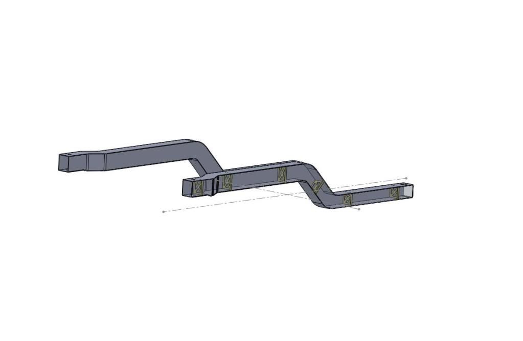

Sub-Frame
Albert we have been working hard on getting these frame rails done for Warpath!! JME Enterprises will be paying us a visit in the next couple of weeks so that we can get his Pro Series suspension between the second gen frame rails.. I figured I would tease you with some of the results we have so far :cheers:
http://i1015.photobucket.com/albums/...Assembly-1.jpg

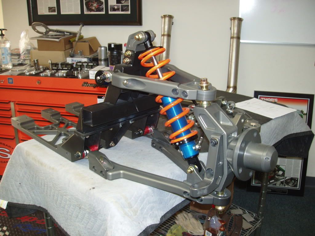

JME Enterprises suspension
Julio from JME Enterprises stopped by the shop today & dropped off a corner of his front suspension so that we can get this fitted in the second gen frame rails we are designing.. This is a real trick looking front suspension!! Lots of billet machined pcs. :D
http://i1015.photobucket.com/albums/...n/P3100057.jpg

tones2SS 03-11-2010 08:25 AM
WOW!!! Very cool. Maybe a stupid question,...is it getting welded or bolted in?! THANKS!!:thumbsup:
Cris@JCG 03-11-2010 07:57 PM
Steel fabricated brackets will be threaded that weld on the frame rails & that will bolt the billet machined pcs in place..

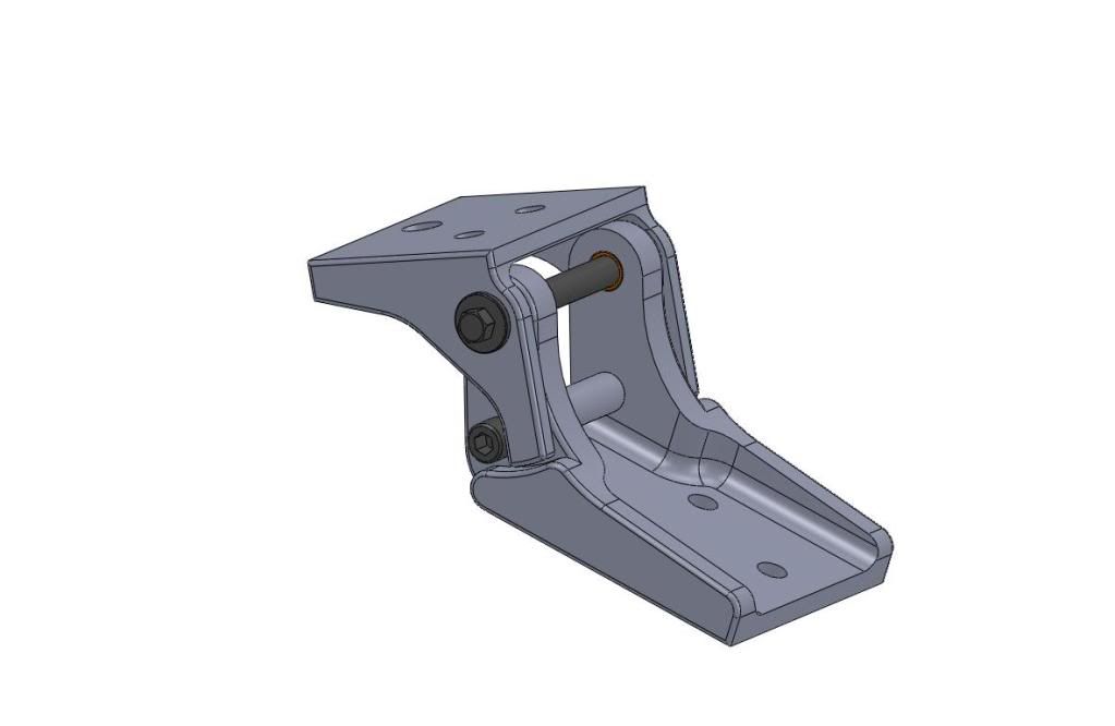

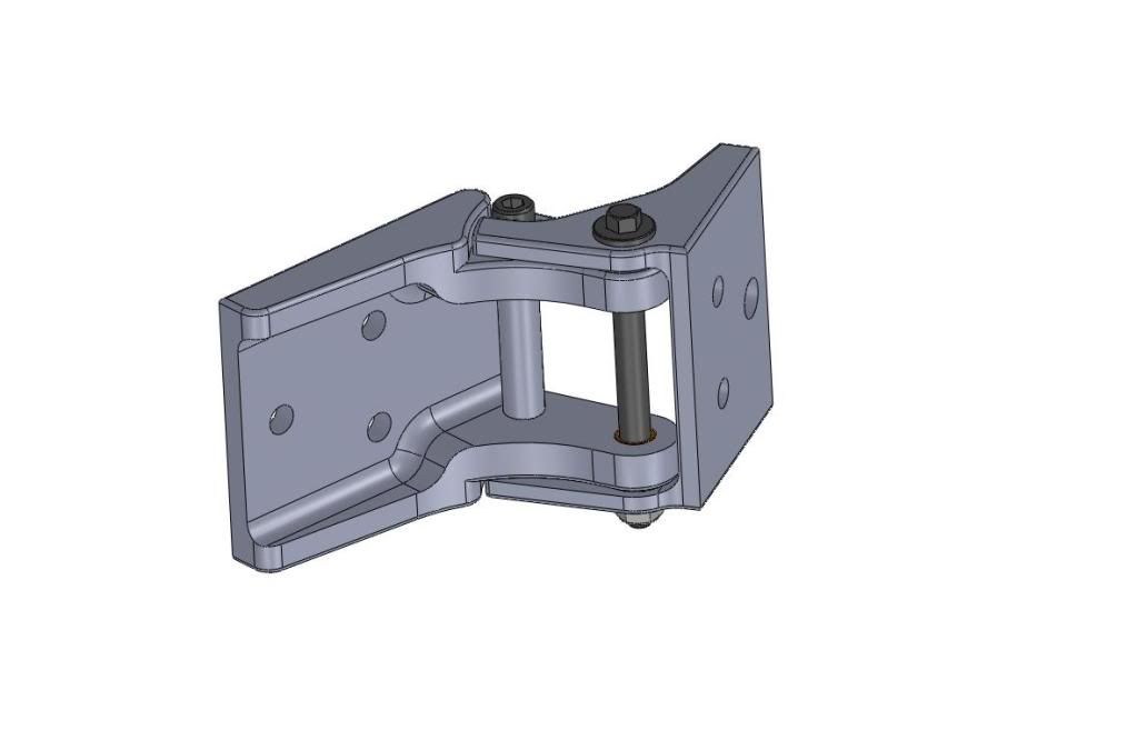

Billet door hinges!
We all know that second gen's have some pretty damm heavy doors & creates door sage which cause pins to wear out.. Well.. We decided to doo some billet door hinges for second gen's with some improvements!! We are elimnating the factory detent system on the hinge & upgrading to late model chevy truck system detents that mount on the door jams.. Stainless pins with oil impregnated bronze bushings a bit stronger than the factory one's
http://i1015.photobucket.com/albums/...embly-2JPG.jpg
http://i1015.photobucket.com/albums/...geAssembly.jpg

Cris@JCG 06-09-2010 07:00 PM
We will be offering them for sale once prototype is proofed..
