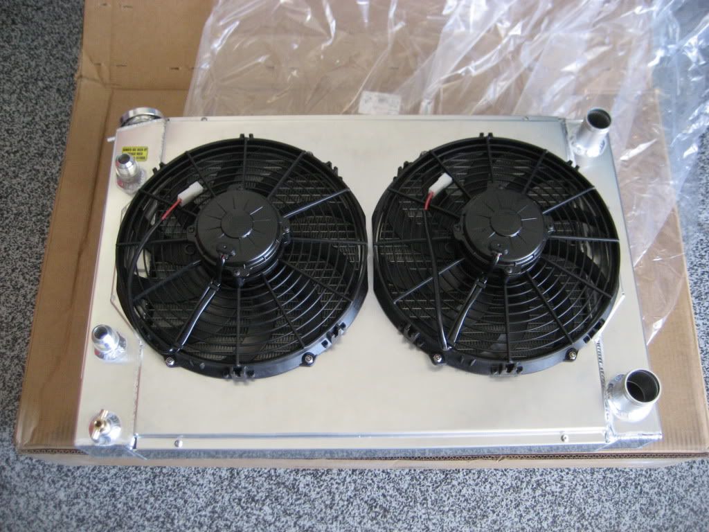

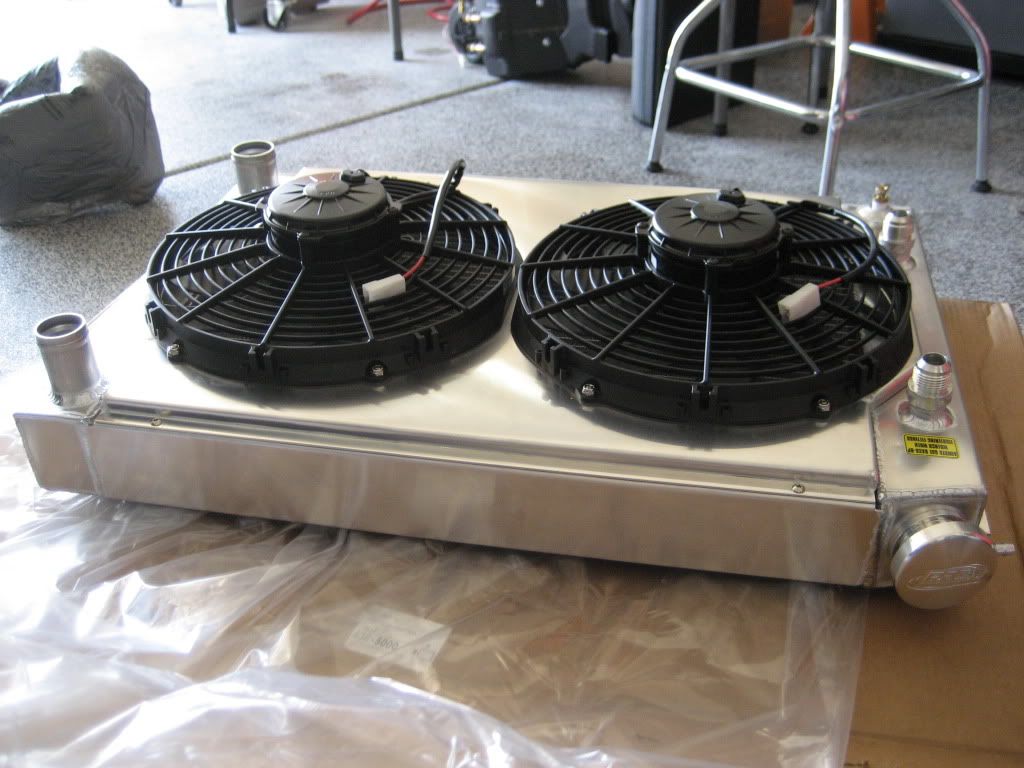

I spent a bunch of time talking to companies about radiators. Mainly Ron Davis, CSR, and Fluidyne. They all recommended the heat exchanger. Then I figured out Frank @ Prodigy Customs had the perfect package for me. I was able to get the dual pass, 12 plate/12AN heat exchanger, dual 12's, in a pretty package. Oh yeah, the price is way less than Ron Davis. I just got it today. Look awesome, I'll be sure to let you guys know how it works soon. First impression if very favorable.
http://i200.photobucket.com/albums/a...adiator012.jpg
http://i200.photobucket.com/albums/a...adiator013.jpg
I really like the autorad setup. It would cause me some packaging issues with puke tanks, catch cans, power steering tanks. If I was in the fabrication stage then that would of been a serious consideration.

Now all you need is the SPAL PWM fan controller.... it kicks on fan #1 at half speed -- and ramps up the speed as temps climb - then when #1 is full and temps keep going - Fan #2 comes on full blast... Hook your A/C trinary into it and it waits until head pressure is reached and kicks BOTH fans on full - and continues to run them for 30 seconds AFTER you kill the A/C to cools things down...
I just bought another one off AMAZON for $124
With this controller you only need ONE fan relay - for fan #2
Small package easilly hidden and all weatherpack connectors...
Vegas69 02-12-2010 01:43 PM
It's already wired with two relays and the trinary circuit is already soldered in. I'll just stick with it.

Todd, what are the -12 in/outlets for? Trans cooler err you have a manual so...oil cooler? PS cooler?

I really like that Todd. I'm starting to look for ideas for my second gen track car. I need to get ahold of Frank................ :thumbsup:

It's an engine oil cooler. I'll plumb it from the oil pump to the cooler than through the oil filter and through the engine. I'll have a seperate port for the accumulator. The coolant t stat will control the oil temperature. While this may be marginal for all out road racing, I don't plan to run anything but 15-30 minute heats with this car. I'll have 13qts of oil, dual pass, and aluminum block. If I get that damn serious about road racing, I need to build a new car. This should do just fine for what I intend with the space I have.
