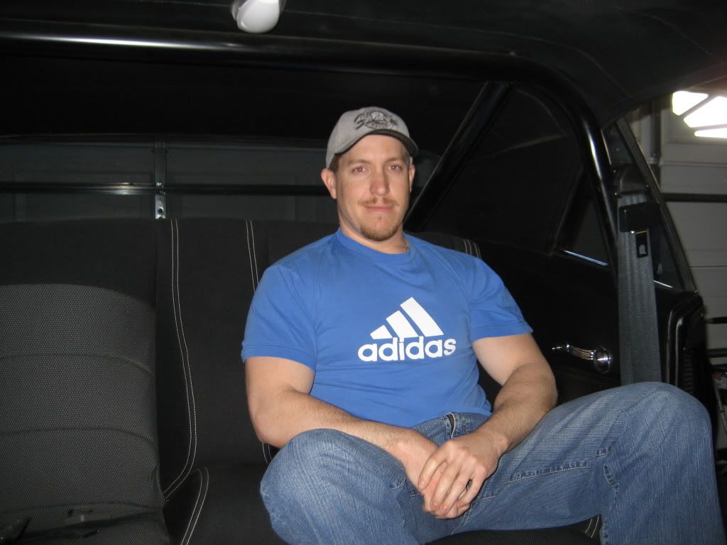

Alright guys, this is the best looking model I could find. :rofl: I'm 5"9 and my hat is rubbing the ceiling. The roll bar is within 4-6 inches of my ear.
http://i200.photobucket.com/albums/a...RollBar002.jpg
Wow...if the car went sideways...got hit - turned over (in normal city driving) - that would HURT!

Todd thanks for the picture, there is noway thats going to fly with people in the back seat. I guess you go to a 2 seater or you forget the roll bar.

LOL it todds car you dont even have to be moving for it to be unsafe to sit in his back seat!!! yeah unless it a youngin strapped into a car seat theres really just not enough room for it to be safe, even if the rear down bars out and up as close to the roof/pillars it still wouldn't be safe.
