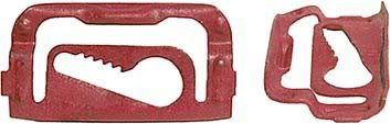

Rod P 04-06-2010 10:07 PM
Just replace the window clips with a better tensioned ones, the spring steel gets weak after being pulled to remove the trim, (even after one removal) and good camaro shop will have them, and you want this style where the pin mounting slot has adjustment teeth
http://i752.photobucket.com/albums/x...shots/AMK8.jpg
I linked to one shop but call you're favorite shop :thumbsup:
