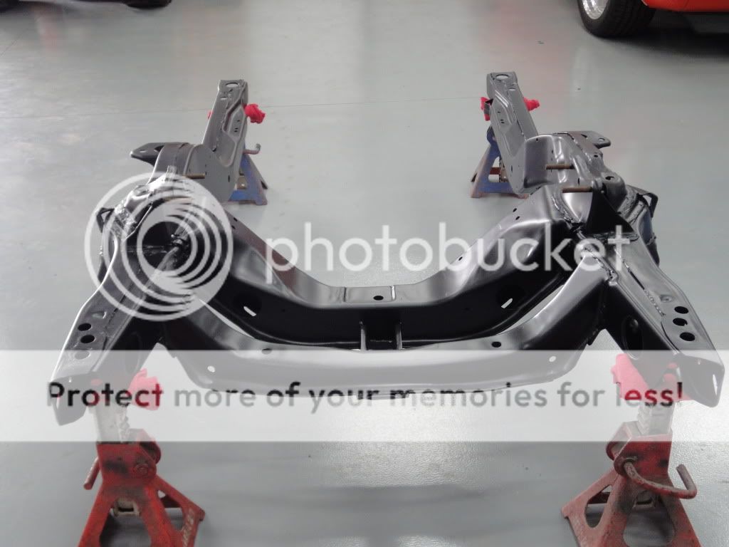

Jay Hilliard 04-08-2010 11:03 AM
I got my subframe and lca's back today. I think the powdercoating turned out well. I hope to get the car shell to the media blaster within the next couple of weeks max.
http://i416.photobucket.com/albums/p...t/DSC00440.jpg
tones2SS 04-08-2010 12:15 PM
Looks good Jay. Keep us posted.:thumbsup:

waynieZ 04-08-2010 06:03 PM
The sub frame looks good.

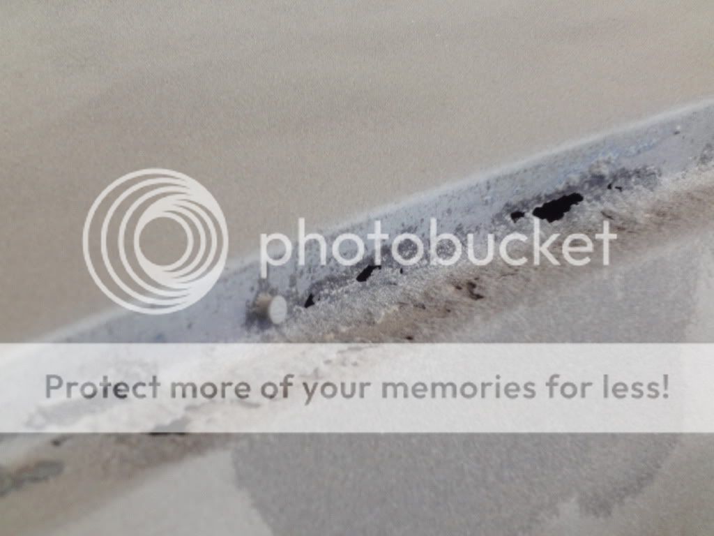

Jay Hilliard 05-09-2010 01:44 PM
Car turned out well. Not alot of surprises. Rear quarters will need to be replaced (was hoping I could save them) along with outer wheelhouse's (inners are fine). There are a few pin holes in trunk and rear passenger pan, but nothing that cant be welded up.
Also sail panel will need some repair where glass lays but I dont think it requires replacement. Front pass floorpan will need to be replaced between toe pan and just in front of seat riser.

Sail pan lip

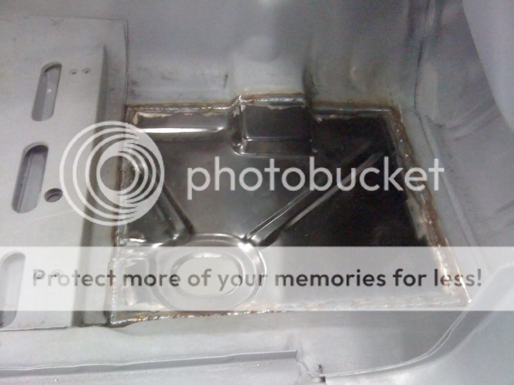

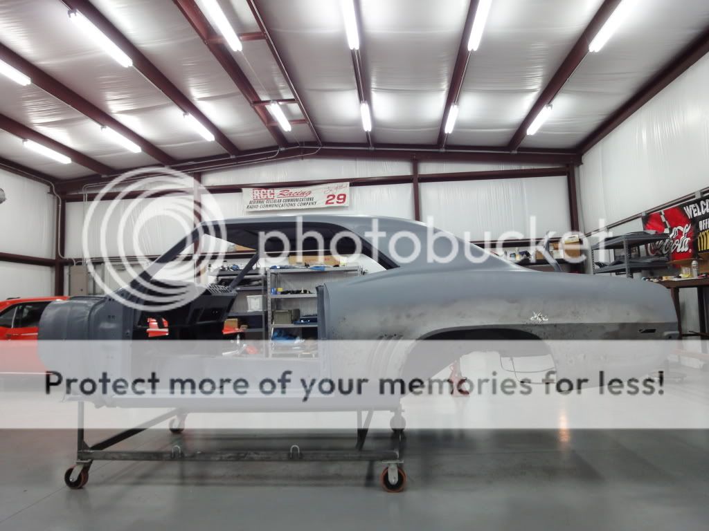

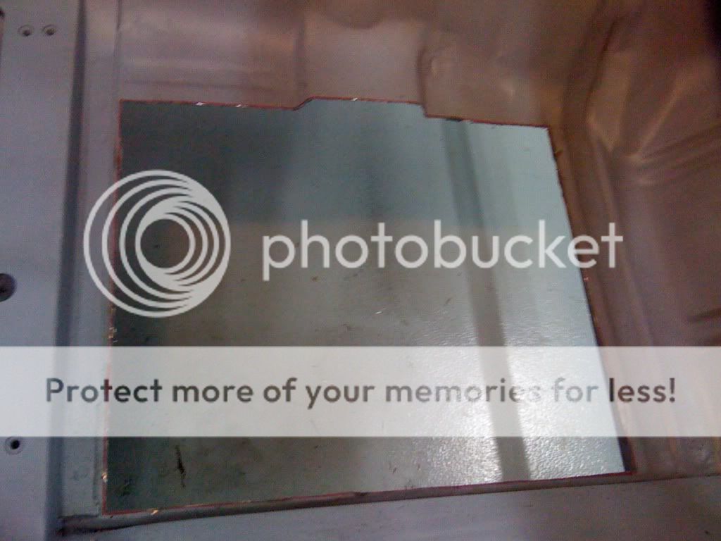

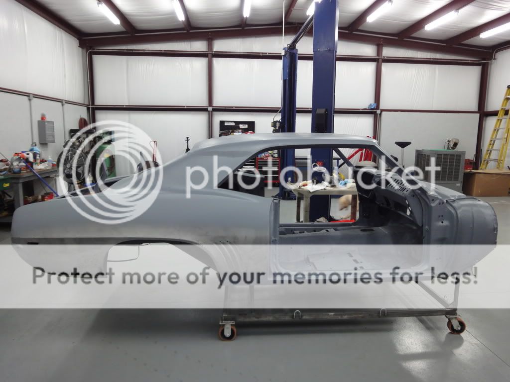

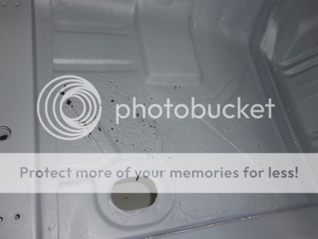

Jay Hilliard 06-18-2010 03:18 PM
I haven't had a chance to update lately, but I have worked on it some. The pin holes in trunk and a few in rear floor have been welded & smoothed. I cut out part of the front passenger floorpan and butt welded the new peice in. I thought it turned out very nice. I just have to grind the weld down now.
http://i416.photobucket.com/albums/p...t/IMG_0189.jpg
http://i416.photobucket.com/albums/p...t/IMG_0194.jpg

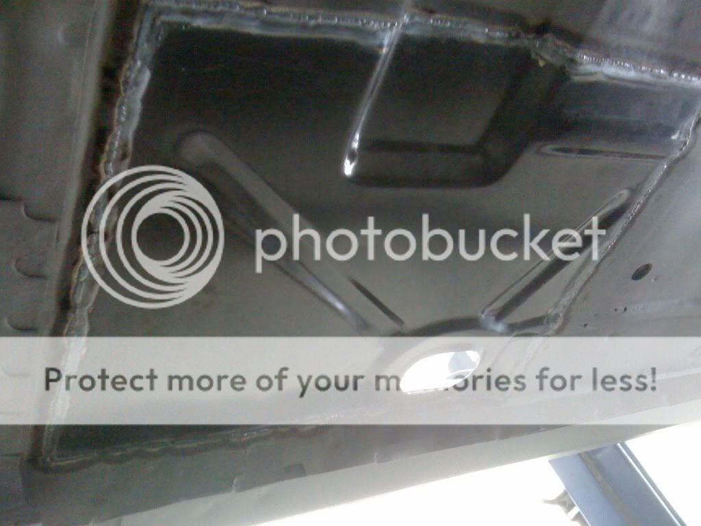

Underneath car:
http://i416.photobucket.com/albums/p...t/IMG_0195.jpg
