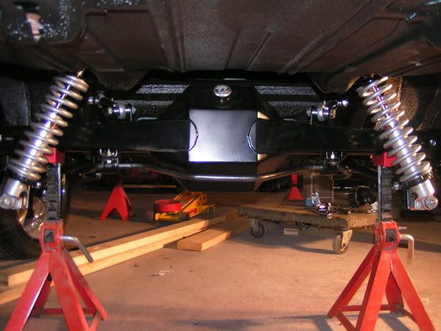

I went with the Moser 12 bolt with 33 spline axles. Here's pictures after we welded the brackets on. it has since been painted.

That looks sweet Chris, same is what I'm going with. What width did you go with what are your wheel specs?

Oh, but as far as the watts link and a 12 bolt go. Ummm, yes, they can live together. Here is mine that will work with a 12 bolt. Its on a ford 9". But I can make it work with the 12 bolt just the same. :) JR
http://img.photobucket.com/albums/v3...l%20pics/c.jpg
