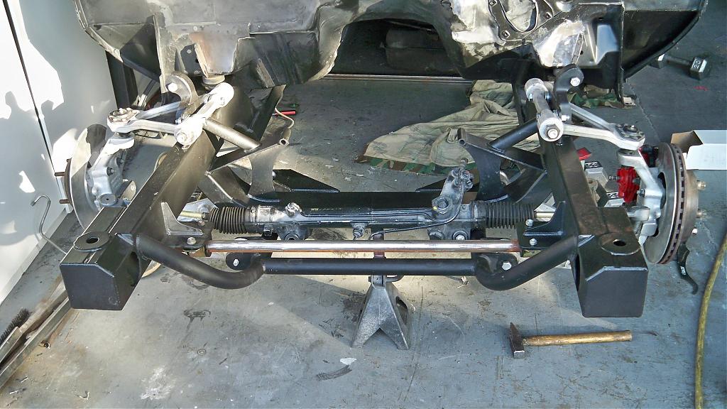

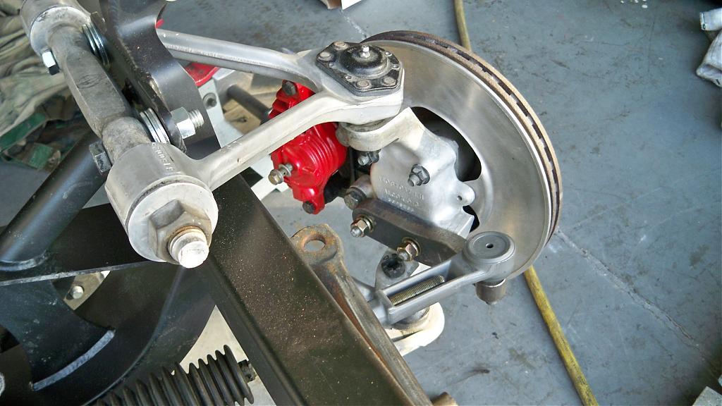

clay69camaro 05-14-2010 07:02 PM
3 Attachment(s)
Not sure on what kind of angles will help the best but here are a few pics.
Nothing is bolted in real tight, it's all just mocked up right now. I have to find the directions again but I think all the fabrication to make everything work has been done already.
If more fab is needed that will be to address the bump steer issues.Attachment 24837
Attachment 24839
Attachment 24838

Probably a stupid question, but are you sure you don't have those steering arms on upside down? It looks to me like they might be and that the tie rods should be connected to the arms from the bottom. I'm far from an expert so maybe someone else who knows better will take a look.
It might help if you post a picture with the control arms set at ride height instead of full drop. The second picture that you posted is the one that just looks a little wrong to me.
Don

My tie rods mount to the bottom of the steering arms. Our C4 subs are a bit different, so I cant say for sure yours is wrong. Scott
Vince@Meanstreets 05-15-2010 08:21 PM
I think Don might be right. The rack tie rod shaft should be pretty close the the angle of the lower control arm.
https://lateral-g.net/forums/atta...9&d=1273888916
Might have the sides swapped. If I remember right the steering arms do have a slight bend to them.
Vince

the tie rods do go below the steering arm.
clay69camaro 05-16-2010 11:44 PM
haha I kinda just slapped it all together for a picture. But yeah the steering arms are on wrong and the tie rods too. Nothing is even more than hand tight though.... Nice observation .
I've got to look for my directions that came with the sub-frame. I put all my camaro stuff in storage a few months back, so now I've got to track them down :willy:
We'll see how things play out. I'd like to know what Mark says as well. I'm not looking to break any world records, just set some personal ones and break them by improving my driving.
