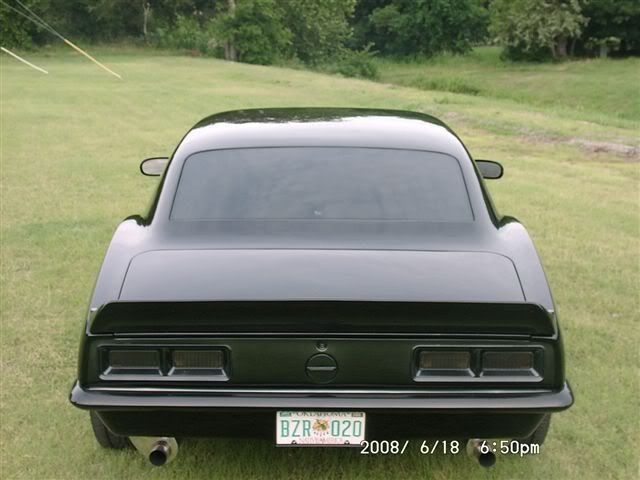

BritishGreen68 07-14-2010 03:43 PM
i think it would look better with no seal if you can pull it off... alot of OEM cars these days dont have a seal..
http://i290.photobucket.com/albums/l...ns/photo43.jpg
here is some more info..
http://v8tvshow.com/component/option...opic,2383.255/
prostreet69cama 07-14-2010 06:24 PM
Yes I agree with you 100%. After doing the red 69 above I would do it different. It looks alot better like that. But we bought the glass as a 2nd thought. I would build the car body around the glass.
Is that factory glass or oversize glass?
