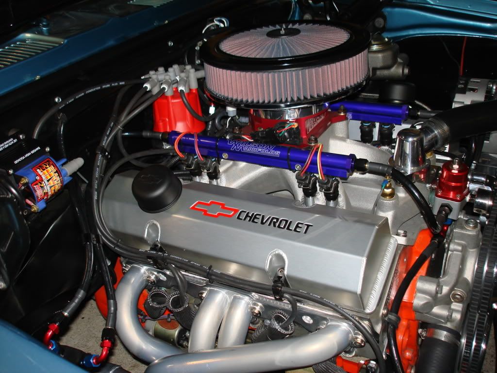

67ragtp 07-19-2010 06:31 PM
Here's some insulating boots I use, they aint the best looking pieces, but they work :thumbsup: - Rich
http://i168.photobucket.com/albums/u...Picture136.jpg
