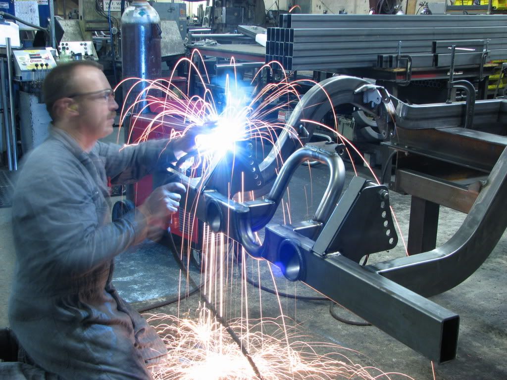

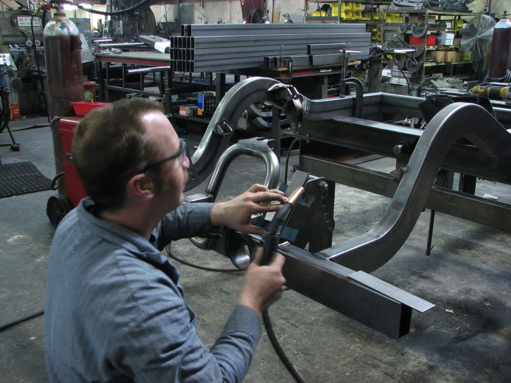

The Custom Art Morrison 5 link rear suspension. This is the second one built my good buddy Frank at Prodigy Customs did the design and work with Art Morrison to make this a reality. He is installing the #1 unit into his 69 Camaro Project "Unfair". This will be the first one to be built for a 2nd gen F-body.
Couple of answers to questions I know will come up
-Removal of certain bars allows for different setups for road racing and drag racing
-That right there is a true no compromise road race 3 link set up when the upper outer bars are removed. That is also a true no compromise Drag Race 4 link (just like a Pro Stocker) when the upper center bar is removed! Quite honestly this is one of those things that is right in front of you no one saw it!
-A car with the ability to quickly (few hours) transform from a great autocross / road race car to a great drag car by moving some stuff around and swapping some easy to change Components (Read more later). The idea was for a suspension system with massive adjust ability.
-Does the car have to be Back halfed?- yes it does, you must remove rear rails, floors, etc. All will have to be fabricated once rear clip is installed. The first gen piece will not be back half job, only require removing rear frame rails and re welding new rail that are formed to fit factory floor.
-How big a tire can this handle? More then a notched factory frame as long as you do not use pre packaged tubs. The outer frame rails are 1" more narrow then the narrowest possible frame width with thinnest factory frame rail notch one can do. And what is so cool is you not only keep a full rail where you normally notch, but you have a stronger rail also. Our drag tires will be 345 / 35 / 18 Drag Radials with a section around 14.5"! So we will be making bigger mini tubs
There are pictures of the unit going in Prodigy Customs project Unfair. Our piece is still in production at Morrison
