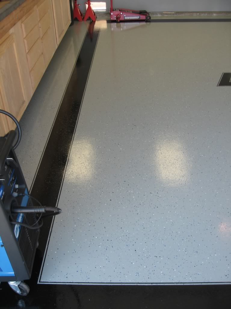

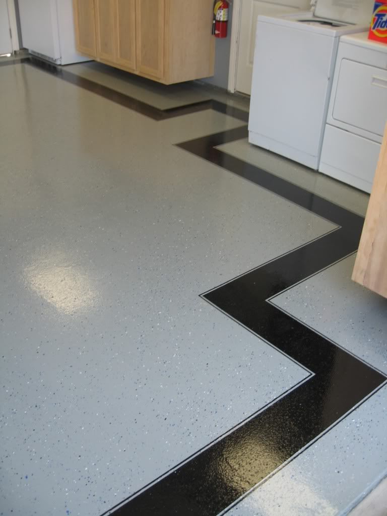

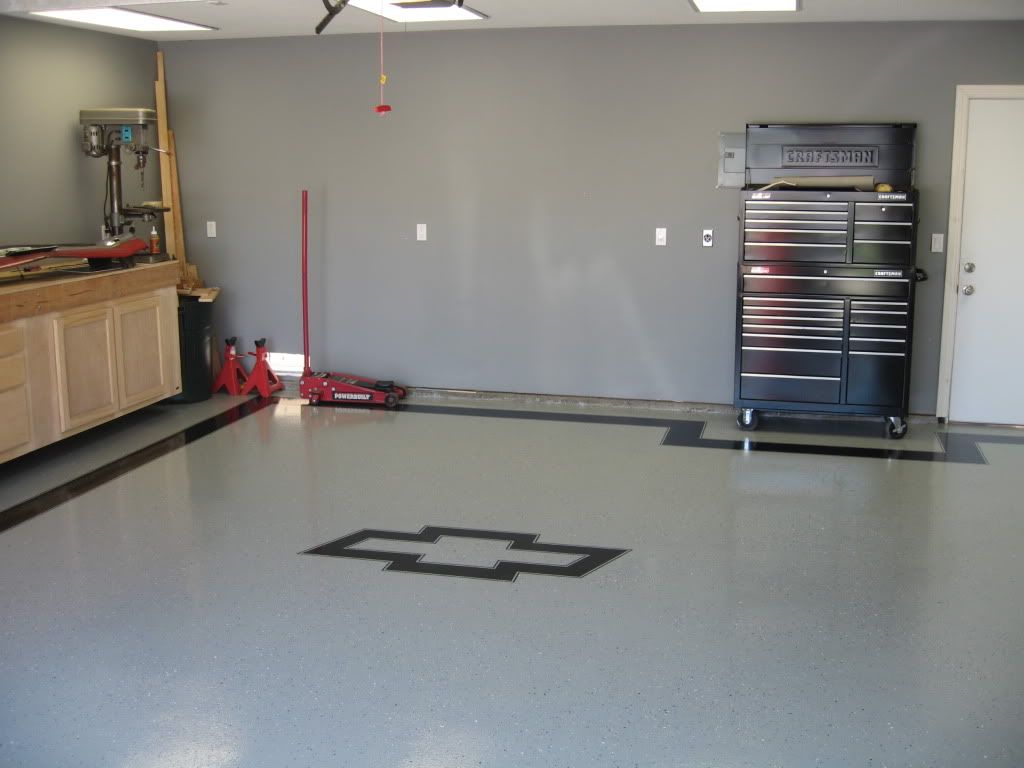

Here's what I did with great results
This kit was purchased at Home Depot for $99.00. It is the Rust-Oleum EpoxyShield 2 1/2 Car Garage kit. The prep is THE most important part of this project so don't rush it or cheat. I also purchased an extra gallon of Behr Concrete & Masonry Cleaner/Echer No. 991 for the real dirty side of the garage.
Here's the kit
http://i145.photobucket.com/albums/r...neous002-1.jpg
It's very simple...you take the package of the Citrus Cleaner/Etcher, dissolve it in a bucket with 2 gallons of water and pour some out on the floor...working in a small 6x6 area with a scrub brush attached to a broom handle...scrub the area well, especially if it is real oily/greasy. Try not to let the cleaner dry..so work quickly...use a hose and rinse really well. Take a push broom or squeegee and get rid of all the extra water. If possible let dry overnight for best results. Then you are ready to paint.
http://i145.photobucket.com/albums/r...laneous003.jpg
So you can see the results and how crappy my floor was, here's Before Cleaning:
http://i145.photobucket.com/albums/r...neous001-1.jpg
This side of garage was VERY nasty, so I used the Behr Cleaner/Etcher even after using the citrus cleaner/etcher that came with the kit. I used it FULL strength...BE CAREFUL!! You can see the really white area, that's where I used the Behr product, it's VERY STRONG!! here is floor After Cleaning:
http://i145.photobucket.com/albums/r...laneous006.jpg
Start painting...again working in areas small enough that you can cast the decorative flakes out, onto the wet paint....or don't use them at all. Here is the finished floor.
http://i145.photobucket.com/albums/r...laneous007.jpg
http://i145.photobucket.com/albums/r...laneous008.jpg
I did this project in 2 consecutive weeks, as I had nowhere else to put my Camaro. I used the expansion crack down the center of the floor as the dividing line between the 2 paint sessions.

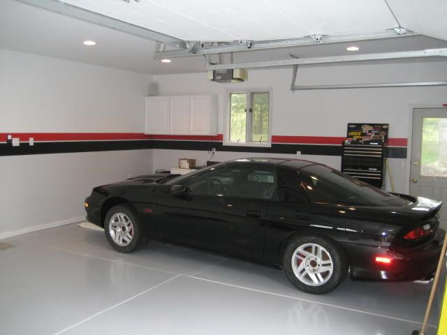

Here is the first side in the sunlight:
http://i145.photobucket.com/albums/r...laneous001.jpg
http://i145.photobucket.com/albums/r...laneous002.jpg
originally did this in August '08 (two Chicago winters) and to date, no lifting, peeling or any other bad results!!

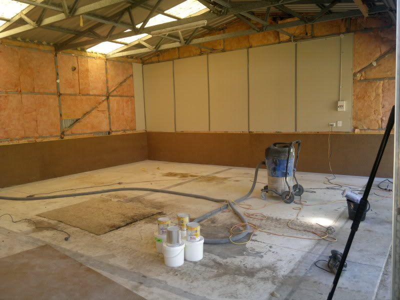

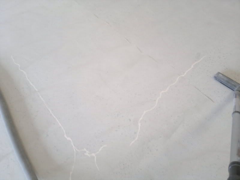

Ozzyvet 11-08-2012 08:56 PM
I had my floor done with a poly-urethane epoxy. Not quite as strong as a poly-aspartic, but almost 1/10th the cost. There is a clear coating over it to protect the colour coat and when that gets scratched up, I can buzz it with the sander and place another clear coat over the top.
It's only a few months old so is still hardening. The dragging the trolly jack around has put a few scratches int eh clear. I have the stang up on stands at the moment so it'll be interesting to see if that leaves any marks. I have been driging on it since about 2 weeks after it was done.
My mate has a concrete grinding/coating business and wanted to try some stuff, so volunteered my shed. The price was right ;)
I still haven't moved all my stuff over from my old man's shed, so it hasn't been subjected to welding and grinding just yet so I'll be keen to see how it stands up.
