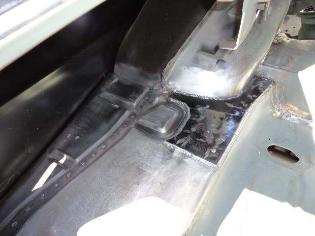

been on site for a bit now figure I would post some pics of my current projet.
its a 69 camaro x11 hugger orange 124vin
got it back from media blasting
lost the before pictures but this where i'm at
Im running DSE quadralink and minitubs w theyre 9" ford rear end moser axles ,wildwwood brakes 3.50 gear ratio. I also have DSE frame connectors and soild bushings not on, yet.
replaced pretty much everything on rear except trunk floor and structure
I will be running an LS6 with magna charger and t56 setup that came from a wrecked 2005 ctsv w 25k miles.
Im going pretty much custom everything as much as possible without sacrafficing the integrity of the original car.
this is my second build and first to this degree. my first is the red 64 which I have a bunch of pics on car domain. you could google frank's 64 chevelle in south gate if care to see pics of that
I had to do some adjust to minitubs after the fact , I didn't have tires when I put them in. I still have some minor adjustments on the rear but its coming together.
im plannig on doing all except for body and paint which im thinking some type of charcoal gray w black interior possible gto seats like 64 but with red baseball stitching.
ohhwell getting ahead ofmy self.

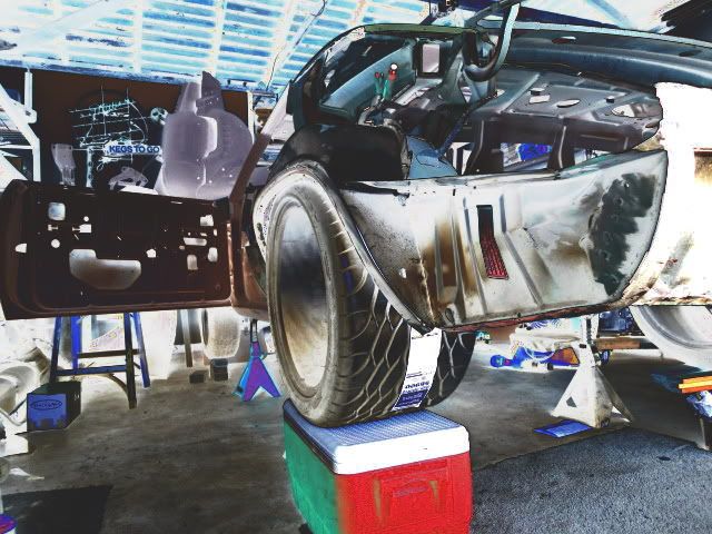

9 Attachment(s)
quick update little time to work on it lately but I got rear end on it just for mock up, and to verify the offset for the wheels , those on the picture belong to bmw. question for anybody in the know how dep... for the minitub how much space do I need between the inner wheel lip and the body, i'm thinking 3/4" clearance, and also how much rear end suspension travel should I expect on some hard cornering.
i'm calculating that with 5.625 back space on a 18x12 wheel will put me at 3/4" clearance on both sides considering an overall width of wheel with mounted tire to be 13.250" (would help if I had one to measure) so its just an estimate.
I will most likely do a 6" back space just to be safe.

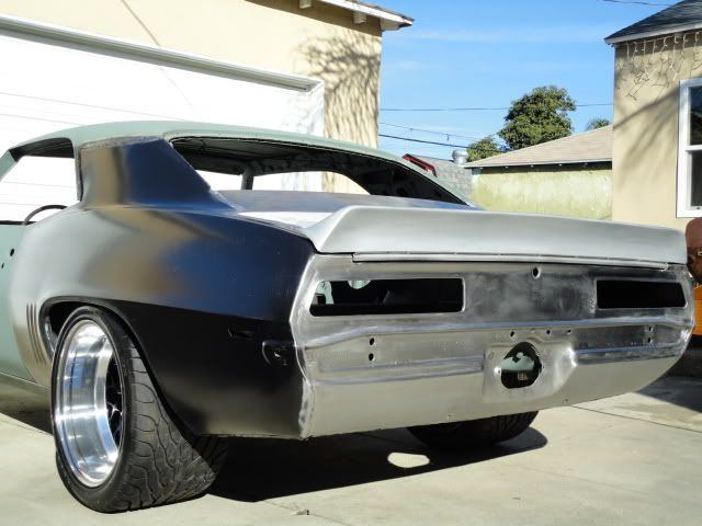

a bit of progress
3 Attachment(s)
a bit of progress

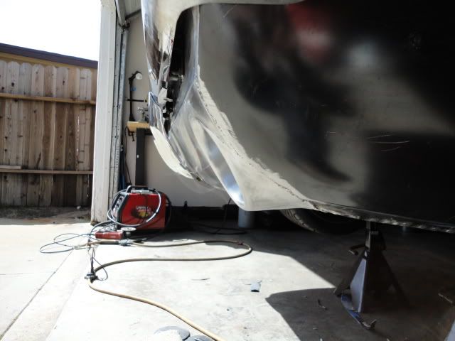

i finally got to roll the quarters,welded some odds and ends.cut molded and welded quarter panels to get the gap to trunk to spec. did a bit of sanding with Da. I bought some used fikse FM10 18x12 w 5.750" back space , appararently these are old school type because they dont make barrels or lips for them anymore, rears will work but fronts are 18x10 w 7.750" back space which I need 6.125". ohwell
also fabricated and welded both trunk pieces where the roll cage will atach too.
well at least I was able to set it on the floor and get an idea of how its going to look.

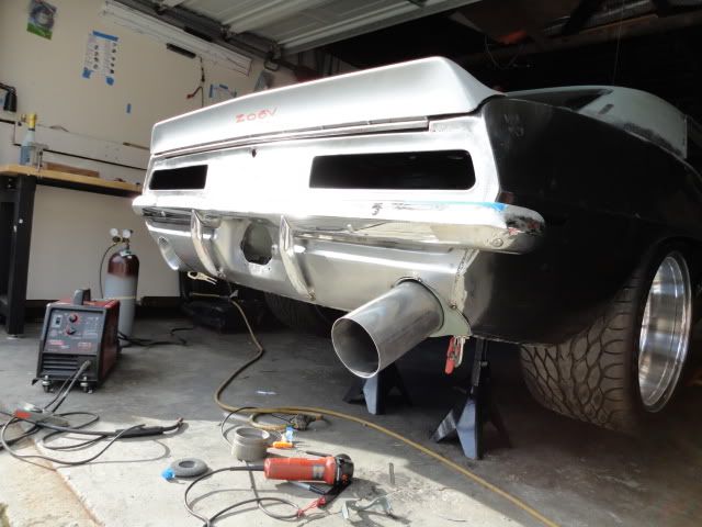

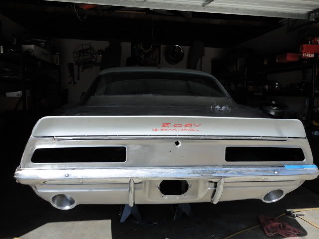

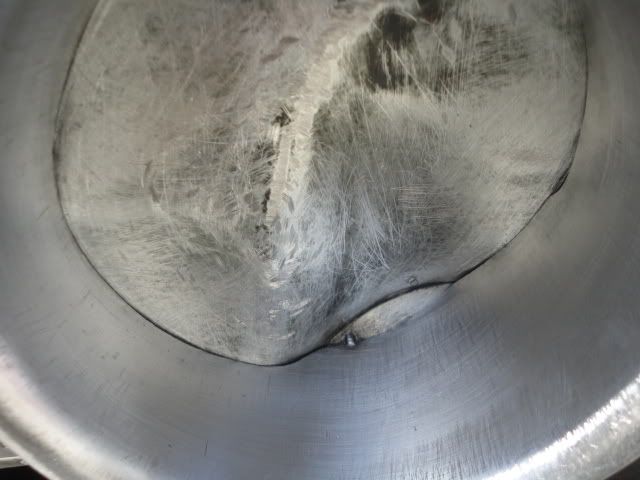

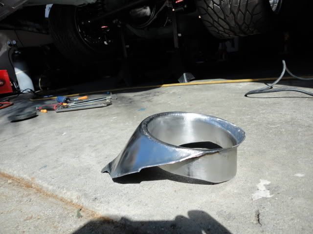

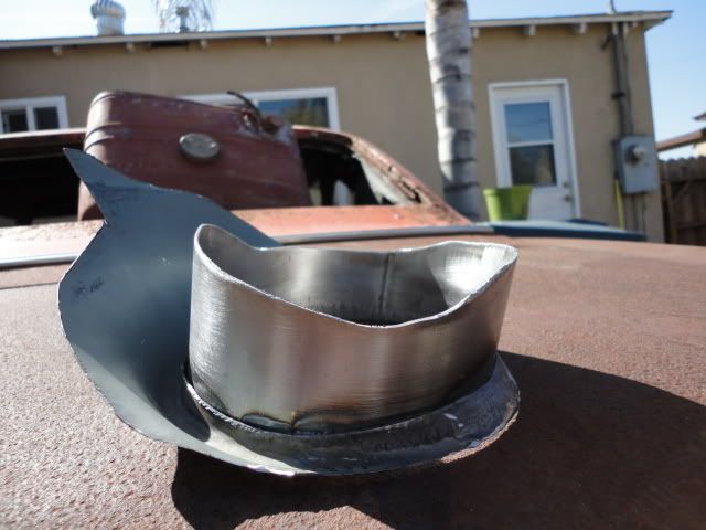

5" diesel truck exhaust
started playing around with an extra, damaged front lower valance and well got it into my head that I was going to use the round bezell for my rear exhaust. so I cut a whole on the rear panel and molded as much as possible went to a local diesel truck shop and got a foot of 5" exhaust. once I was happy with the way it was fitting the contour of the car ( both inside and out side) got to welding and grinding. and well 1 week later that how it came out.
also finally got another bumper that was not as twisted as the other and tucked in both sides to 1/8 from quarter all around (top and bottom) except for rear
it looks bad ass in person
