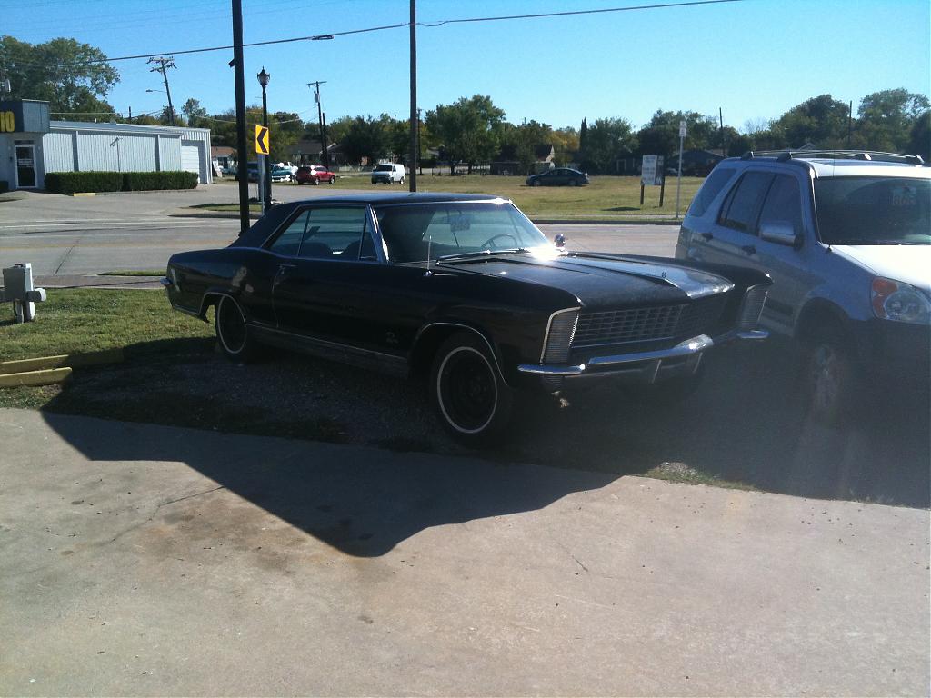

4 Attachment(s)
Here's a few pictures of what I'm starting with. The interior is just about perfect, the body has 45 years of doors dings and thin paint, and the underside requires some surface rust removal and repaint. This should at least give you a bit of a, "Before", thoughts as the project moves forward.
Any thoughts or comments appreciated.

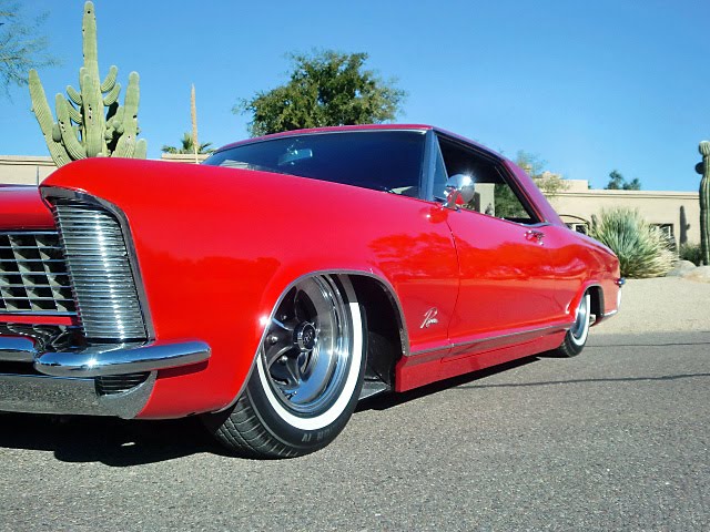

BTW: Here is the Original Rendering against a finished product.

I've been real good and real sick. Thansk for asking. Ups and downs. Somedays I'm fantastic other weeks I'm down for 5 days in a row. Recently my pump went dry for a weekend and I spent the weekend fighting withdrawals instead of checking into the ER. Bad mistake. Doc said I was playing with my life. Just lots of sweating, swearing and lack of sleep and PAIN, lots of it.
The car looks fantastic.
Years ago I wanted to protour one, but after learning what protouring really means to most people, nope. I'd bag it and run astro supremes and skinny whites with lakepipes traditional 60s style. But thats just my opinion.
Love this one minus the striping:
http://www.rodandcustommagazine.com/.../photo_03.html
http://2.bp.blogspot.com/_ZqXXq3ROw4...d_riviera5.jpg
Wheels and tires is all a riv need, the bags are neat because rivieras look MEAN low
That said I may buy one after selling the mini. I need to own one before I expire.
