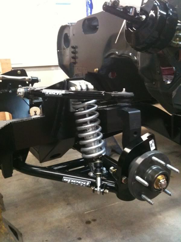

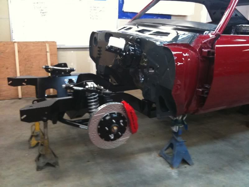

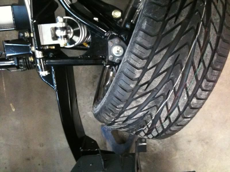

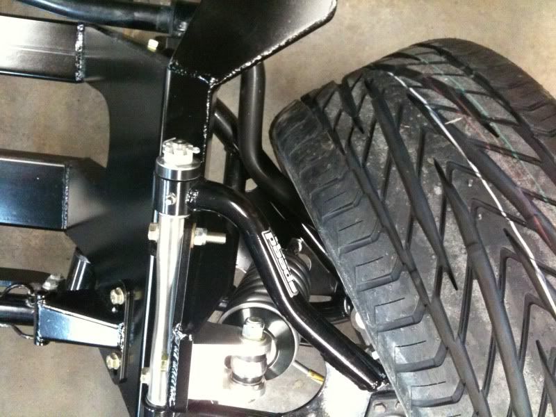

youthpastor 12-03-2010 09:12 AM
finished the suspension last night and wanted to show the clearance of the Speedtech frame with a 18x9 on a 275
http://i250.photobucket.com/albums/g...%20z28/228.jpg
http://i250.photobucket.com/albums/g...20z28/2252.jpg
http://i250.photobucket.com/albums/g...20z28/2262.jpg
you can see that the arms and sway bar are designed for clearance
awr68 12-03-2010 10:11 AM
Great shots Chris! :thumbsup:
Did you test fit these wheels/tires with the front sheet metal installed? I have 3/8" less bs than you. Obviously frame clearance won't be an issue...but the fender might be a problem. Just wondering what the clearance was like on yours.
youthpastor 12-03-2010 10:57 AM
wheels just showed up...but Roger said it should be more than enough
