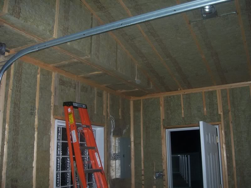

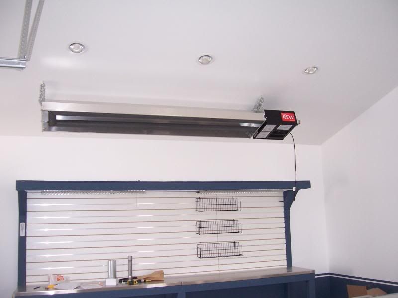

g356gear 01-04-2011 08:08 AM
I love mine. If you can, you should focus on increasing your insulation and keeping the heat you generate inside the building. I did the super insulation with 6" walls in my garage when I was building it and have the infrared on through the entire winter. It runs @ 95% eficiency so I dont even see much change in my heating bill. Maybe $10/month in the winter with the garage @ 60 degrees.
http://i20.photobucket.com/albums/b2...agePics022.jpg
http://i20.photobucket.com/albums/b2...sline003-1.jpg
