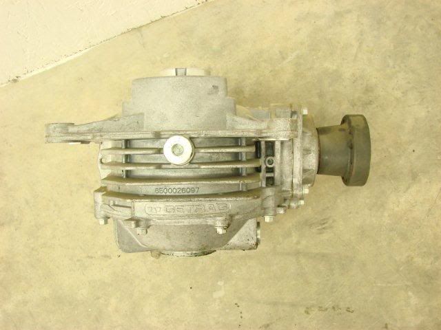

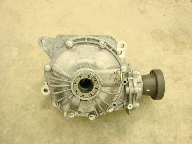

Motorcitydak 01-08-2011 07:17 PM
Here is the STS diff im getting
http://i57.photobucket.com/albums/g2...k/DSC00182.jpg
http://i57.photobucket.com/albums/g2...DSC00183-1.jpg
Like I said, its very compact and will be easy to build around/into the car. Im getting the driveshaft with it and will still have to figure out what CV shafts to run. Most likely I will just do the STS shafts and have to get em modified for lenght

If finding parts or using that Getrag diff proves difficult, keep in mind that you can use any IRS rear diff by running it upside down (high pinion). Some factory 4wd applications actually used this setup without any oiling problems.
