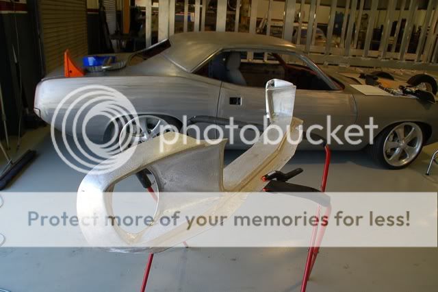

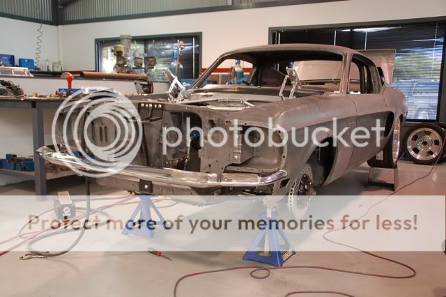

Southrod 01-09-2011 01:13 PM
GT 500 Pro Tourer
I think we are far enough along on this one to make it interesting for everyone,well maybe not everyone after all its not a Camaro.
This is a genuine non orig numbers GT 500 Shelby and we are gunna cut into it, I can here the purists screaming now!.
this will run a shelby alloy 427 block with blue thunder heads heads and TWM/Borla injection 6 speed tremec Magnum,TCP suspension front and rear, Baer 6s brakes,the customer has asked us to remake all the Original shelby fibreglass in metal.and end up with a fit and finish to rival his high end cars.
Bit of a challenge,lets see. Sorry if this is abit boring to start with.

Thanks to everyone for the kind words,we consider ourselves lucky to be working on some of the top car builds in Australia,all our cars are alkaline dipped before we start work.

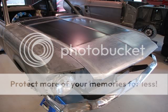

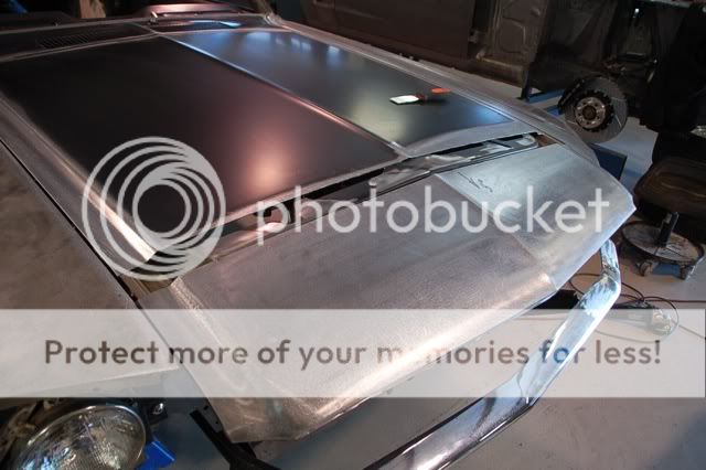

We will have around 150-200 hrs in them,dont forget that this is a genuine GT 500 so it already had all the original glass pieces just the customer wanted more of a 67 style front and no glass on the car only steel to give it more of a hand built, one off feel.
Shane.
Southrod 01-17-2011 02:16 PM

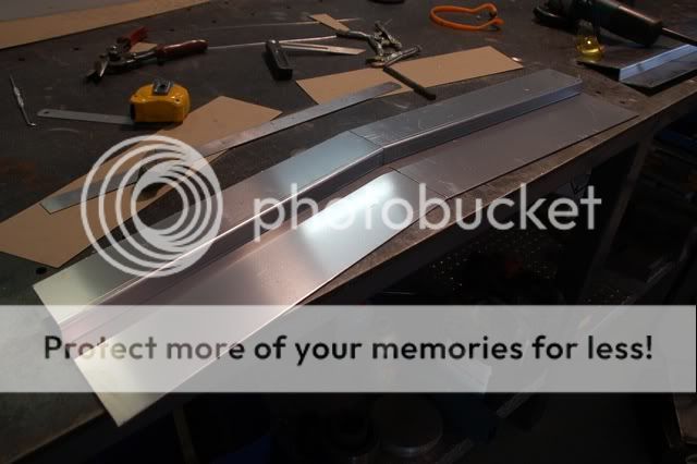

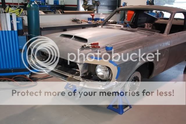

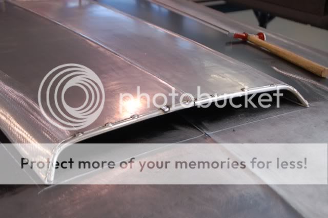

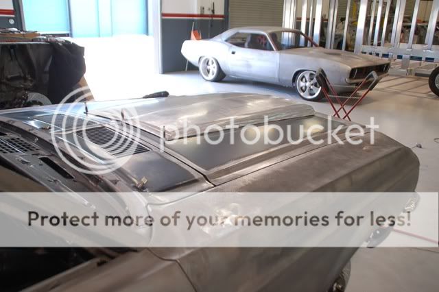

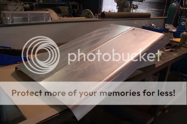

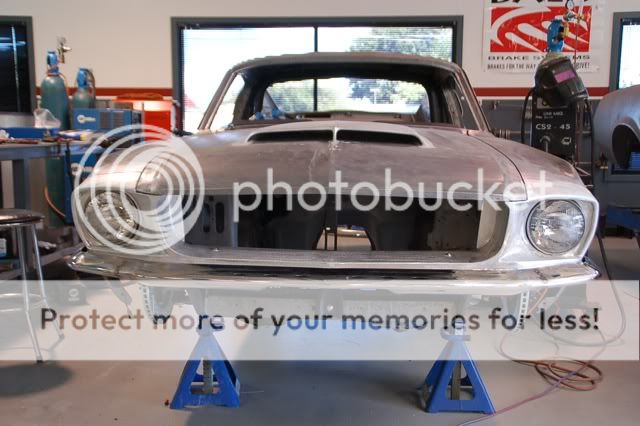

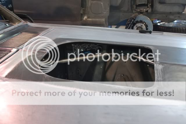

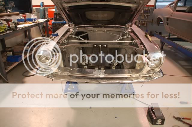

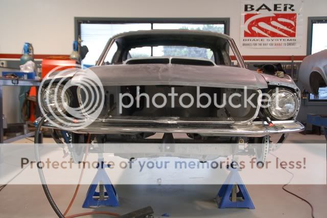

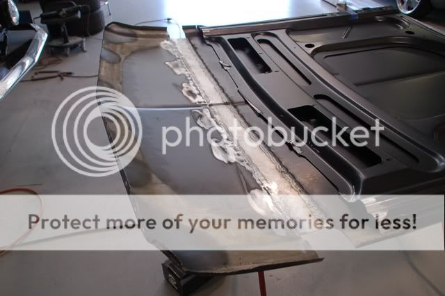

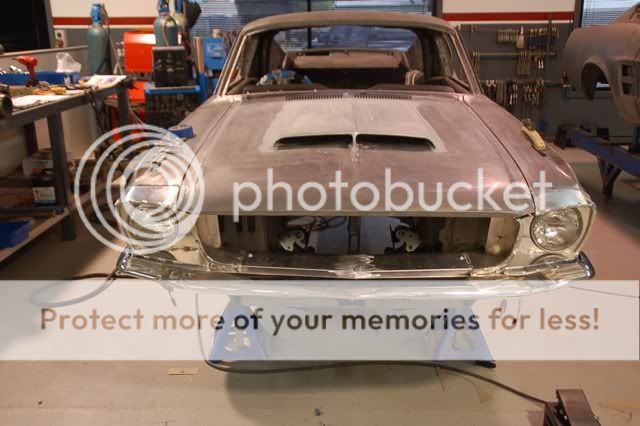

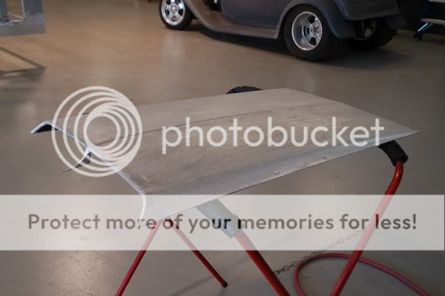

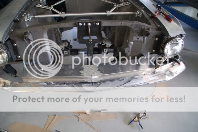

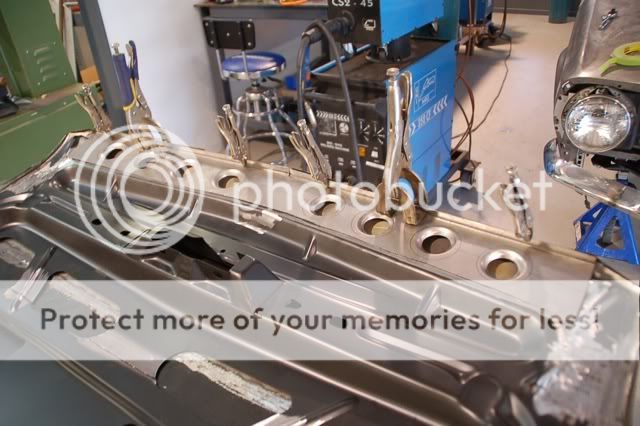

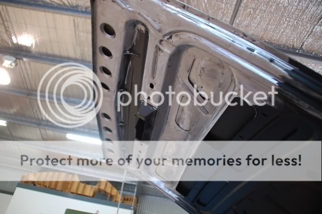

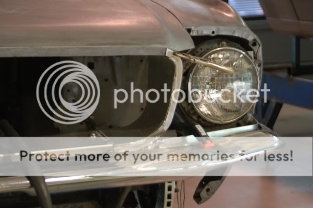

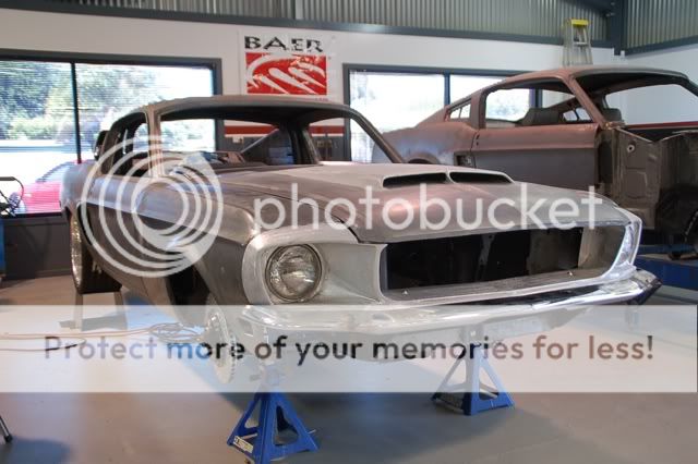

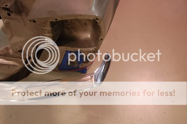

OK update time,fabbed up the front last couple of weeks, lengthened the hood
3 inchs and fabbed a functional hood scoop,decided after welding on the front half of the hood (repro piece of CR***P) that I would fab the scoop in aluminum and bond it onto the hood.
finished fabbing the front fascia,next Im onto the lower valance/ air dam then on its wheels to have a look outside at its profile.
