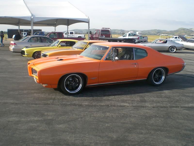

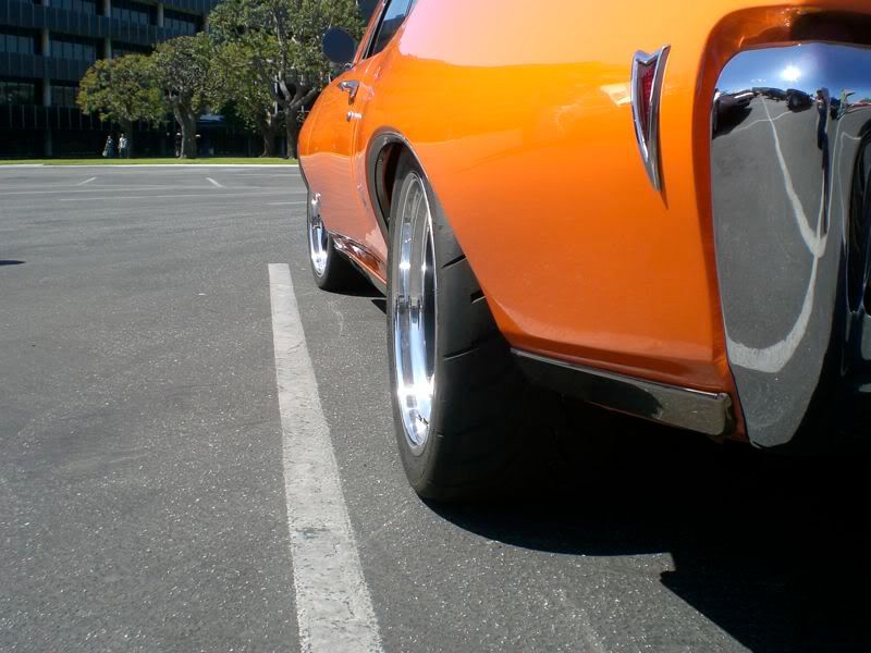

Roadbuster 02-07-2011 10:02 PM
I run an 18x11 wheel with 305/35R18 R888s in the rear of my 68 GTO.
http://i232.photobucket.com/albums/e...r/CIMG2550.jpg
http://i232.photobucket.com/albums/e...O/CIMG3429.jpg
I needed a little massaging on the inner tubs but did not need to roll the lip and I still have my wheel trim.

wmhjr 02-11-2011 06:18 AM
Personally i think roadbuster got it right. It looks (and probably is) more true performance oriented. There is a similar thread over on pt. It's amazing how different peoples tastes are. If somebody gave me a set of 20s I'd sell them and buy smaller rims. I'd save 22s for my massy ferguson. It won't notice the extra rotating mass.

Man that looks perfect! You mind giving me the back spacing on those - front and rear? I am actually pretty set of 18s all the way around - figured on 245/45-18 up front and 285/40-18 in rear because of NJ's **** roads, but Roadbuster, yours is DEAD ON!

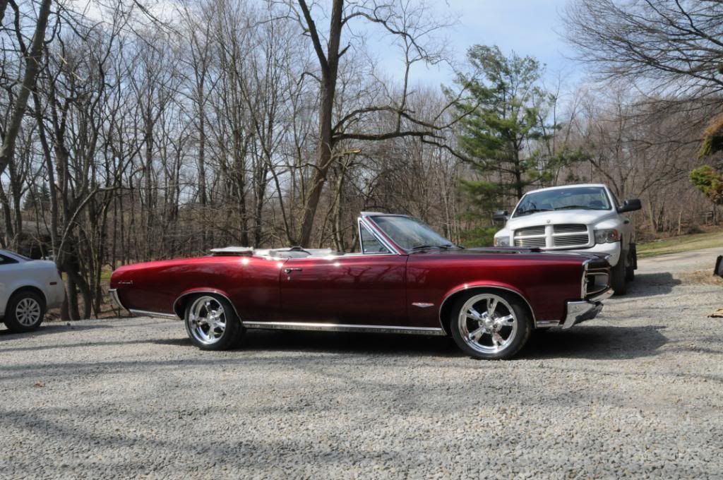

The WidowMaker 02-11-2011 09:31 AM
i would agree with you if we were talking first gen camaros, but we're not. the wheel wells on these cars are huge and need a larger wheel/tire combo to look balanced. until somebody does a back to back test and shows me some significant number differences, i'll keep the 19/20s. i was going to go with an 18/19 combo, but most 18s wont fit my brakes and 19 rears suck for tire sizes.

wmhjr 02-12-2011 02:38 PM
For an a body, the car is huge. The wheel wells are not. In fact, they're too small. They need work just to fit a decent combo. As I said, it's opinion. Personally since I knowmthe larger than necessary wheels detract from performance, I don't like them or the look. Too much "low rider" of a look. You have to get wheels, so you can't compare to removing glass or handles. We buy wheels and tires to improve performance and looks. To me, the really big ones satisfy neither. But that's why we have so many different looks. It's all opinion. As well, if your rotors demand those sizes, no problem. Problem is that so few do.
The WidowMaker 02-12-2011 08:18 PM
i think we're talking about different measurements. you are right in that they could be wider, but they are VERY long. roadbusters tires have a few inches in the front and the rear of the tire. look at the silver 2nd gen in the background. that is a tire that fills the well nicely. i like a slightly larger tire on the rear of the a-bodies. roadbusters is very nice though. he'd still be hated on the chevelle site for runing a nice car with anything other than 15's though :thumbsup: .
