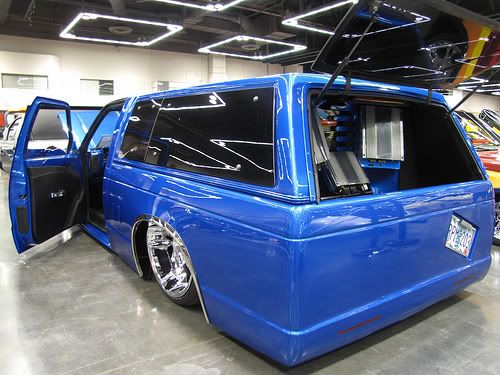

Thought I would include this picture of my truck, and I expect the "why would you do that" comments, but why wouldn't you is the real question. Full airride, four link with a watts link as well. This truck handles really well when it's off the ground of course.

I know what you mean, i have been drivin low for years and avoiding things. i will be building this with a happy medium, just throwin ideas around. Airride is great for many things but it is a huge pain in the a.
