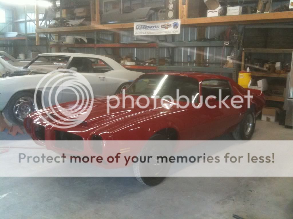

4mul8ion 02-19-2011 08:58 PM
4 Attachment(s)
Out with the old paint and bondo cake.
4mul8ion 02-19-2011 09:00 PM
2 Attachment(s)
Turnin' a corner.
4mul8ion 02-19-2011 09:06 PM
5 Attachment(s)
Getting it together.
4mul8ion 02-19-2011 09:12 PM
7 Attachment(s)
Priming and cutting the jams.
4mul8ion 02-19-2011 09:22 PM
4 Attachment(s)
In ... then out of the paint booth. :woot:
I got into the body shop real early to take these pictures and was asked if I slept in the booth overnight. Yep. :D And I had real strange dreams too. :rofl:

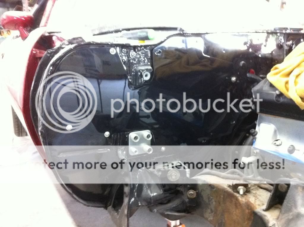

Well made a little progress. Got the evap core mocked up and fab'd some mounts
http://i370.photobucket.com/albums/o...s/29b419fd.jpg
http://i370.photobucket.com/albums/o...s/94e4d6ae.jpg
also began to fit up the a/c heater delete plate from BMR. I am going to paint it gloss black to match the firewall
http://i370.photobucket.com/albums/o...s/919a616f.jpg

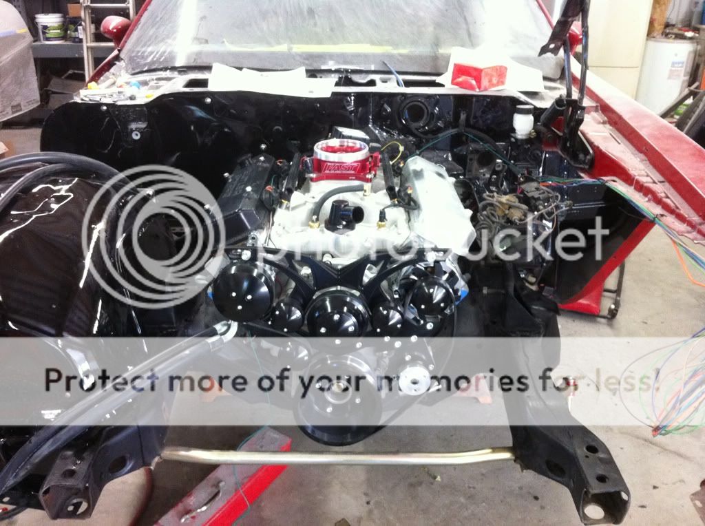

Got the March serpentine system in and installed. Got the valves adjusted and got the motor installed along with the hydraulic slave mounted. with the fabricated valve covers the d/s hits the factory booster so were gonna need to go with a 8" dual booster for clearance.
http://i370.photobucket.com/albums/o...s/7f066dfc.jpg
http://i370.photobucket.com/albums/o...s/658528ea.jpg
http://i370.photobucket.com/albums/o...s/5c624dda.jpg
http://i370.photobucket.com/albums/o...s/1fa59d78.jpg
http://i370.photobucket.com/albums/o...s/32575e1b.jpg

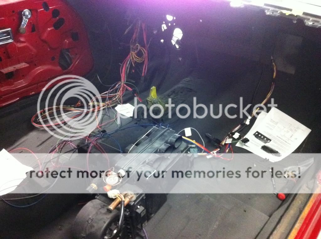

we've got the entire inside of the body coated in lizard skin insulation and sound control. Began wiring in the new AAW classic update wiring harness and the FAST EZ EFI harness. I removed a few lbs of wire on the efi harness since each wire is about 3 ft too long. Pulled the harness apart shortened it up and cleaned up the routing and added a braided loom since i cant stand "split loom"
Kevin decided to swap out his QA1 coilovers and global west a arms for Pro Touring F body Tubular arms and Ridetech SA coilovers. We are also going to be mini tubing the car and adding a Ridetech Air Bar in the rear. http://i370.photobucket.com/albums/o...s/1a21d152.jpg

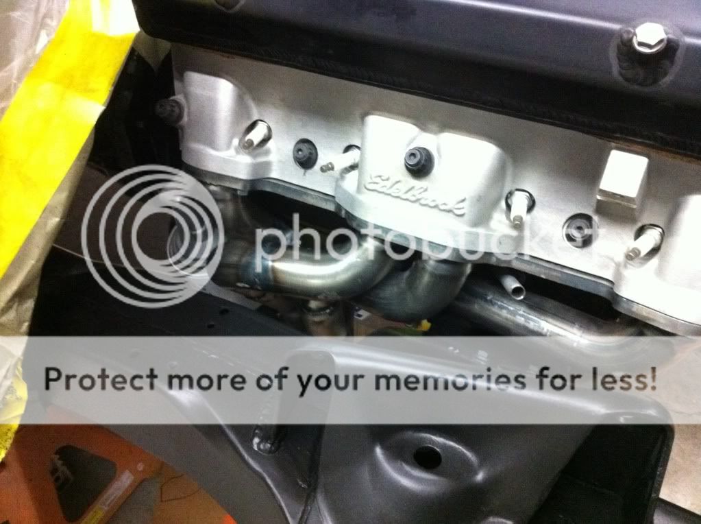

We also finally received the Tribal Tube tri Y headers and they fit great.
http://i370.photobucket.com/albums/o...a/IMG_4311.jpg
http://i370.photobucket.com/albums/o...a/IMG_4308.jpg
http://i370.photobucket.com/albums/o...a/IMG_4309.jpg
