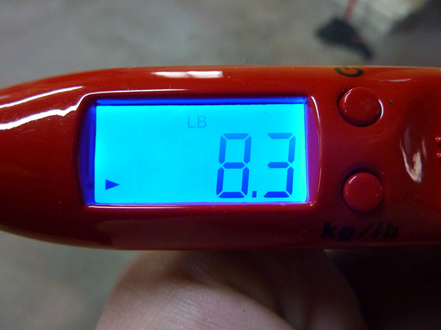

For those that were wondering about the weight. I think in the end, this will be lighter than going with mdf. So far I'm only at 8.3lbs for the skeleton.

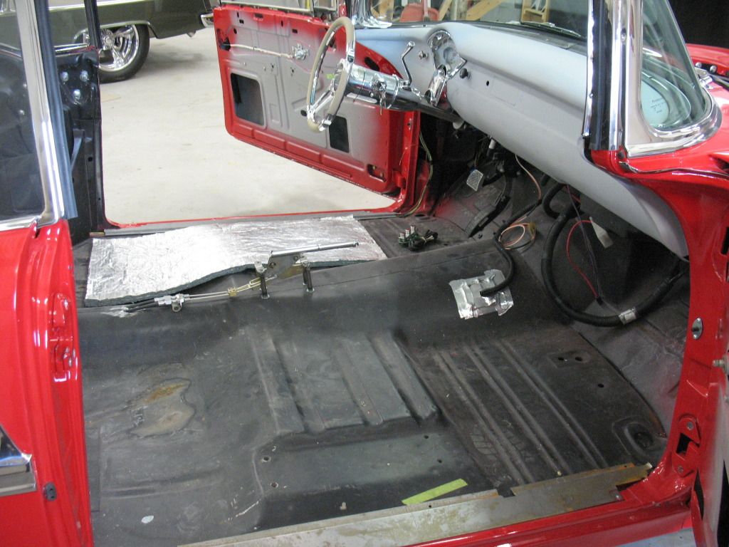

It's a Lokar handle. http://lokar.com/product-pgs/emergen...handbrake.html Here's a pic that I borrowed from Roger at Ironworks. The hand brake bracket that I have is one that he sells. This is from the Goodguys car they built and I kept this pic to show how it hooks up.
http://i222.photobucket.com/albums/d...9/IMG_5884.jpg
If you look here, Roger has another pic of how the handle hooks up to the cables. I'm going to run my through the floor the same way.

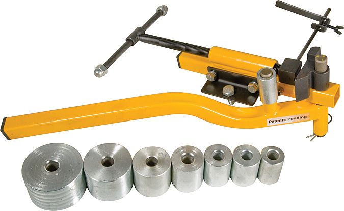

The second tool I've used is this.
http://i222.photobucket.com/albums/d...69/8000447.jpg
They just call it a universal metal bender and I think I paid $40 on a sale. You can change the dies and it allows you to make circles in the metal. I paid $10 extra to get a DVD that shows what the tool does. Looks like guys use these to make round bar art when there are lots of bends. I used mine to make the piece around the parking brake in this pic. I'm also going to use it to build some pieces to hold up the cup holders.
http://i222.photobucket.com/albums/d...9/P1000927.jpg
Those are the only two specialty tools that I've used for the console. The other tools I've used are: a hack saw, hammer, vice, measuring tape, welding magnets and of course a welder.
