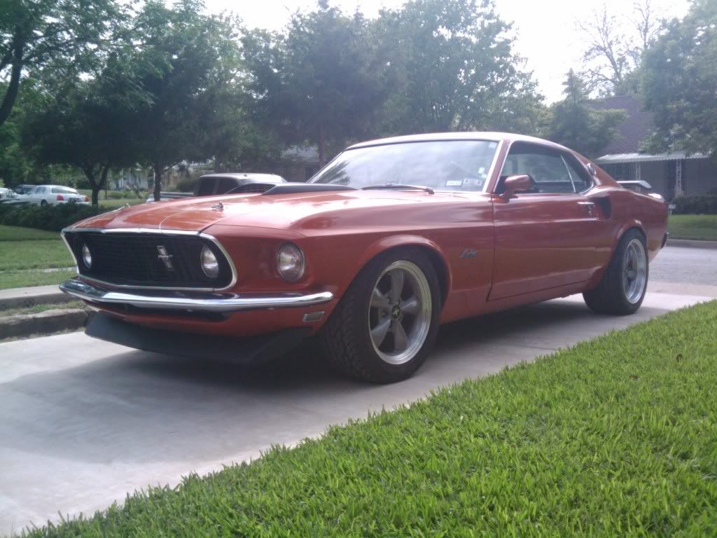

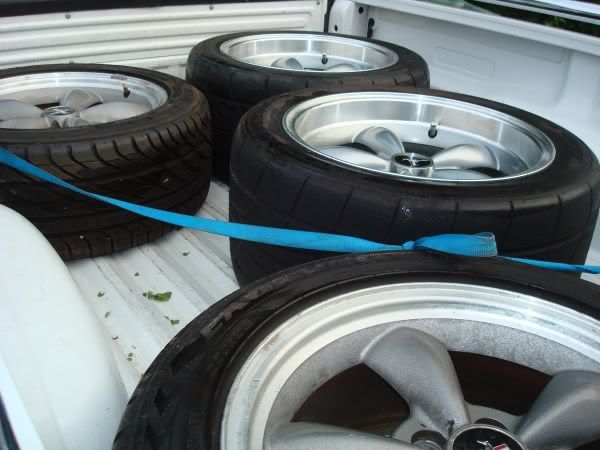

I picked up some bullitts for a good deal this morning before work. Factory Anthracite 17x8's up front on some 235/50rz17 meats and some 17x10.5 repro's with nitto 315/35 drag radials out back. The color of the repro's arent spot on, theyre lighter, more of an actual silver color. But im not worried about it. all tires have good tread and it they look that bad, Ill paint the centers black on all of them. cant wait to try and stuff them. Need to pick up new lugs, and dig out the BFH in the garage haha

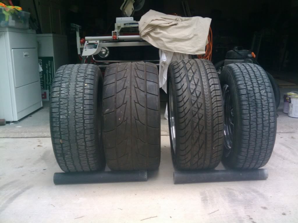

MattWash08 04-10-2012 03:42 PM
Old tires on outside/new on inside..
http://i265.photobucket.com/albums/i...409_143709.jpg
test fit one front with the 1" spacers and I think theyll work great even after I get the front end down some. Also test fit the drivers side rear using the other 1" spacer I have and it pokes out just past the fender. Have some ARP studs ordered so i can swap those out and run about 7/16". Probably going to have to run about a 5/8" spacer on the passenger side as my rear is offset a little. here are some cellphone pics of the mock-up.
http://i265.photobucket.com/albums/i...409_181649.jpg
http://i265.photobucket.com/albums/i...409_181753.jpg
http://i265.photobucket.com/albums/i...409_143055.jpg

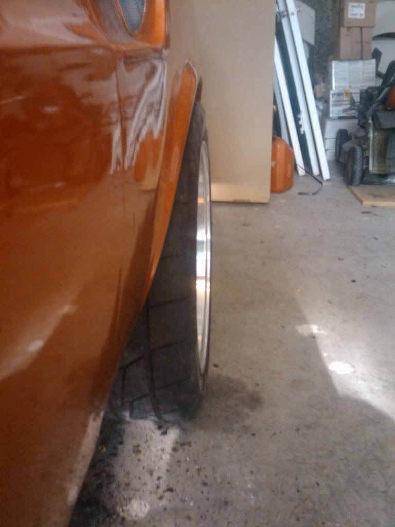

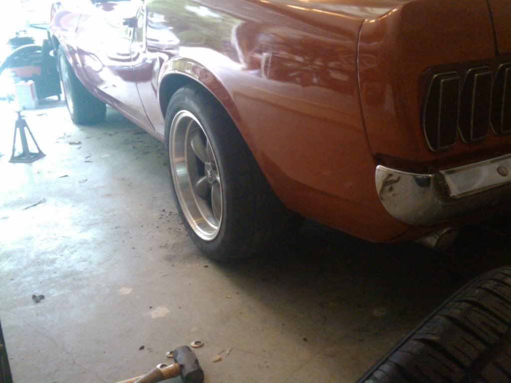

MattWash08 04-18-2012 07:14 PM

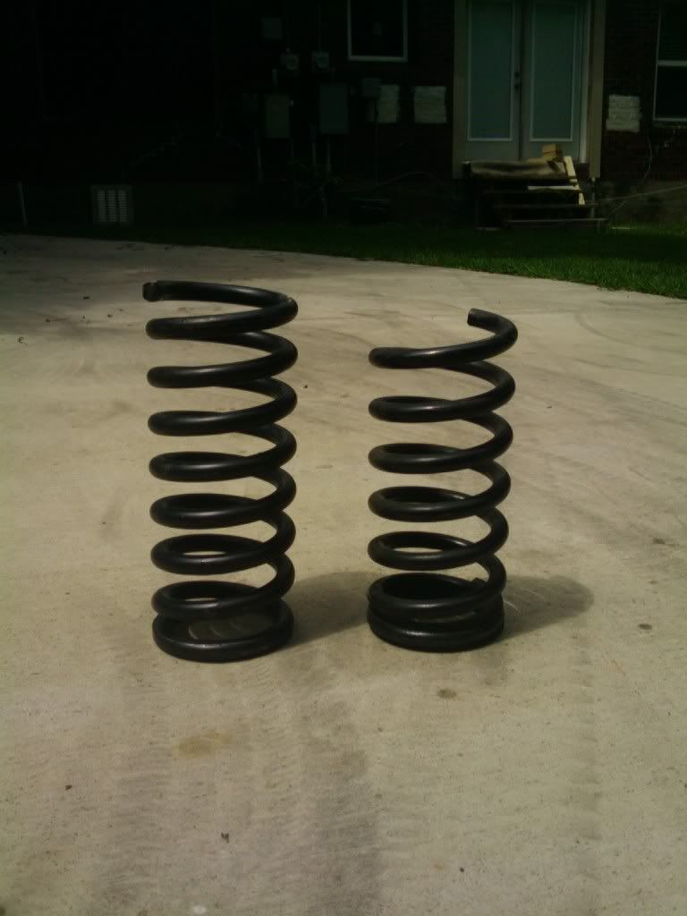

Got a lot done last night and today. got the studs swapped out. Pulled out the stock length front springs and put my cut springs back in. I had put on the 1" rear lowering blocks last week. I also changed the oil and went and got it inspected today. NOWW Im just trying to deal with a squealing belt issue that I am going to try and remidy with a new alternator belt in the morning. used two 5/16" spacers on drivers side(5/8" total) and three of them on the passengers side(15/16" total) until i order single spacers foreach side. On to the pics!(all cell pics tho..)
stock spring next to one of my cut ones
http://i265.photobucket.com/albums/i...416_125610.jpg

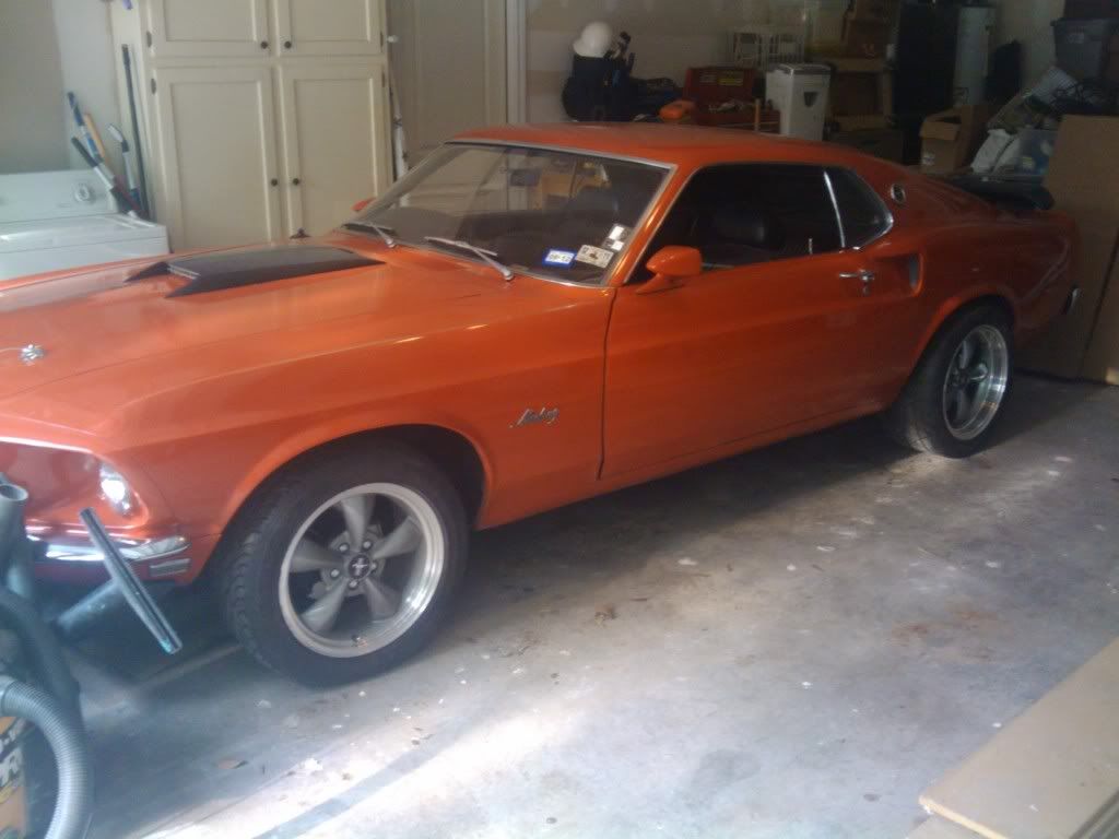

and just some of how the car sits now
http://i265.photobucket.com/albums/i...416_161238.jpg
http://i265.photobucket.com/albums/i...416_161252.jpg
http://i265.photobucket.com/albums/i...416_161307.jpg
http://i265.photobucket.com/albums/i...416_161439.jpg
http://i265.photobucket.com/albums/i...416_161554.jpg
1badsc 04-18-2012 07:55 PM
WOW what a difference the stance makes ...looking good
frojoe 04-18-2012 08:04 PM
Holy crap that looks good... real nice job!

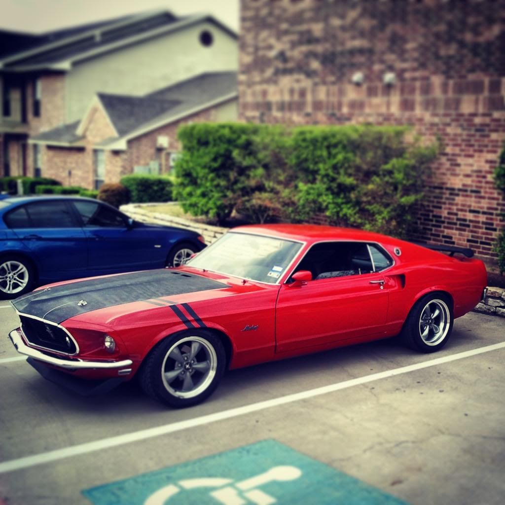

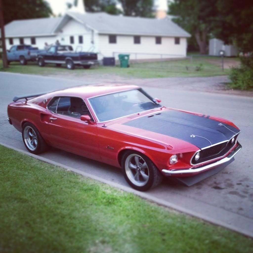

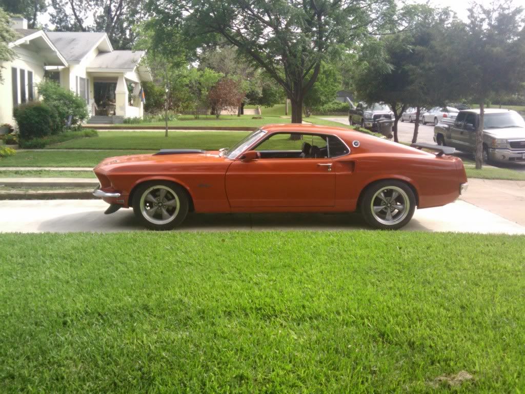

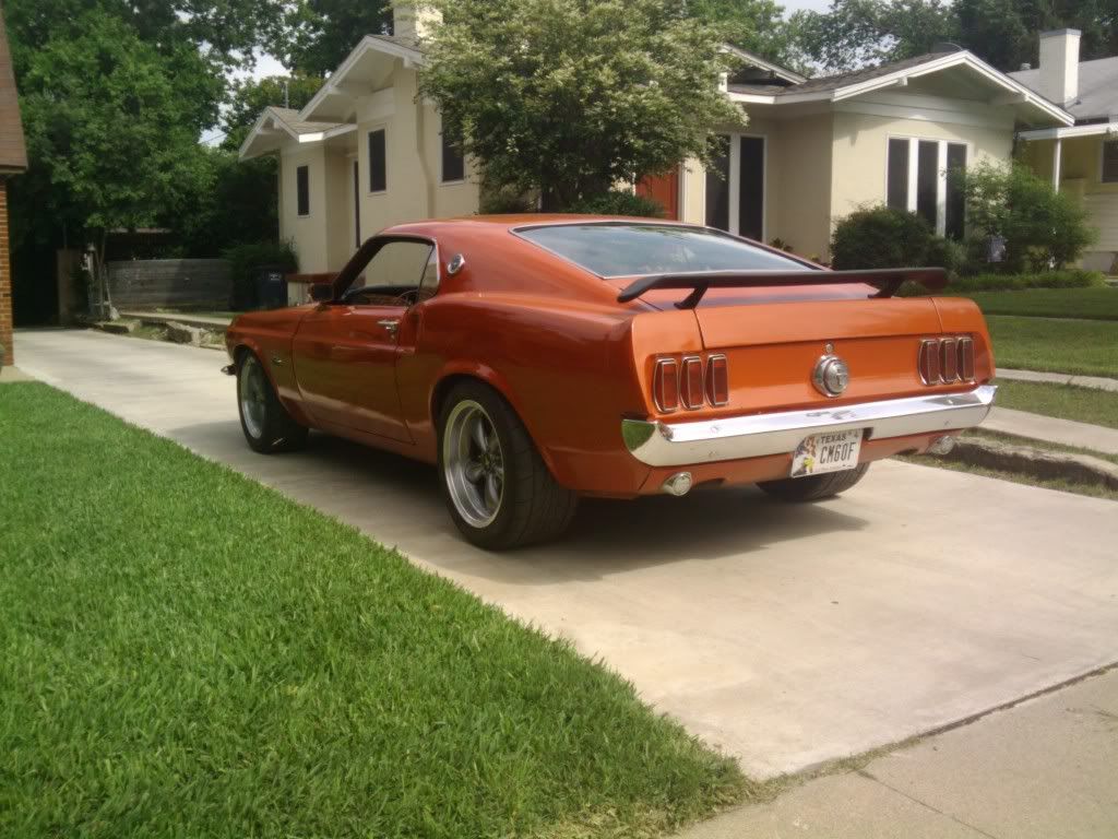

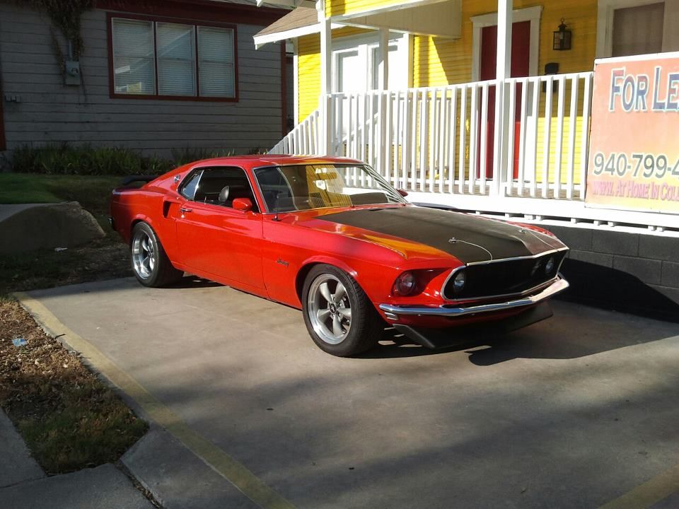

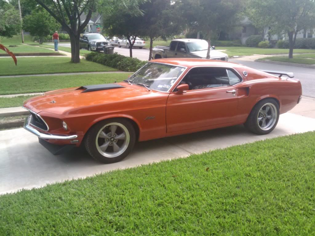

MattWash08 10-27-2012 06:00 AM
Photobucket account got all screwed up so most of the pics were moved into new albums.. So Im just going to post up random pictures. Im actually getting the car back from the shop monday from getting the motor freshened up!!
Ill try to go oldest to newest on pics..
http://i265.photobucket.com/albums/i...20da53eae2.jpg
http://i265.photobucket.com/albums/i...0-20122121.jpg
http://i265.photobucket.com/albums/i...ellowhouse.jpg
Sieg 10-27-2012 07:25 AM
Nice transition!
Now get that suspension mod done so it drives as good as it looks! :D :thumbsup:

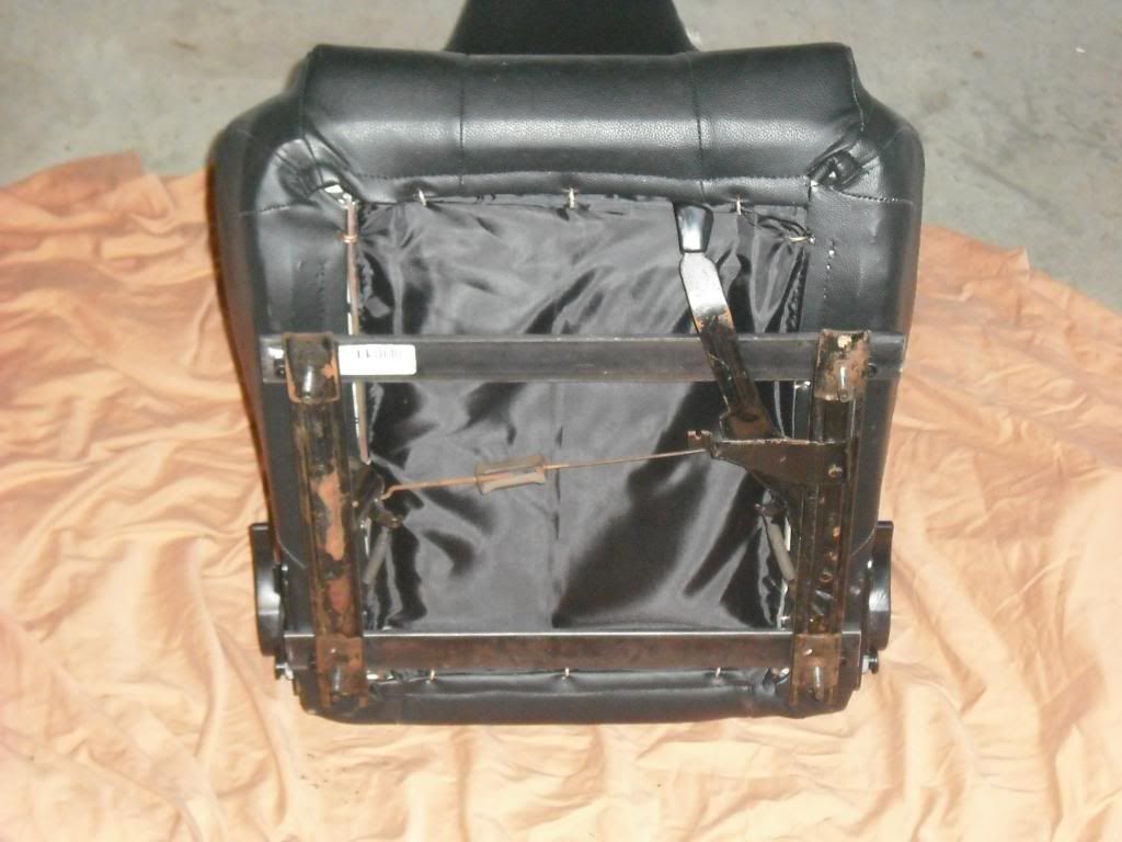

MattWash08 12-28-2012 01:22 AM

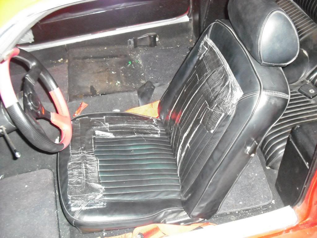

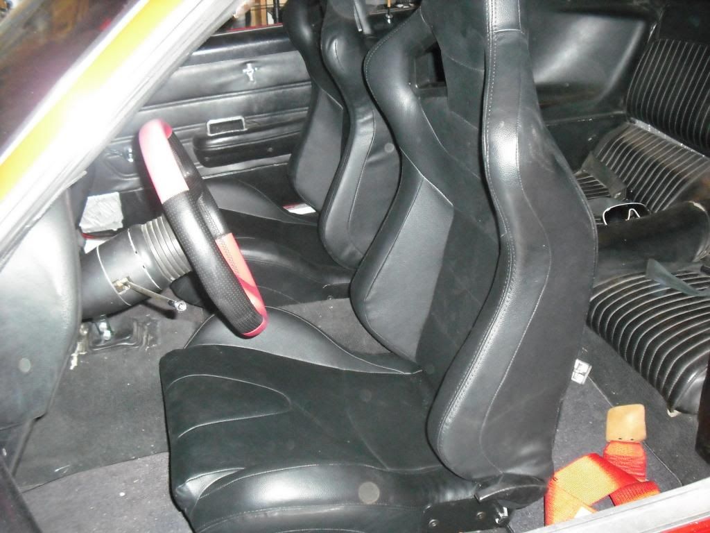

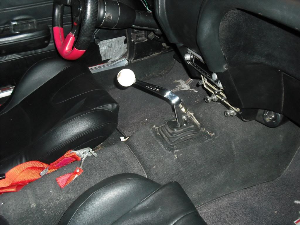

Finally bought seats and fabbed up some simple mounts and got them in today. Its nice not having it sit on duct taped seats for the first time in years!!
http://i265.photobucket.com/albums/i...ps6e0616bf.jpg
http://i265.photobucket.com/albums/i...psb2cbb9db.jpg
http://i265.photobucket.com/albums/i...ps532447f2.jpg
http://i265.photobucket.com/albums/i...psc97d3fff.jpg
http://i265.photobucket.com/albums/i...ps831e93c9.jpg

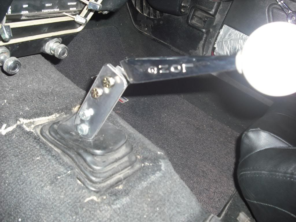

today I made a little shifter extension to bring it back closer to me a bit. Dont have the $$ to be buying a new one so this should work nicely

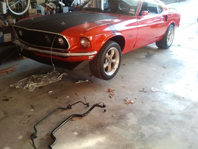

MattWash08 02-02-2013 05:28 PM

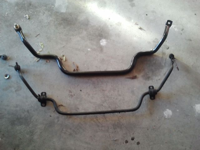

Installed my new front sway bar today, I didnt realize how massive it was compared to the old one until i put them next to each other!
http://i265.photobucket.com/albums/i...ps984482d4.jpg
http://i265.photobucket.com/albums/i...ps96c89912.jpg
