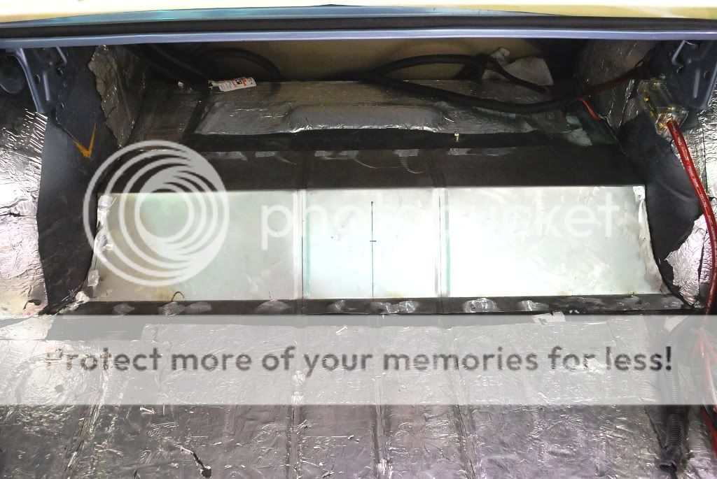

Roadster Shop 05-28-2011 02:46 PM
Thanks John!
On the Chevelle, all that was needed was to extend the section of the floor above the rear end back a few inches before dropping off to form the trunk well. It appears that a Camaro will need the same modification.
This was a pretty simple sheet metal filler piece we made. The additional room is actually only needed for frame rail clearance.

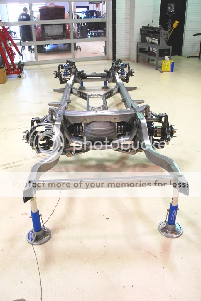

Roadster Shop 02-04-2012 08:38 AM
New Addition!!!!!
The Fast Track IRS is now available on our popular 1955-57 Chevy chassis!
Stay Tuned for more fully independent Fast Track chassis in the upcoming weeks. First and Second Gen Camaros are completed along with C1 Corvettes!

Roadster Shop 02-04-2012 02:00 PM
Thanks Marty!
Greg, it will fit the Nomad as well. The only issue is that you must remove the spare tire well and you can not use the stock nomad gas tank, which is generally thrown out anyways. We have a stainless tank that fits between the rails and can still use the stock filler location. The spare tire well is only big enough to carry spare brake rotors anyways and is generally replaced with a smooth floor. The nomad also has an additional body mount or two (Don't remember exactly off hand) that we have located in our jigs for when we build a Nomad chassis.
