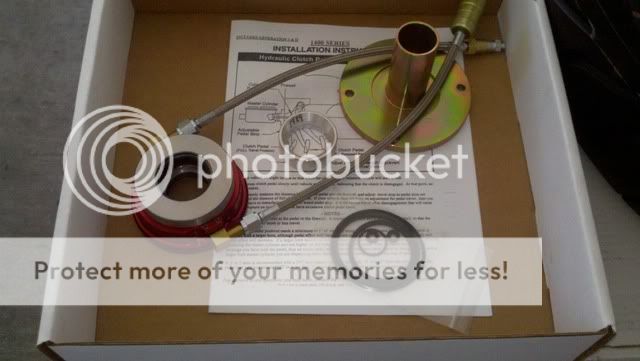

Hey Lee - I'm somewhat in the same boat as you and Tim above. 600 hp, RST for street manners and I bought the McLoed TO bearing for my T56 magnum. I've heard bad reports about it too, and it was very expensive (!), but the thing looks like a piece of aircraft engineering. I'll snap a pic this weekend and post it up.

Ron in SoCal 07-04-2011 11:40 AM
A few months ago I picked up Mcleod PN 14-302 for the T56 Magnum. I hope it works better than what you guys have experienced cause pulling the tranny multiple times is no fun!
