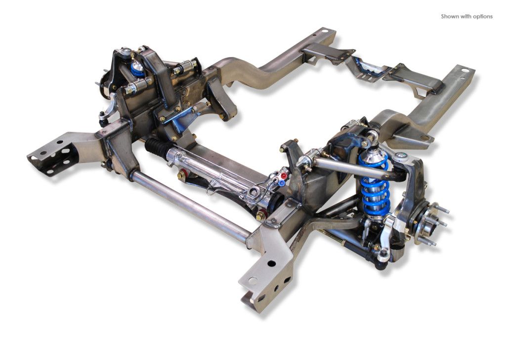

Astontibs 09-23-2015 12:49 PM
It has been a long time since I posted again because I have been concentrating my efforts on the LS1Tech site. For a full review of the build go to http://ls1tech.com/forums/conversion...8-camaro.html/ In summary I went with the Art Morrison subframe and used their headers as well. I also ran into interference with the motor mounts, but it was relatively easy to resolve by grinding on the mount. FOr the headers, I had to grind away some material from the passenger side lower control arm support to get adequate clearance but there seems to be plenty of meat there so I wasn't worried about affecting structural integrity. The last modification I had to make was with the mounts for the sway bar bushings. AME gives you collars to keep the sway bar from sliding side to side and the collars would not fit without grinding away some of the mounting surface. Again this was extra material anyway and won't affect structural integrity.
I was worried that the track width would be wider than stock, since I used to have a front tire clearance problem but it is actually slightly narrower and I now have no tire rub issues. The turning radius sucks but that is because it is for wider tires. I may remove the stops to get my turning radius back.
I like the way the car sits now, it is not too low which is something I was worried about.
I haven't really had a chance to push the car yet, so I will see how much better it handles.
Astontibs 09-23-2015 01:03 PM
5 Attachment(s)
A few pictures of the sub during mock up and final assembly
