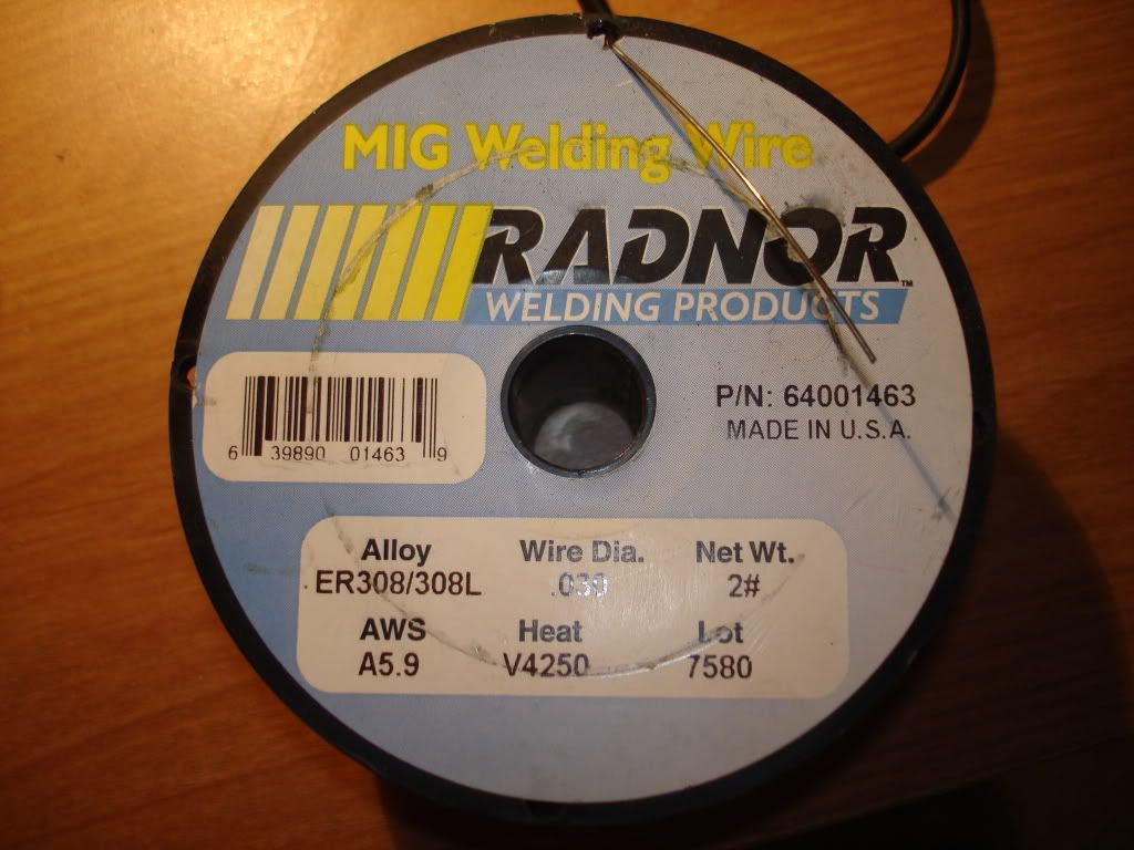

67ragtp 07-07-2011 05:33 PM
Greg knows his shiz, I will tell you I almost fell over when they told me how much this little 2# spool cost. I used the same stargon I use for mild steels and it worked nice.
