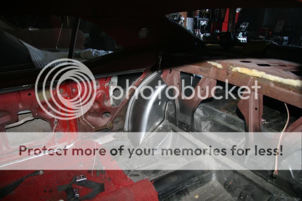

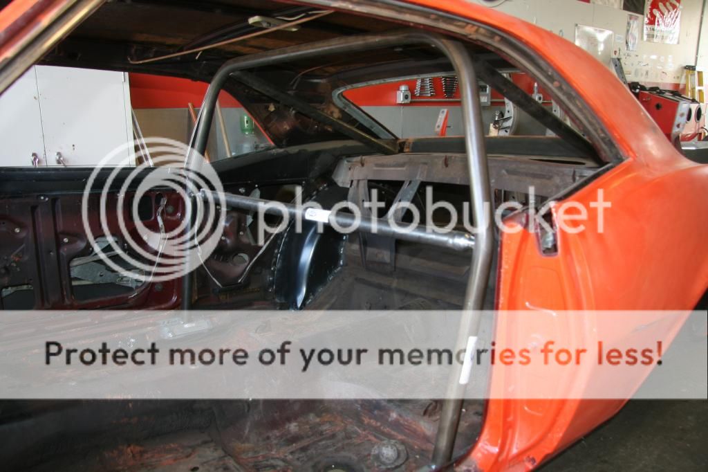

califconstruct 12-01-2014 09:01 PM
Installed
A little feedback from the install.. It all went well, Rich didn't experience any problems during installation, (other than running out of Bud Lite).
Fitment was good, close out panels fit well.
Overall tubs seemed as good as DSE, and vise versa. This is the second car of mine that I mini-tubbed and the parts were both well made.
Chassisworks
http://i477.photobucket.com/albums/r...k/IMG_7786.jpg
