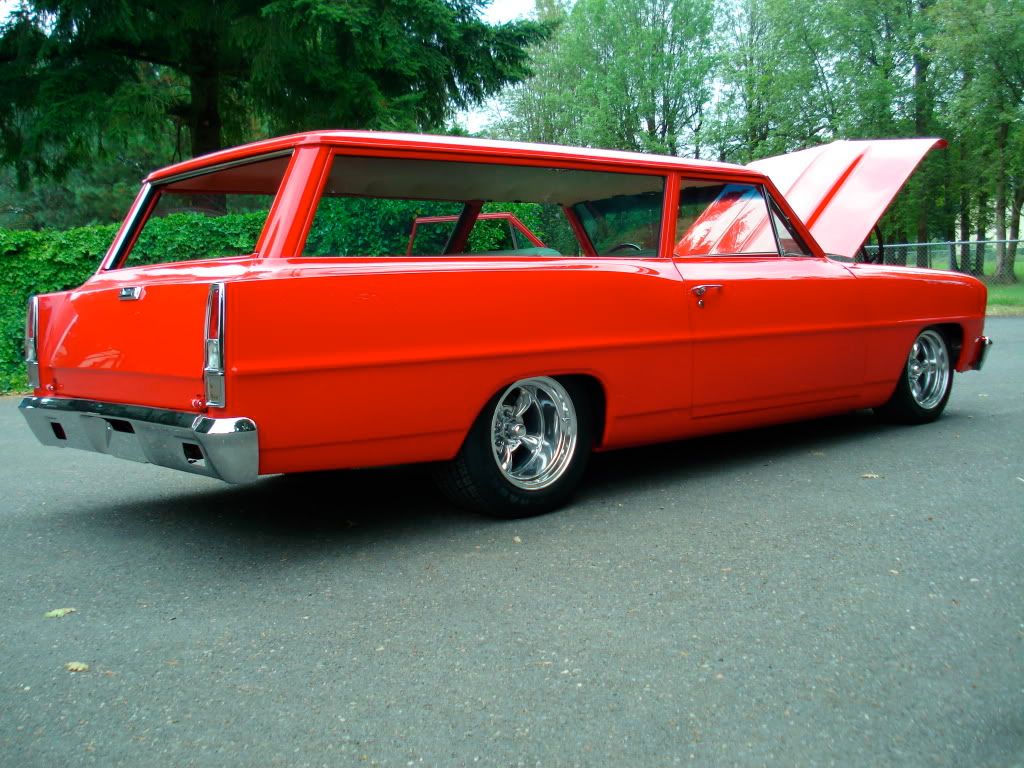

H8tulooze 08-13-2011 12:40 PM
Ive seen a couple, they look great.
http://i820.photobucket.com/albums/z...owns90/468.jpg
