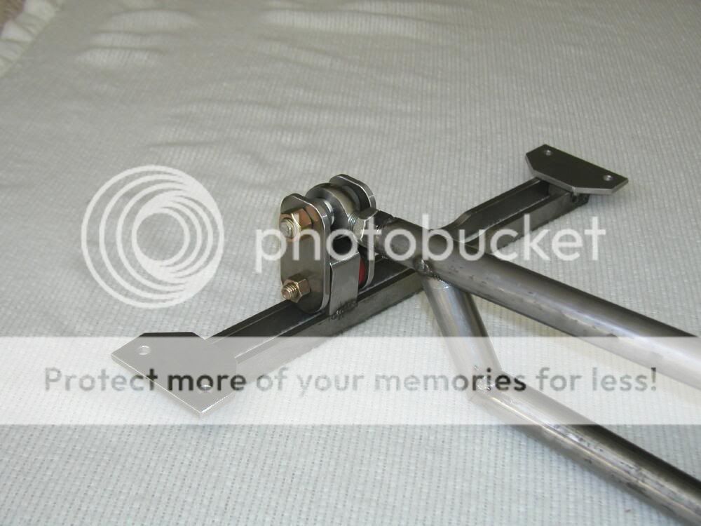

I have looked around and found a couple of different slider links. This was one that caught my eye.
http://i804.photobucket.com/albums/y...frontmount.jpg
Do you have any pointers on getting my A/S #s? Would it be the same as if I was going to measure for my foxbody?
I may go with a design similar to this for the length and hieght that you are talking about. Plus the fab work would be rather simple

Caluclate A/S the same way as a 4-link, using the rear tire contact patch, the CG and the IC. The IC is the pivot point of the torque arm.
I personally like the slider style rather than the dog bone style (like you have pictured).
I would go with a longer TA than you have shown. But that is dependent on packaging. Also offset it to the passenger side of the driveshaft if you can.

Here are some pics of the TCI slider fully compressed vs. fully extended
& also rotated
http://i981.photobucket.com/albums/a...h/100_5034.jpg
http://i981.photobucket.com/albums/a...h/100_5035.jpg
-J

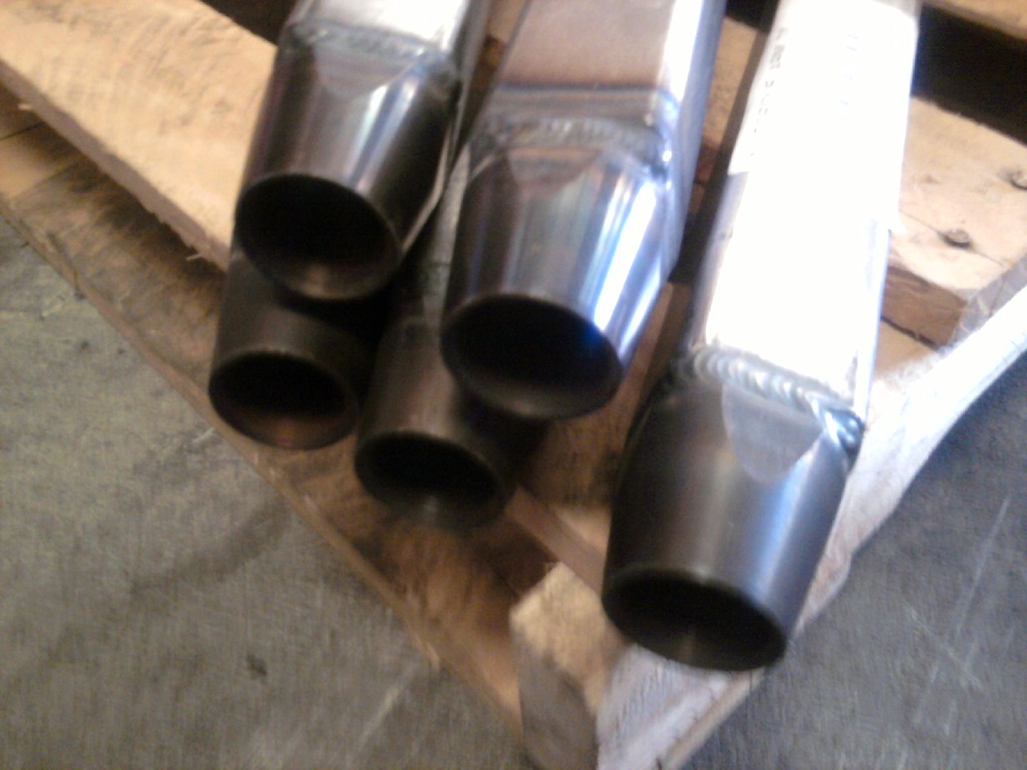

They are 1.25"-20
Here is a shot of the female end that gets welded onto the T/A.
http://i981.photobucket.com/albums/a.../Photo0151.jpg
-J
