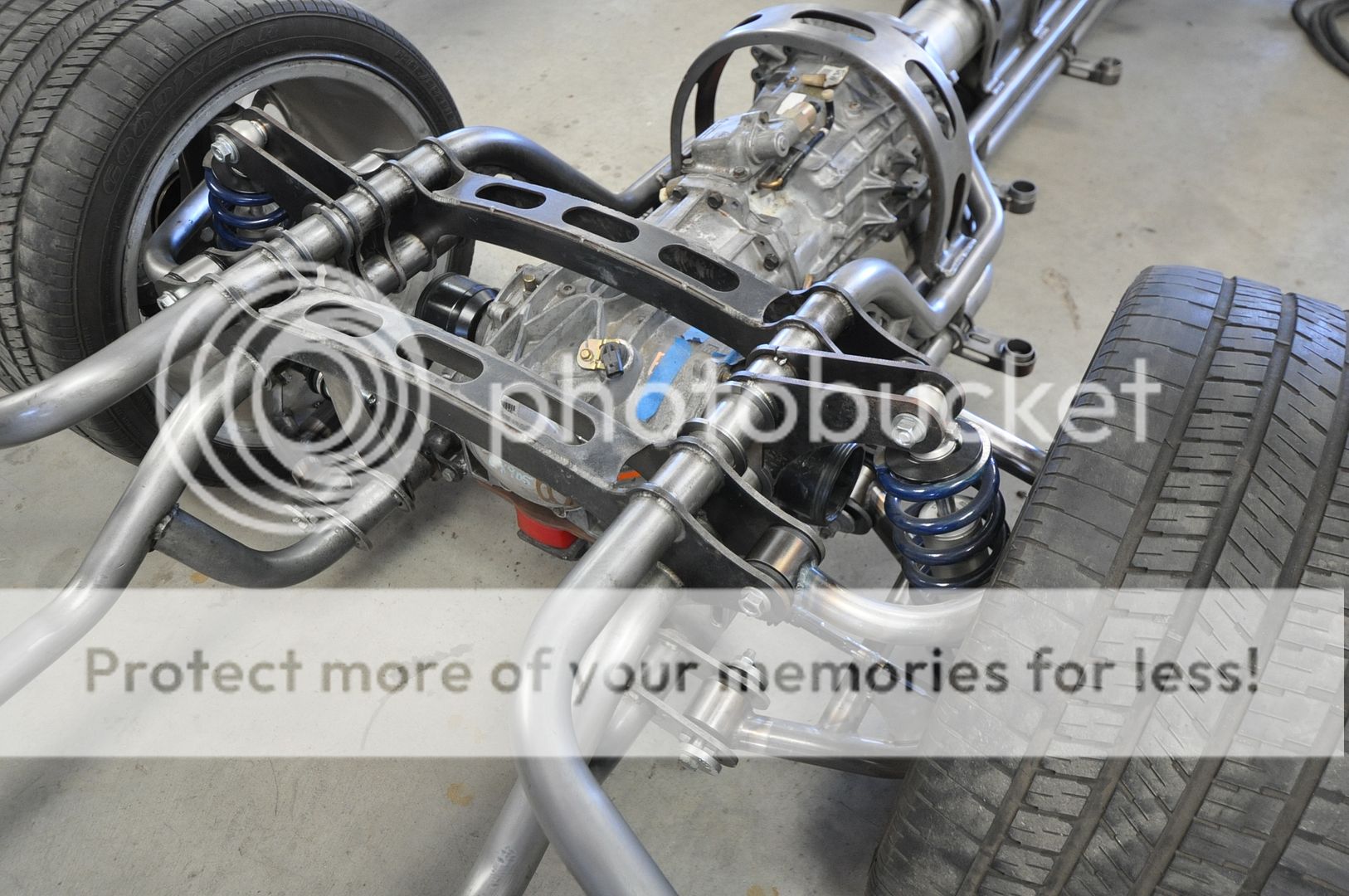

Chassis Construction - We built a tube chassis to hold corvette drivetrain and and LS engine. We also built the floor to hang down even with the rocker on the car and have a very strong sub structure to keep frame twist on such a narrow chassis to a minimum. We basically built the chassis to bolt to a very strong sub floor in the car.

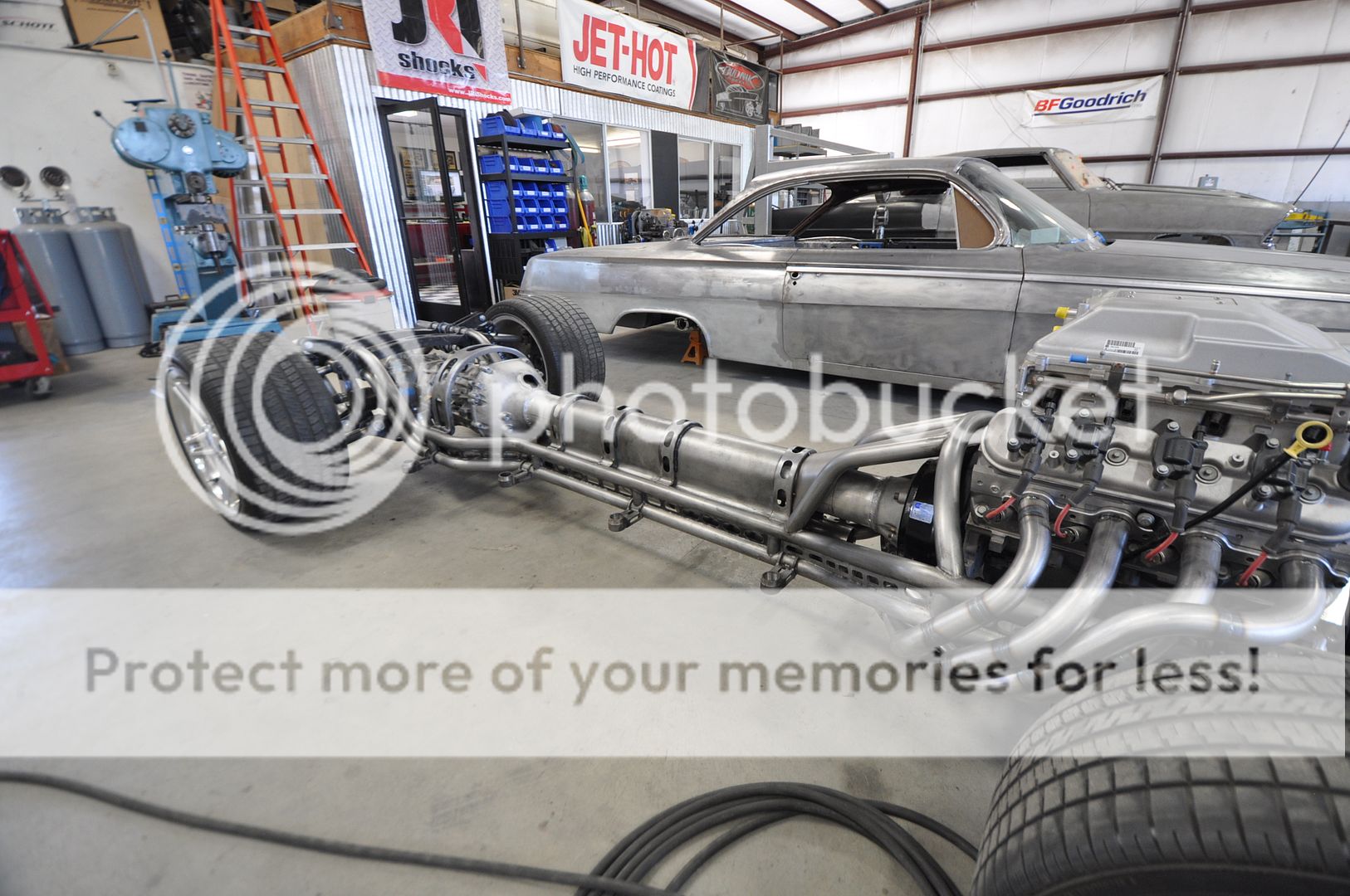

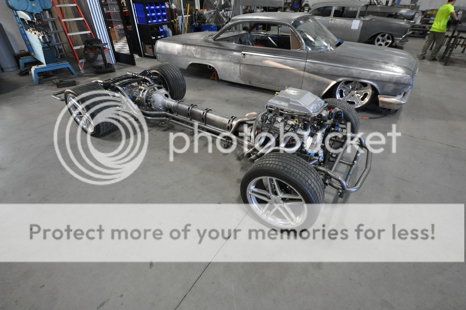

Some more pics of the complete chassis with the LSA engine. There was a point in time we were going to machine 2 sets of control arms for this chassis and the Eric's. It was later agreed that building them from Tube fit the chassis design and styling of the project. We are currently building those now.
http://i616.photobucket.com/albums/t...r2010007-1.jpg
http://i616.photobucket.com/albums/t...r2010006-1.jpg
http://i616.photobucket.com/albums/t...r2010004-1.jpg
When the LSA engine became available. Darrel just had to have it and the required a change in the rack position since the firewall had already been built around the frame. We had no room to go back so we are redesigning the front suspension to allow for a lower rack position and clear the blower pulley on the front of the car.

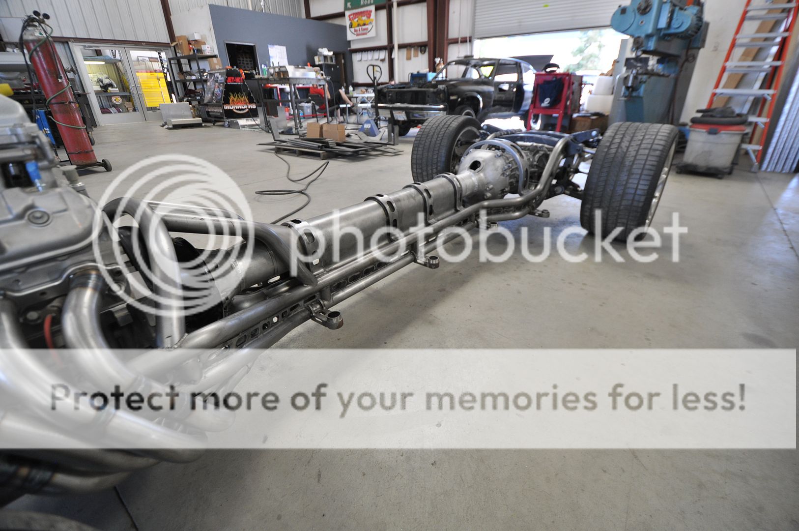

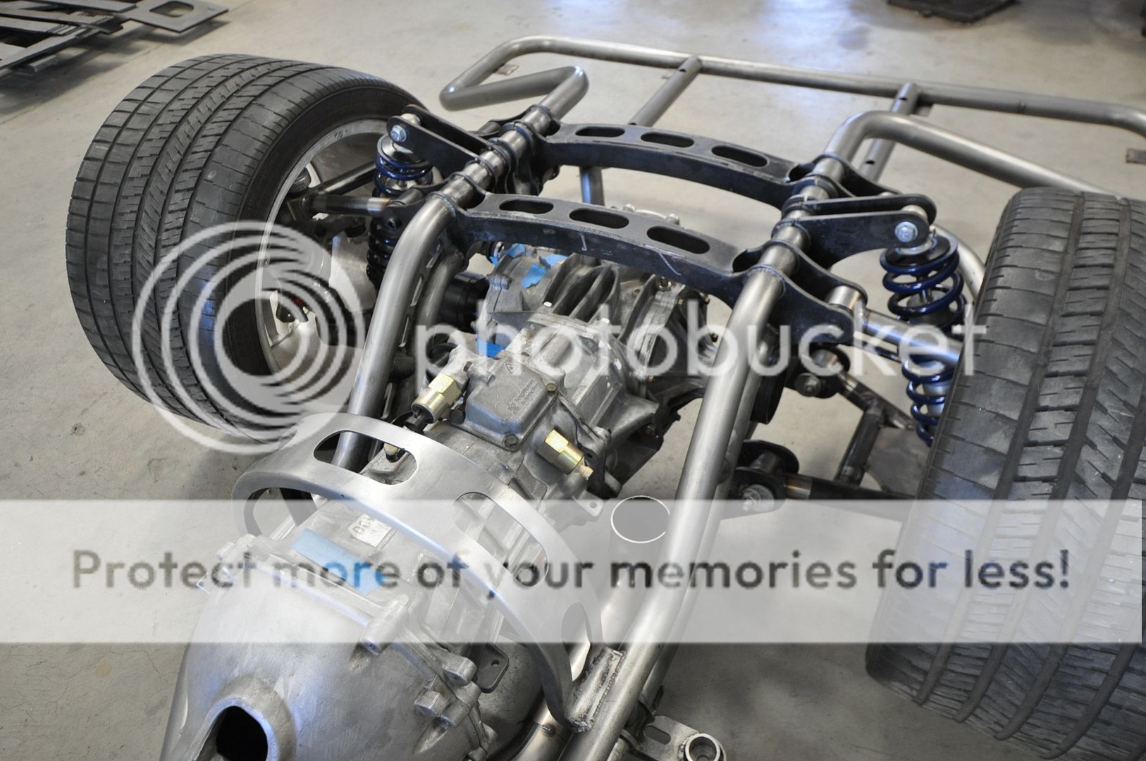

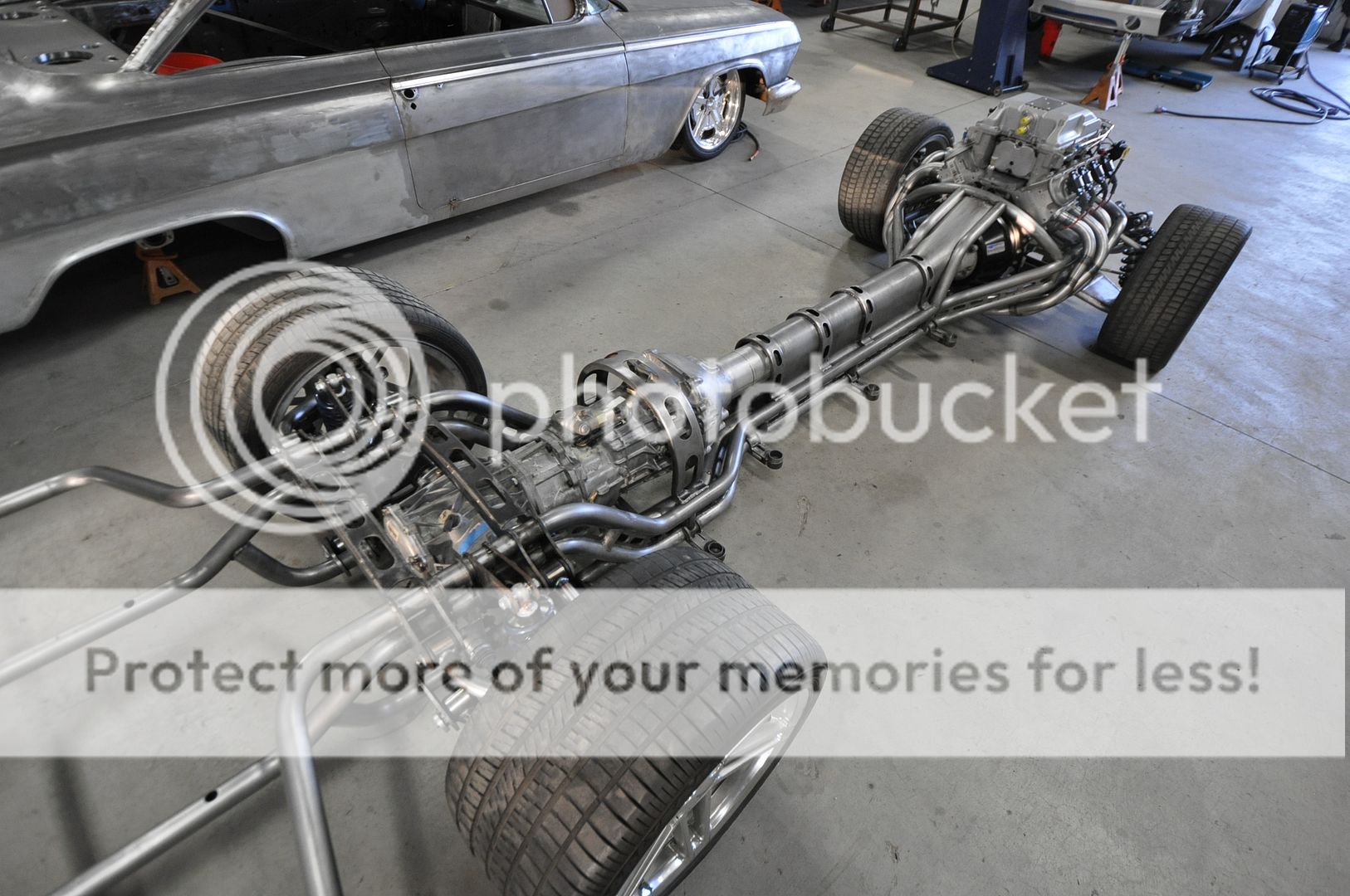

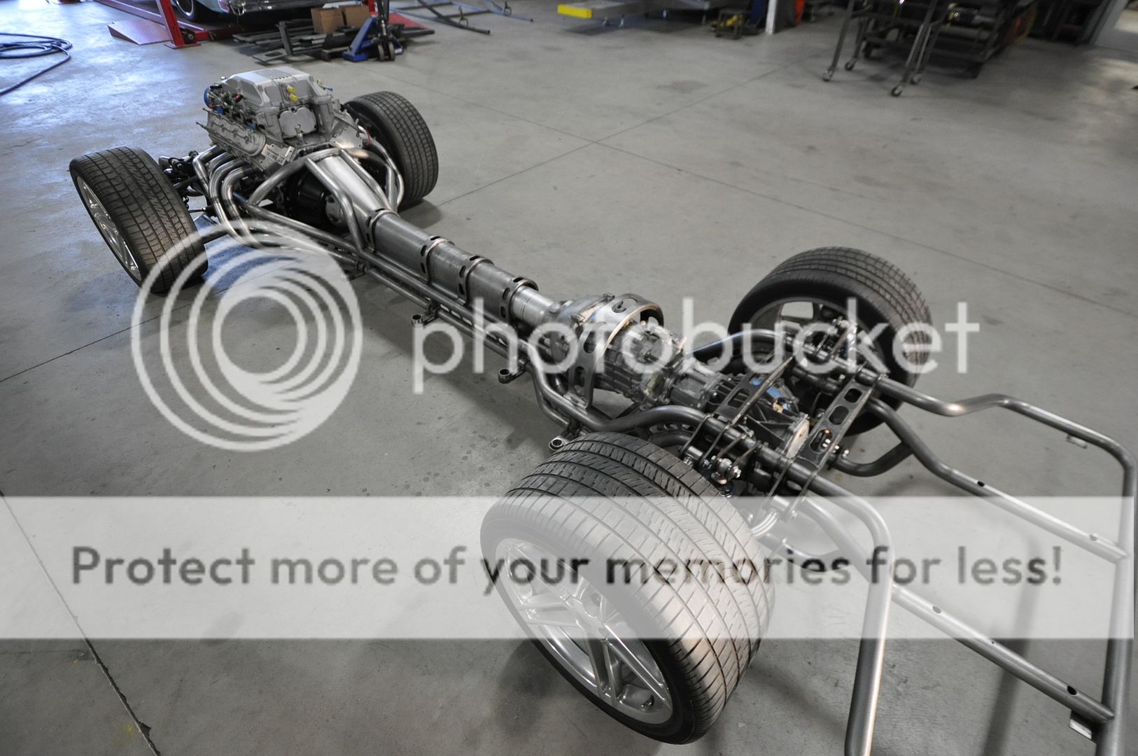

ironworks 05-17-2012 12:05 PM
Well Darrell has been bugging me to quickly get some pictures up of his chassis since he is busy feeding the cows of Southern California.
http://i616.photobucket.com/albums/t...17-2012002.jpg
http://i616.photobucket.com/albums/t...17-2012003.jpg
http://i616.photobucket.com/albums/t...17-2012004.jpg
http://i616.photobucket.com/albums/t...17-2012013.jpg
http://i616.photobucket.com/albums/t...17-2012015.jpg
http://i616.photobucket.com/albums/t...17-2012017.jpg
http://i616.photobucket.com/albums/t...17-2012018.jpg
I have the rear transaxle mount to redesign and relocate, I need to build the actual upper control arms and change the layout of the front lower control arm crossmember for the improved rack design. I had an idea for a lower brace to go under the exhaust that will be pretty bitchin.

Can we have some more details? It looks quite different than fitting a stock Corvette chassis. Start w control arms fabbed (maybe for narrow track width?) and thought behind the rear set up design.
fleet 05-17-2012 04:23 PM
Man I got a hunkerin for some of this. ;)
Great work guys...inspired. :cool:
ironworks 05-17-2012 05:00 PM
Originally Posted by Ron in SoCal (Post 414911)
Yee-oow that is slick Ra-ja! :thumbsup:
It's a tube chassis we designed with Eric Turner as we also built one for under his 62 Nova car also. Lengthen torque tube, LSA engine, 6 speed transaxle, Custom built exhaust, all under a 67 Nova and pretty close to the same under Eric's 62 nova also.
It just fabrication. Anything beyond that your going to have to ask.
Darrell has been an awesome customer to work with and I'm just glad to see him blown away every time he sees the the car. He has spent more money then he ever thought and still gets up early to go work to earn the money to see this project through. I'm sure he gets out of bed a little quicker after seeing the project like he does every few weeks. Here is a picture from the time Jason was referring to a few posts ago when Darrell first saw the car on the ground for the first time a few months ago. He was pretty blown away to say the least.
