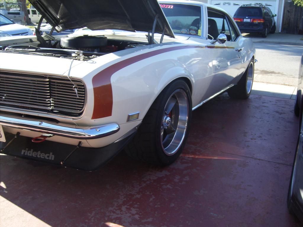

onevoice 11-30-2013 08:08 AM
Originally Posted by Rod P (Post 519592)
Thanks for the response. This first picture is a good example of why the saying is true, it is worth a thousand words. The rear of the fenderwell that is visible and bent, is why many people get nervous at just taking someone else's experience as gospel. It works for you, and that is ok, but for many with already painted cars including myself, that is just not going to work. I'm not racing the car anymore, it has a stupid expensive paintjob that took an insane amount of time, and a difficult to match color. Inner wheelwell work is fine, bending the outer fender is not.
So maybe the person above who said it can't be done is not so far off, depending on their criteria, ie no cutting. Especially if they were talking about 10" rims, ie 0.5" wider than yours, all added to the outside.
For 67-8's, a common fitting combination for many years has been an approximately 25.5" to 25.6" tall, 245 section tire on an 8" rim with 4.5" to 4.75" of backspacing. It usually fits with only minor rubbing at most. The truturn mod, using 5.75" of backspace, adds an additional 1.0" to 1.25" to the inner part of the rim, and the 275 tire adds an equal amount, also all added to the inside. Now you are up to 9.0 to 9.25" of total rim width. Adding the extra .75 to 1.0" to get to 10" total now has to all be added to the outer part of the rim, and this is where the fender problems start.
I run 1.2-1.5 degrees camber(daily driven), my inner fender well is modified as shown in my build thread after the car was painted, I did it with a cool $19.95 harbor freight brake and scrap aluminum
http://i752.photobucket.com/albums/x...ps21f583bf.jpg
hope it all helps
Another good picture. I wish ridetech had documented the 48hr build with pictures of the inner and outer fender modifications. They kind of skipped over some important parts like the front fender mods (and the minitub). I know Bret says it is no big deal, and it isn't if you are in the build phase and you have wheels and tires to try, but if you are looking at modifying a built car, it could really help people make tire choices.
Also note that your 1.5 degrees of neg camber helps fender clearance by moving the top of the tire inward, but is probably more than a street only car looking for long tire life is going to want. An autocross only first gen camaro can use as much as 6 degrees negative. With that much you might get away with a 285 or 295.

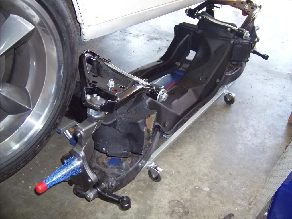

ok I did the fender mod a few months back and its not the most awesome one out there but its simple and I hope it helps you guys some
heres the car at ride height
http://i752.photobucket.com/albums/x...psf0949fe1.jpg

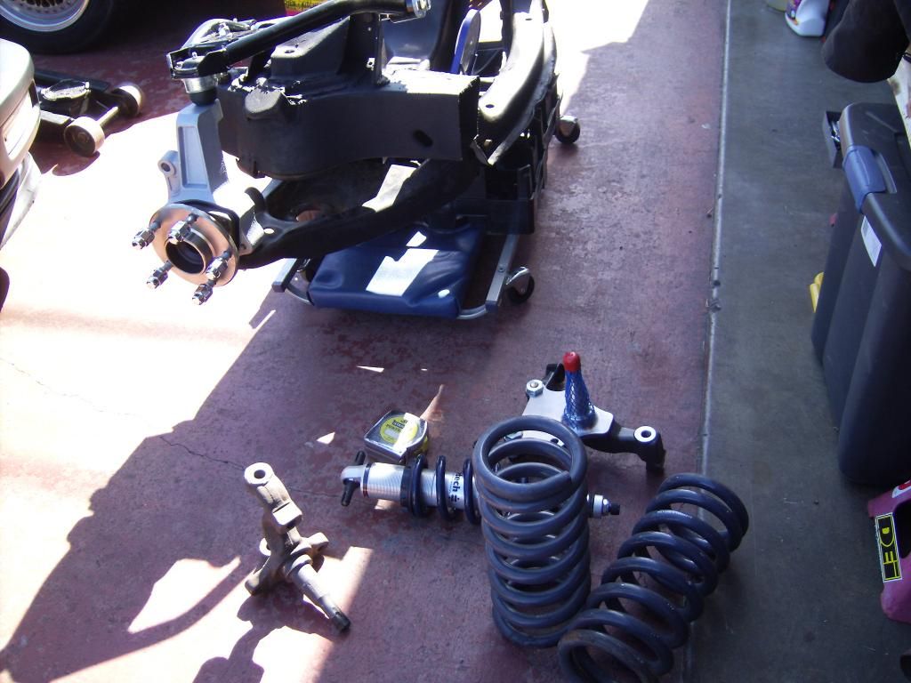

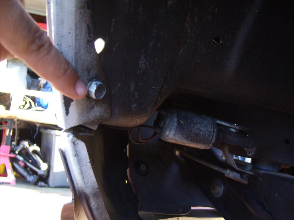

remove the inner fender bolts all the way around
http://i752.photobucket.com/albums/x...ps62528fe5.jpg
just leave the front one for now
http://i752.photobucket.com/albums/x...ps08963a51.jpg
and the lower rear will need a small button head when your done or you can leave it out if you want
http://i752.photobucket.com/albums/x...pscf2f6e55.jpg

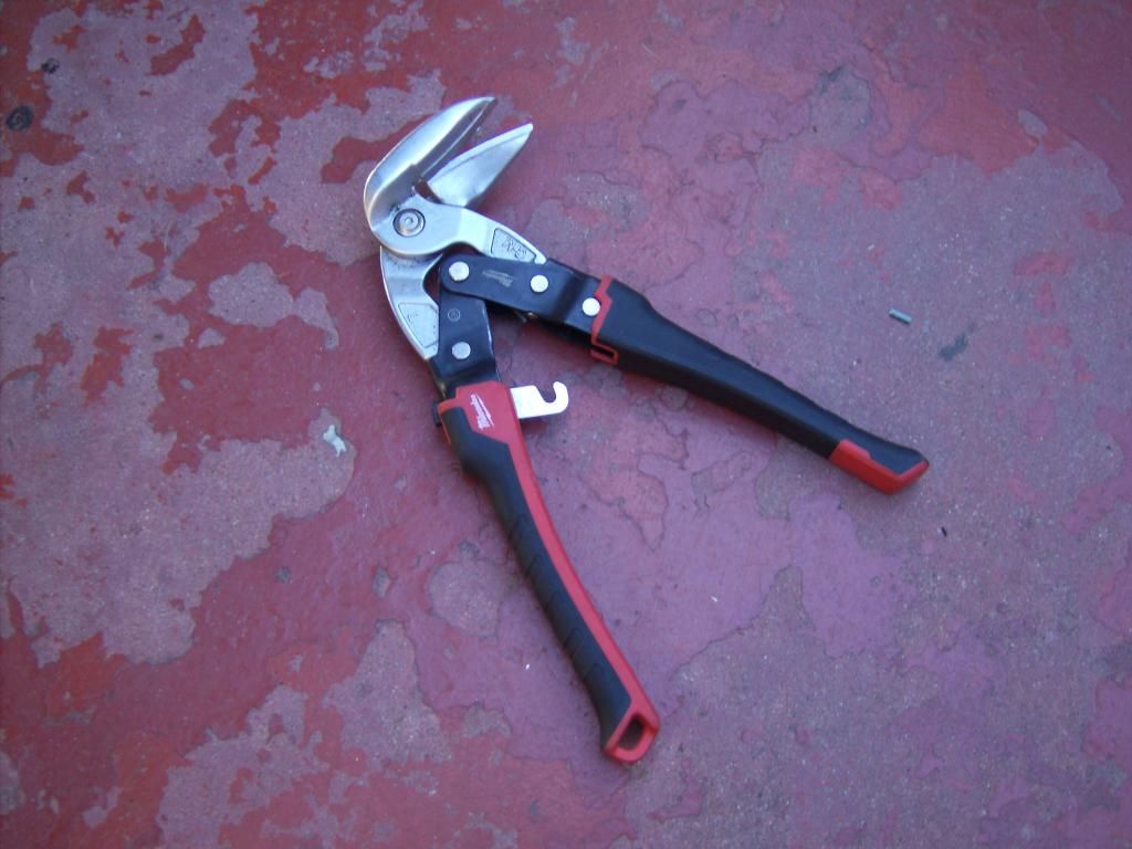

you need a couple of these and some strong forearms or cut it the way you want
http://i752.photobucket.com/albums/x...psc198182c.jpg

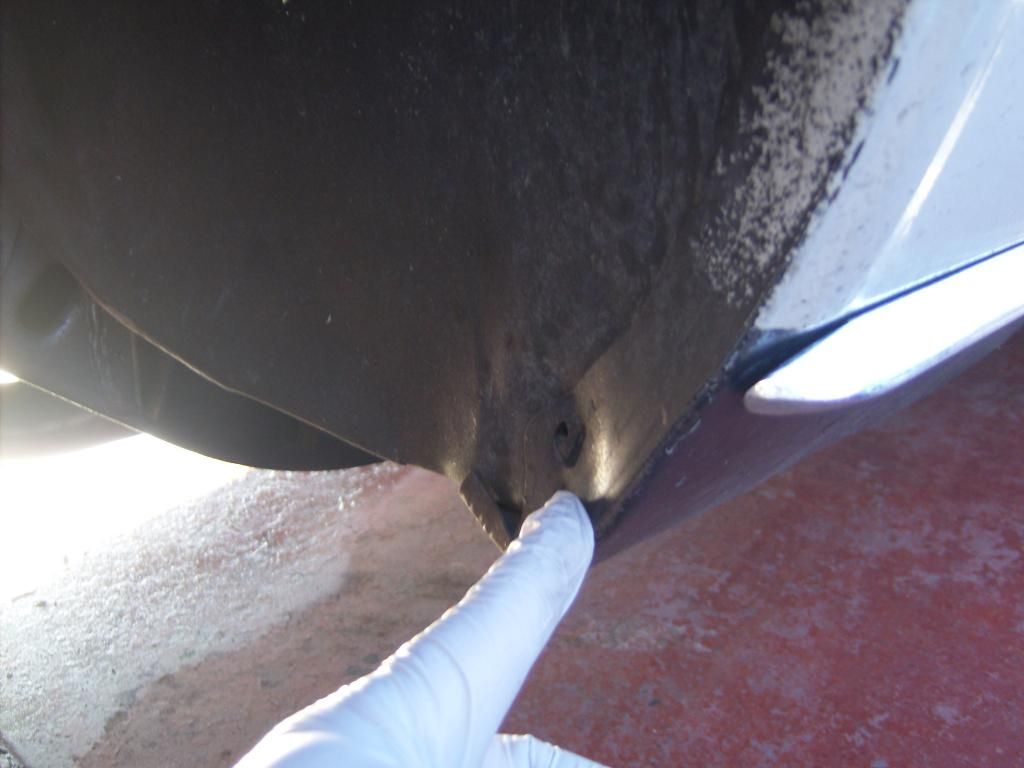

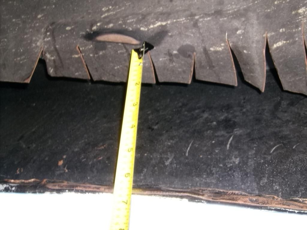

you can see were it rubs or just measure the center of the fenderwell and measure 16" x 7" rectangle these are my favs for basic trimming
http://i752.photobucket.com/albums/x...psf93c926e.jpg
drill a hole and start trimming,,,,,
http://i752.photobucket.com/albums/x...ps3eb701a1.jpg

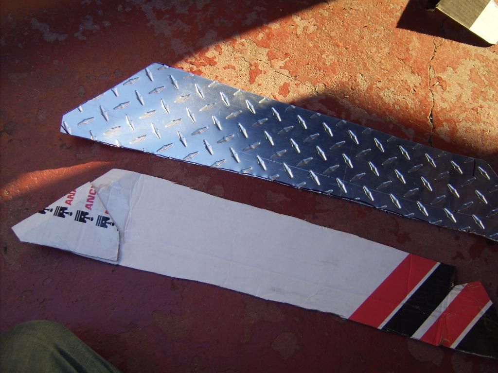

instead of an empty hole I left half of the tin in place and bent it backwards to hold the wires and hoses between it and the fenders here is how the hole looks after trimming and rolling the fender edge, see 16 inches
http://i752.photobucket.com/albums/x...ps503b4532.jpg
heres the 7 inch measurement
http://i752.photobucket.com/albums/x...pse3c38847.jpg
then I made a simple card board filler patch template
http://i752.photobucket.com/albums/x...ps270b8221.jpg
the transferred to a thin aluminum diamond plate
http://i752.photobucket.com/albums/x...psf34f8081.jpg
bend it to fit the original template
http://i752.photobucket.com/albums/x...ps007c1936.jpg
and the I fitted it back into the opening
http://i752.photobucket.com/albums/x...psb670764a.jpg
that's it!! when I replace the inner fender wells with fiber glass ones I will just mod those before I put them in and wont need to have the aluminum plates any more and this mod allows a ton of roll and no rub!!!
http://i752.photobucket.com/albums/x...ps55616c55.jpg
hope this helps!!

yes keep us updated! I'm curious, I did measure an 18x10 inch rim (test fit on the car) and It looks like a 6.00 BS would be perfect, I run a 9.5 rim and I have a 5.50BS and it fits great, ok let us know

I installed the complete Ridetech coilover and tru-turn system on my '69. Prior to ordering new wheels and selling my old wheel & tires I did a test fit - (coilovers temporarily not installed) - with a 275/35/18 on 18x10 wheel with 5.75 B.S. (This wheel and tire was being used on the back of my car w/ a small spacer). I set the camber close to zero with an angle gauge. I immediately discovered that combination would not work at all unless I wanted a very high ride height - not desirable. The tire touched the top, horizontal, outer part of the fender at any where close to full lock. The fenders would have to be flared to provide clearance - not desirable. I then ordered 18x9" wheels with 5.75 B.S. and the setup looks OK with the 275 tire. My Camber is set to -0.5 deg and is about all I want to go for good tire wear. I loaned the 18x9 wheel/ tires to 2 friends that were also in the process of installing the tru-turn on their '69 Camaros. After testing, they both went with 18x9 with 6" B.S. They are able to run their Camaros about 1/4" lower than my car and are happy with that combination. A few months ago I tried lowering my car that low but then heard rubbing during parking maneuvers and discovered the paint chipped off the fender where the tire was making contact. I raised it back up 1/4" and that is as low as it can go. Also, both sides of the car have very close to the same clearance, no more than 1/8" difference.
Recently Ridetech built that high end '69 for Goodguys and used an 18x10 on the front but I have no idea how they made it fit, or if they run lots of negative camber, or how much backspacing they used. Will they be able to leave it at that height and really drive it on city streets, parking lots, fields, etc?
