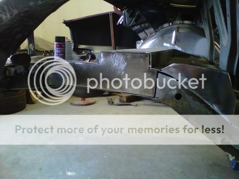

Hey Michael/Kev - I was also concerned about how little frame rail was left after the mini tub - even though we boxed the frame rail - so we ended up putting in 1/4" steel plate on the inside of the raii. There's a pic in this post:
https://lateral-g.net/forums/show...62&postcount=3
Of course, the AME rails avoid all this...:thumbsup:

Ron ... you bent up the 1/4" steel plate or you welded a plate on the inboard side of what was left of the rail? Can't tell from those pictures.

Welcome Michael! We welded to the inboard side. I guess you could bend 1/4" steel plate, but I didn't see the need...

Michael, I couldn't get any decent pictures tonight, my camera died.
I actually cut all of the frame out just leaving the sheetmetal on the inboard side of it, and bent up a 1/4" steel plate for the close out. I still think it will be plenty strong, and I plan on boxing it in once i get the car on a rotisserie.
http://i765.photobucket.com/albums/x...1/3b26a966.jpg

the drawback for me at least, I can't use my 12 bolt. :( The upper link mounts can't be welded on a 12 bolt, so .... guess I'll sell this one and save for a nine inch housing.
Michael[/QUOTE]
It depends on what you want to do. I just bought a nine inch from DSE and the housings start around $900; or you can source one from a junk yard, the mid seventies trucks are a good place to start.
Ron ... looks like Kevin bent the 1/4" plate version. WOW, I guess there isn't much frame left. Thanks for the Pictures Kevin.
