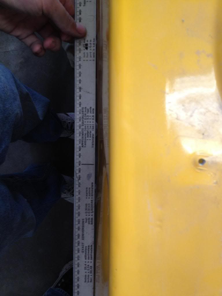

tmadden 02-20-2013 07:37 PM
Texas 69 is at Musclerodz
1 Attachment(s)

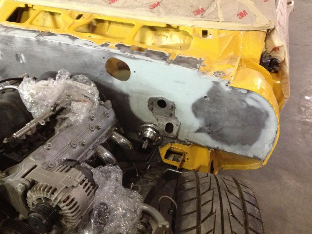

Firewall needed correcting and a few other things. Mike will finish out most of the car and get her running for me.

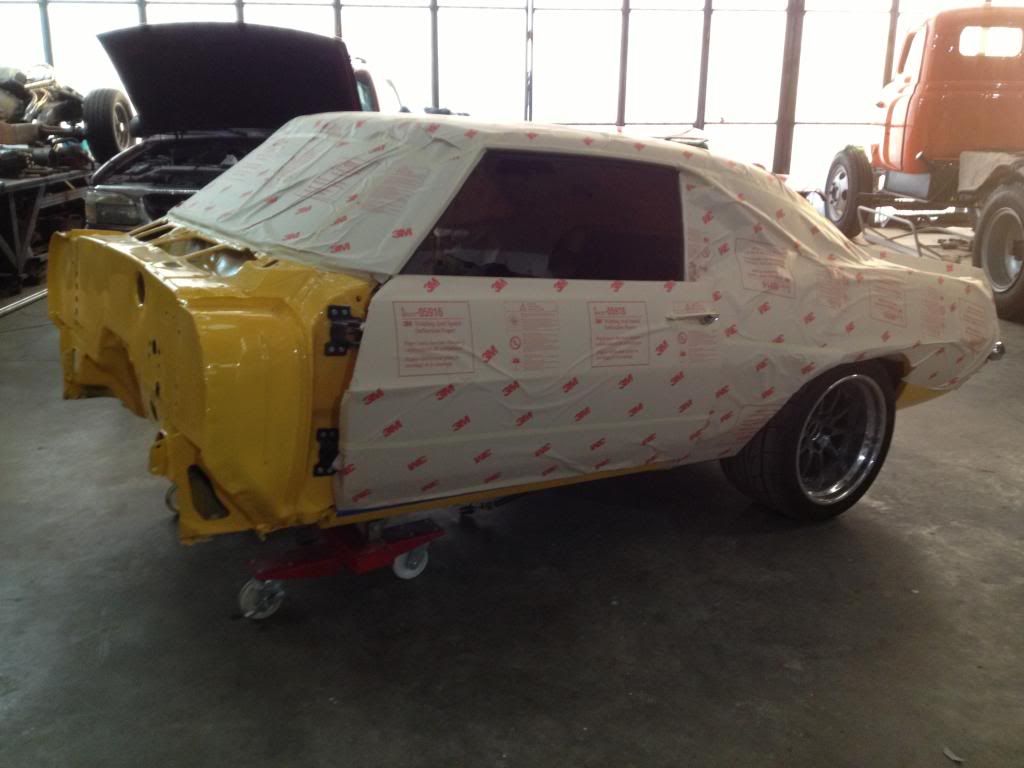

I guess it is about time I take over this thread and bring it to life. After a short trip to TX to pick it up, we got it home and started to inspect the car. After a thorough look over, it was evident that some of the previous assembly work was going to have to be redone mostly due to not ever being finished off properly, along with a couple other "iffy" things.
First item on the list was the firewall. Several issues led to the changing of it. The factory hanging points for the vintage air were gone and did not want any exposed hardware. The DBW pedal was mounted too low and would have interfered with the carpet once installed. Lastly the firewall itself had not been seam sealed before paint, it was badly warped, and looked like a sack of walnuts around the tunnel opening from a wreck many moons ago.
First thing was to protect the paint on the car by wrapping it with spark deflection paper

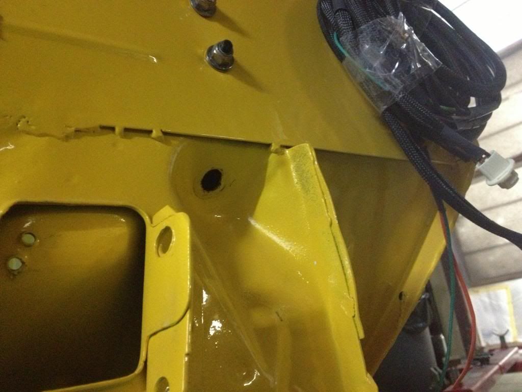

unfinished edge and not sealed
http://i1309.photobucket.com/albums/...ps10e87b33.jpg

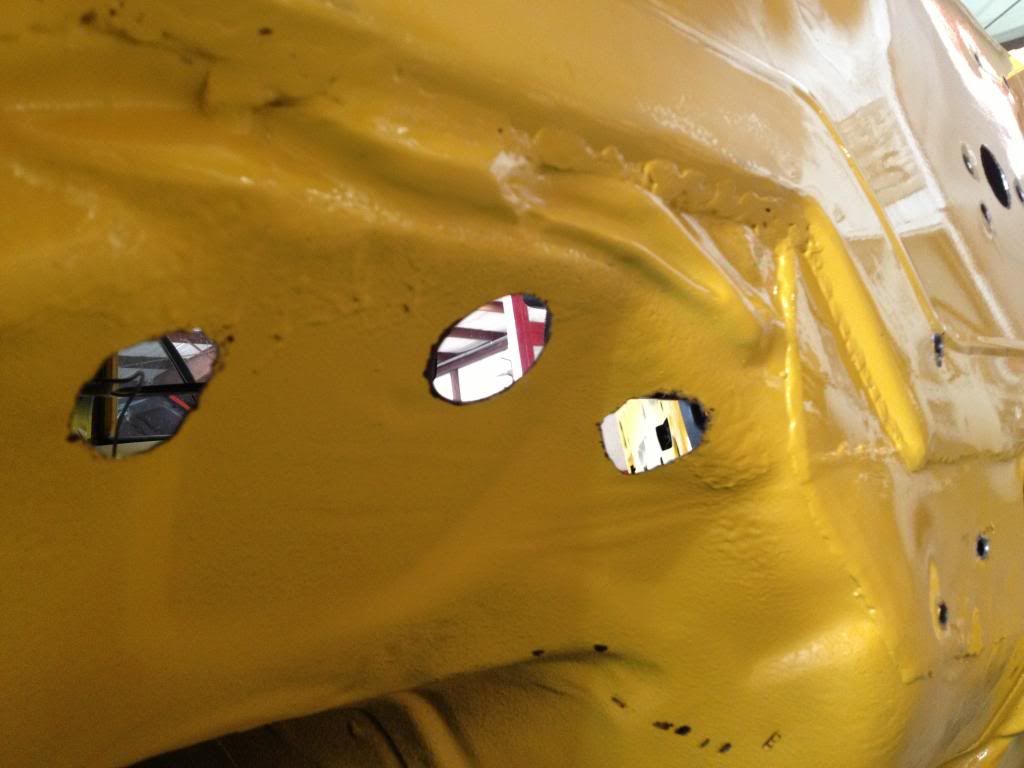

unnecessary holes and not pretty to boot
http://i1309.photobucket.com/albums/...ps1cd796cd.jpg

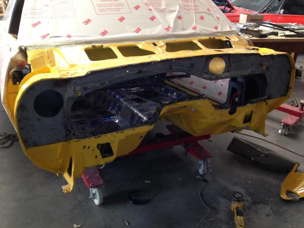

out came the firewall a little too easy only to find bare unprotected metal
http://i1309.photobucket.com/albums/...ps596115b9.jpg

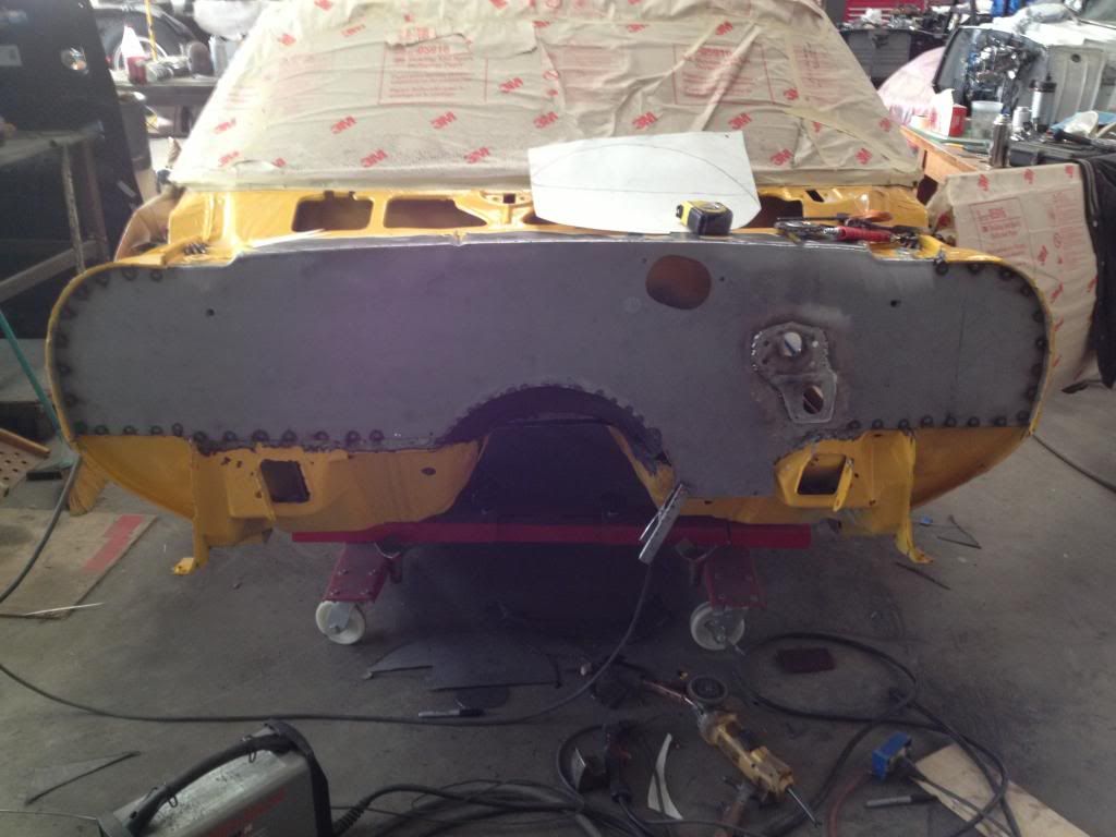

firewall and panel weld through primed, and welded in place. I also welded on the clutch cylibder bracket to further prevent flexing of the bracket
http://i1309.photobucket.com/albums/...ps3d282d0b.jpg
