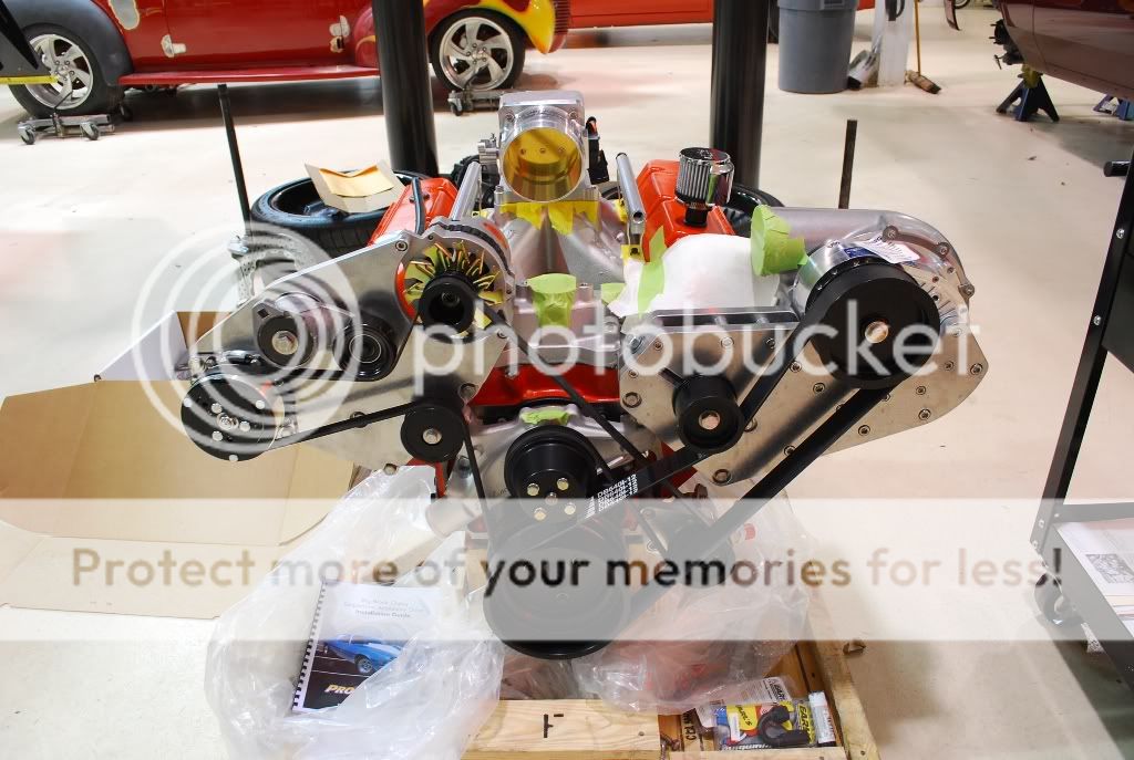

The parts have started coming in for the truck. We went with a 572 with a F2 Pro Charger and EFI. We are shooting for 700 - 800 HP while retaining good drivability. We are figuring that this burban should end up tipping the scales close to 5,000 lbs so it will need some muscle to get it going.
http://i563.photobucket.com/albums/s...ture220432.jpg

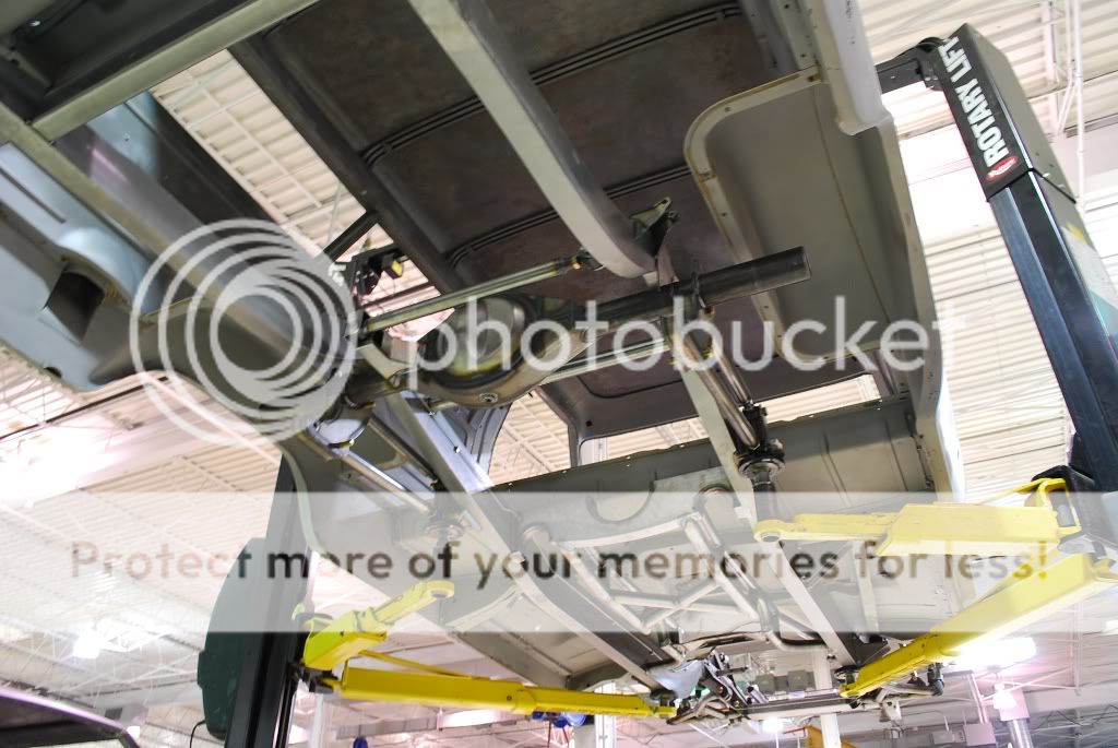

The chassis is also just about wrapped up. Just waiting on a sway bar and a few other small parts.
http://i563.photobucket.com/albums/s...ture220910.jpg
http://i563.photobucket.com/albums/s...ture220901.jpg
http://i563.photobucket.com/albums/s...ture220900.jpg
214Chevy 01-11-2012 06:20 PM
Looking good guys. :thumbsup: What are the arches or loops in the round tubing support/structure bars behind the tranny mount?
Roadster Shop 01-11-2012 06:40 PM
Those are put in so we can run a crossover H pipe in the exhaust.

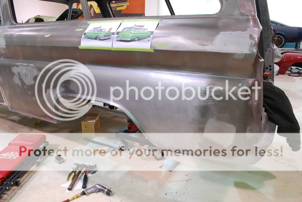

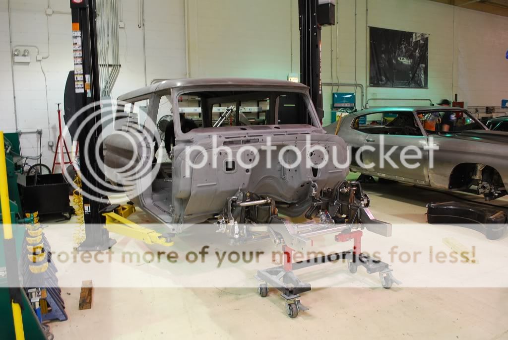

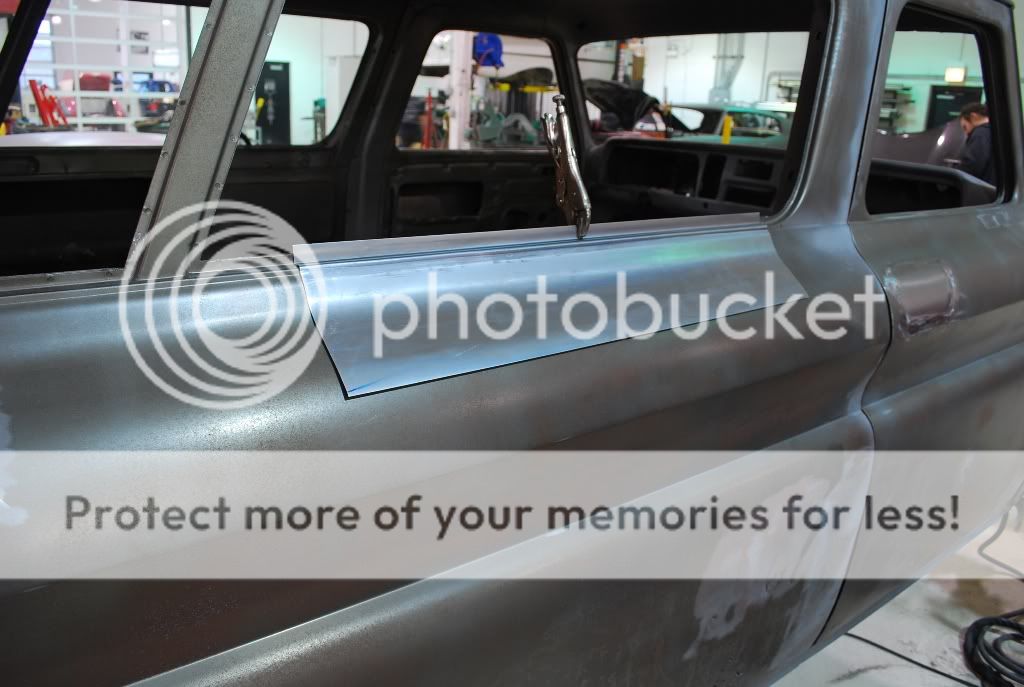

Once back from being blasted, we mounted the body to the chassis and began the metal work. This was a pretty solid truck, but still had a few issues here and there. A lot of the standard stuff like bottoms of fenders, rockers and a few pin holes around the truck.
http://i563.photobucket.com/albums/s...ture220935.jpg
http://i563.photobucket.com/albums/s...ture220948.jpg

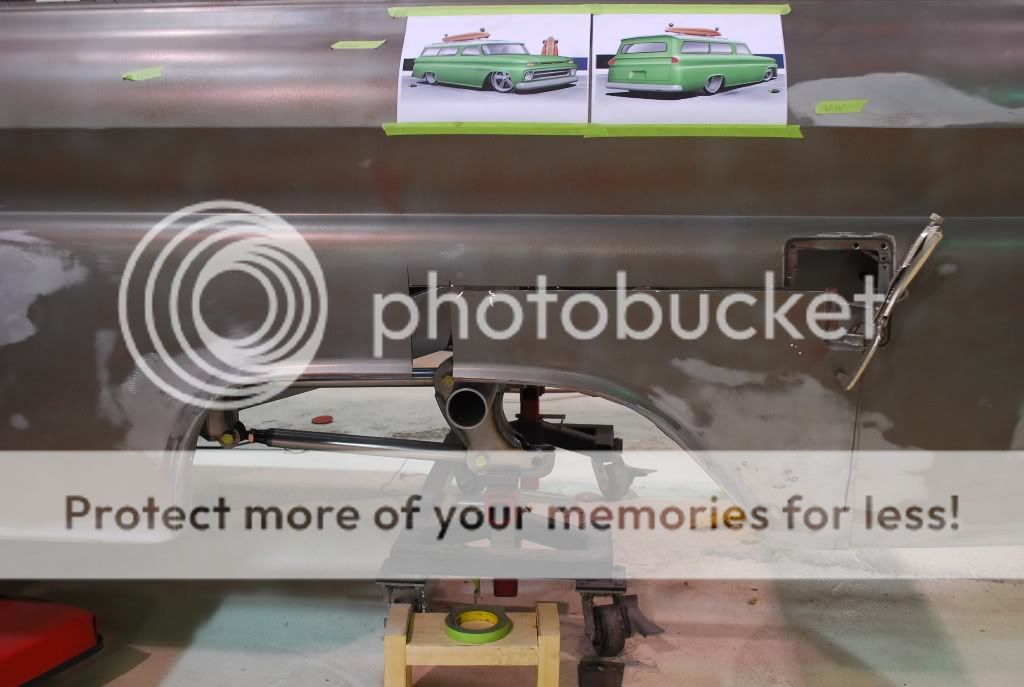

The driver's side needed a new lower fender section, door skin, floor section where it meets the rockers, and a few small rust areas in the quarter.
http://i563.photobucket.com/albums/s...ture221115.jpg

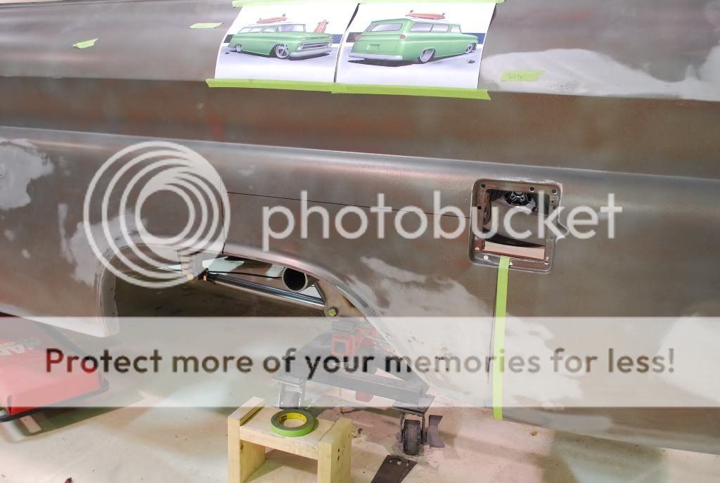

We also decided to widen the rear wheel opening so the 24" tire looked right.
http://i563.photobucket.com/albums/s...ture221107.jpg
http://i563.photobucket.com/albums/s...ture221123.jpg
http://i563.photobucket.com/albums/s...ture221229.jpg

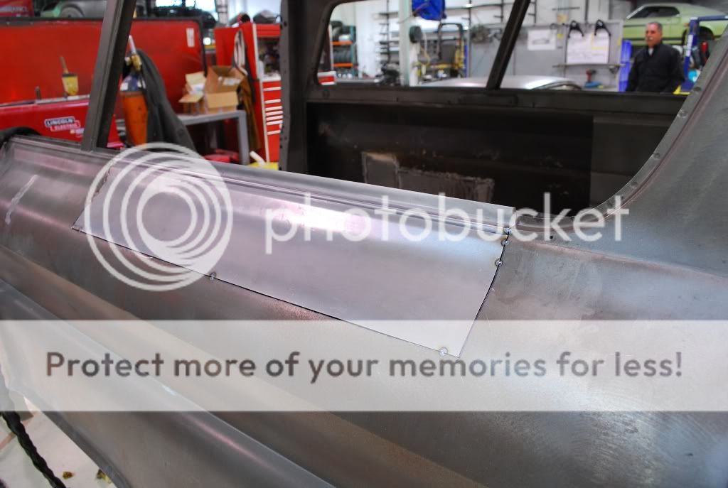

The passenger side needed about the same work. A little more in the quarters where there must have been a leaking window that caused a lot of pin holes in the top of the quarter. This is a prime example of why we take cars down to bare metal. The previous restoration used spray foam to fill up the pinholes from the inside and was then painted over. We never would have know unless the car was taken down to bar metal.
http://i563.photobucket.com/albums/s...ture221134.jpg
Once the metal was cut out, we found all of this Great Stuff Foam.
http://i563.photobucket.com/albums/s...ture221358.jpg
New panel tacked in place ready for final welding and metal finishing.
http://i563.photobucket.com/albums/s...ture221398.jpg

The engine that is going to power this beast! a 572 with a F2 Pro-Charger looking to make 800 - 900 HP.
http://i563.photobucket.com/albums/s...ture221378.jpg
