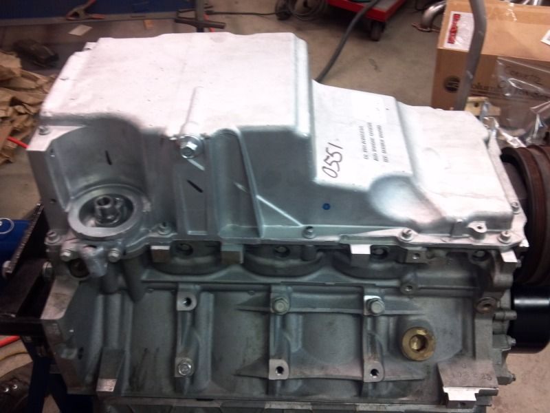

The only thing I knew for sure I would have to do is change the corvette pan out for an F-Body pan. After searching many sources for used, I got a great deal on a new kit from Pace Performance. Everything needed for the switch:
http://i140.photobucket.com/albums/r...-10-48_867.jpg
http://i140.photobucket.com/albums/r...-24-26_668.jpg
http://i140.photobucket.com/albums/r...-24-11_586.jpg

I got it all back together and and built a pre-luber to get it all lubed up before firing it after sitting so long. Worked great! 60 psi of pressure while we rotated it by hand. Fired up with minimal noise and quieted right up in seconds.
http://i140.photobucket.com/albums/r...-01-56_936.jpg
http://i140.photobucket.com/albums/r...-01-20_617.jpg
