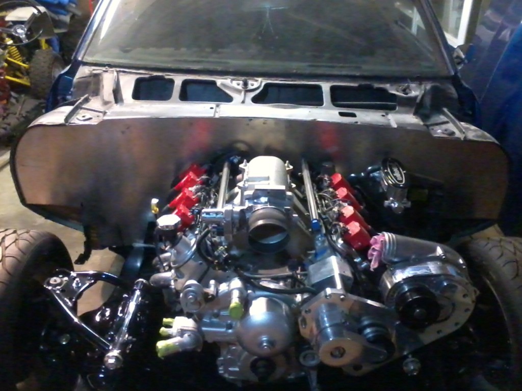

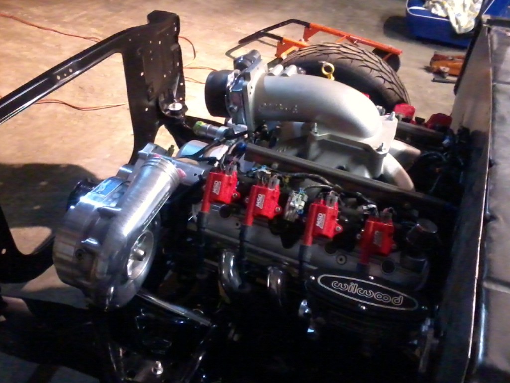

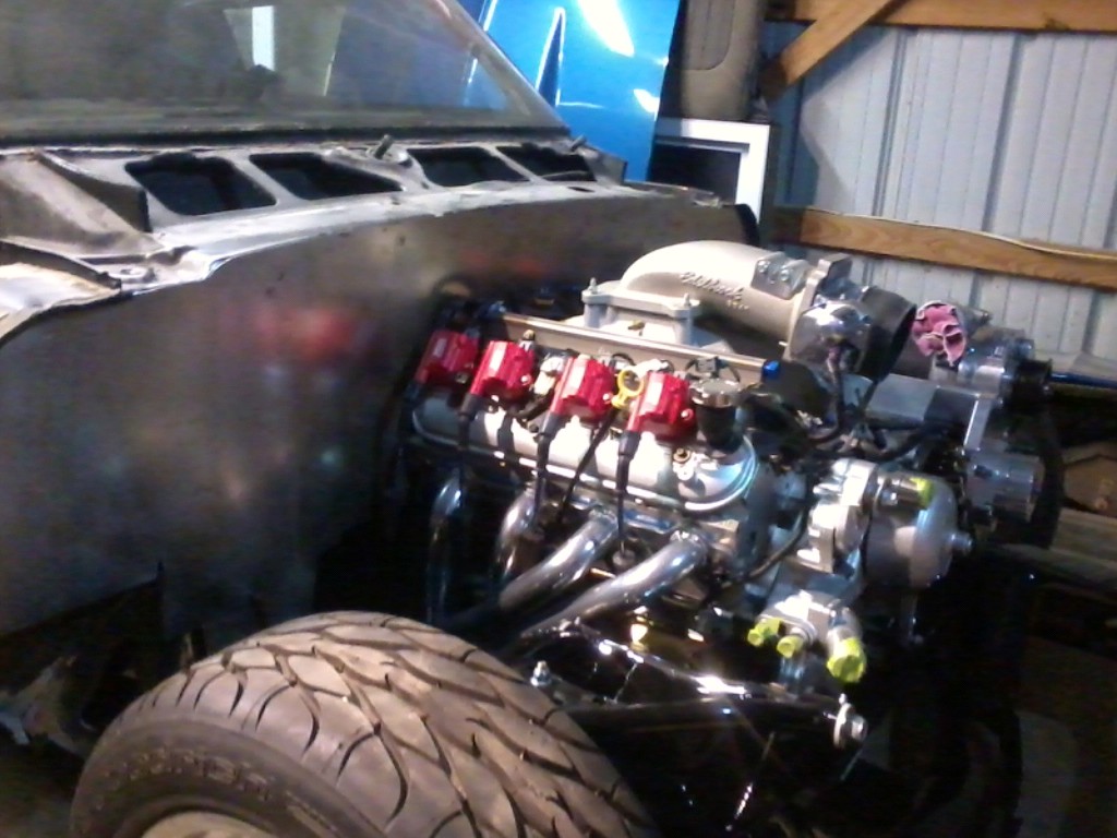

Hey guys, just thought i would drop a few pics on here. I have a 68 Camaro i have had for ten years. I decided to do a forged ls2 d1 procharged swap with a 6 speed. I also decided to lower the car with 3 inch hotchkis springs up front and 3 inch DSE drop leaf springs in the rears. I also added a hotchkis sway bar and did the ls1 brake conversion. Along the way, i also did the common Iroc performance gear box swap. I have a pic of my car before i tore it apart. It has the standard grill but i purchased a billet rs grill and the DSE electric door conversion... thanks for looking

More pics. I have a le mans gas cap in store. Also threw in a few more pics of the engine and frame. I did a concept drawing on paint lol . turned out sweet. My girl friend bought me some sequential digitails. Gotta give her some credit... she knows exactly what to get a car guy for christmas lol. Oh yeah there's a pic of my trans am. The day i threw a rod. :( She is still sitting. Need to find some time to swap the engine, along with building this car.

Its the gto bracket. IM going to have issues with the head unit hitting the control arm. IM going to make some spacers/brackets.
96z28ss 02-19-2012 10:30 AM
I had originally used the gto bracket also. It just isn't a good bracket for the 1st gens. The Corvette bracket is much better. You also have to modify the inner fender too much. You also lose turning radius cause the wheel will hit the modified inner.
I think im going to put some spacers in between the bracket and the block to move it forward and have a pulley made or make a spacer for between the crank and the pulley. Or make a bracket to move the entire set up north a few inches to clear suspension and a arm

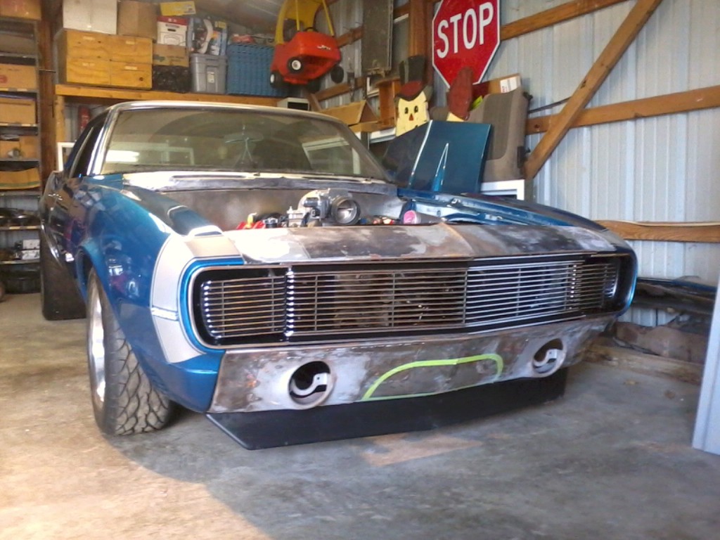

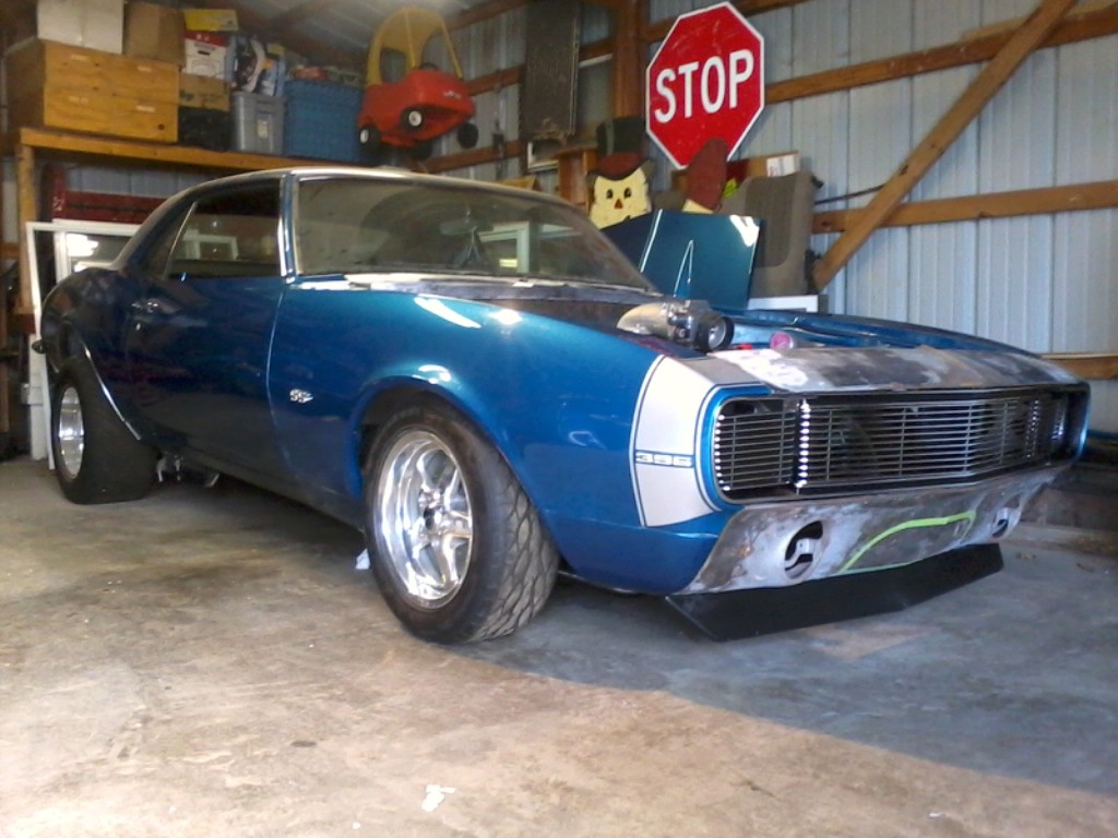

MOcking up everything...
Rs billet grille, custom valance, etc

I cut the holes in the inner fenders for the intercooler pipes
