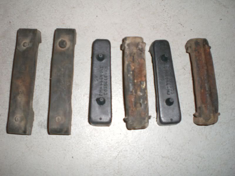

My Ron Davis Radiator doesn't sit right in his upper mounts in the upper radiator support ....
http://img813.imageshack.us/img813/9517/img0505aj.jpg
http://img26.imageshack.us/img26/7591/img0506xe.jpg
I bought it from TA Performance, so it should have sits in a Buick ! :(

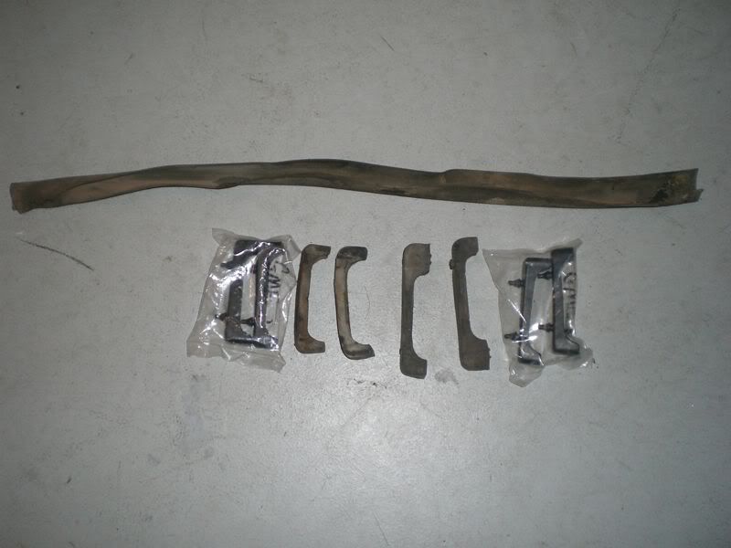

Roadbuster 04-25-2012 01:32 PM
Originally Posted by Macbuick (Post 408991)
So i started to work again on the Buick, but things can't always go right !
Looks like you need different rubber isolators. Here are some that I bought and what came with my 68 GTO.
http://i232.photobucket.com/albums/e...r/CIMG0889.jpg
http://i232.photobucket.com/albums/e...r/CIMG0887.jpg
Looks like you need the long ones with the big openings which I cannot find.
Love the new garage! Great work space!
Macbuick 04-25-2012 11:31 PM
In fact one of the lower rubber had moved and that why the radiator was not in the right place...
I didn't noticed it whan bolting the upper bracket :rolleyes:
My rubber are right ;) I wanted to replace them but they where out of stock by TA Performance (Buick specialist), i will check on my El Camino if chevys are the same.
Thanks anyway for your help !!
