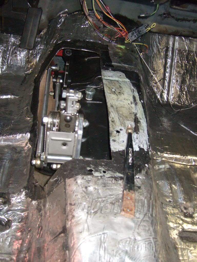

I was looking at a Tex T101A but the shift linkage kills me for clearance...
Flash68 03-24-2012 05:33 PM
Originally Posted by badmatt (Post 403520)
I need to find something soon... My SB2 is itchin to be put in.. and beat on.
Matt, what are the details on your car and motor? I almost went with SB2 stuff myself... curious to see what you're doing.
The linkage room needed for my car wasn't that bad really.

Truck is a 97 Sonoma that has been de-airbagged now rides on coil overs all around with a 3 link. ill be reposting a build thread soon.
motor is a strait RCR built motor one of D. Laurences pet motors. made roughly 830 hp. winds to 9800rpm i can post up a pic if you like?
how far does the linkage protrude from the side of the trans?

http://i236.photobucket.com/albums/f...8/DSCF3505.jpg
http://i236.photobucket.com/albums/f...8/DSCF3504.jpg

Looks like I can make a T101A work.. *hits ebay*
mostly street....:unibrow:

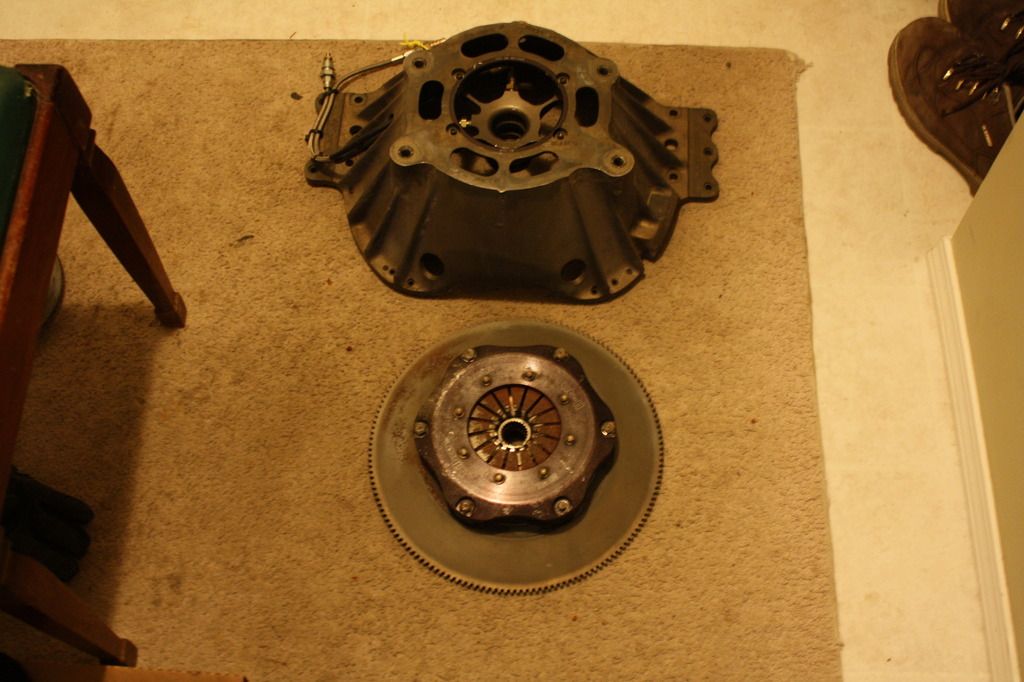

pic of it all together before I pulled it apart for inspection and a new pair of lifters.
http://img.photobucket.com/albums/v3...t/P1011082.jpg
Bell housing and clutch.
http://img.photobucket.com/albums/v3...t/IMG_2060.jpg
