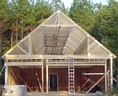

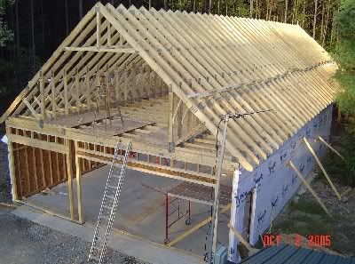

shanekennedy 03-02-2006 06:29 AM
-30x50 garage w/ attached 30x30 carport w/ 16x80 attic
-single bay is 2 cars deep w/ 10x10 paint/finish/clean room behind the 2nd car
no electrical switches/outlets in finish room. lights are recessed above plexiglass. unsure how i want to vent the room yet.
-behind the double bay is a 35x20 workshop.
-behind the garage is the carport
-attic space above will be storage & eventually a couple of bedrooms
-walls are 10' tall to allow room to maneuver 8' lumber & add 2post car lift. added extra 4" of footing under pad for car lift.
-plumbing for air tools throughout
-air compressor & vacuum system for wood tools are enclosed under stairway so i don't have to hear them.
-lots of lighting
http://i49.photobucket.com/albums/f2...ne/garage2.jpg
http://i49.photobucket.com/albums/f2...ne/garage1.jpg

Very Nice Shane :thumbsup: :hail: . I'll have to stop by sometime and check it out.
shanekennedy 03-02-2006 07:10 AM
stop by one saturday & you can help w/ construction :). it's been a do-it-yourself project going on 6 months now.
