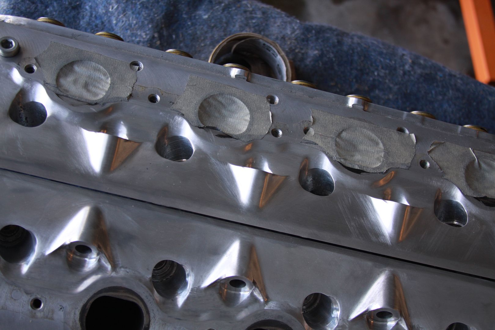

Guys here is pic of the heads getting smoothed. Do I need to make sure that any sand scratches are totally removed or will the primer fill them in?

elitecustombody 05-06-2012 04:38 PM
I would media blast if all possible or get it hot tanked. I like using Sherwin Williams GBP 988 etching primer in aerosol before paint. And yes, automotive paint will hold up just fine on the block, can't say that for the heads.They will need high-temp paint.
Al Moreno 05-06-2012 08:03 PM
Originally Posted by ratman67 (Post 412434)
the primer will fill them, and you want some scratches to get some physical adhesion. use a self etching primer first for adhesion then a conventional primer, to fill any scratches, finish with 220 grit then your paint system...
Thanks for the input guys! Prior to using the etching primer, what grit would you recommend to used to go over the bare aluminum to create some bite?
elitecustombody 05-06-2012 09:23 PM
180 grit before primer.Do not load on bunch of material,be it primer,paint or clear,it will only create problems.
