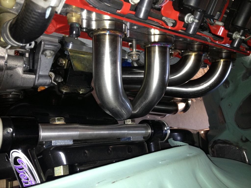

frankv11 10-20-2012 01:18 PM
dse header fitment issues
ordered these about 2 1/2 months ago , finally got them yesterday and they are a piece of art but driver side does not fit it hits the shock tower on dse sub, I've double checked pinion angle , engine center to sub,etc. running all DSE complete sub w engine mounts
so as you can see in the pick, just mocked to check fitment , no gasket but it hits sub and does not allow to sit flush to heads its off by quite a bit. any one had this experience or any ideas on the cause besides defect.
http://i1232.photobucket.com/albums/...1/photo4-2.jpg
frankv11 10-20-2012 01:22 PM
another anglehttp://i1232.photobucket.com/albums/...1/photo2-2.jpg
Musclerodz 10-20-2012 06:50 PM
Originally Posted by frankv11 (Post 442026)
Do you have the 060404 mount kit? It sets the motor back and required with their headers.
frankv11 10-20-2012 07:01 PM
Yeah i'm Using they're ls motor mounts. Have to call them on mon
frankv11 10-25-2012 09:36 PM
I got 060401 mounts , when I ordered sub assembly and LS mounts they never mentioned that I would need 060404 if I wanted to use they're headers, was not aware of two different Ls motor mount options for they're sub.
So now the trans tunnel , built in trans cross member , drive shaft, fire wall etc was built around these dimensions, I can not just swap mounts , and don't want to cut up $2500 headers $&@@$$&@@ I'm kind of in *^%# up position.
