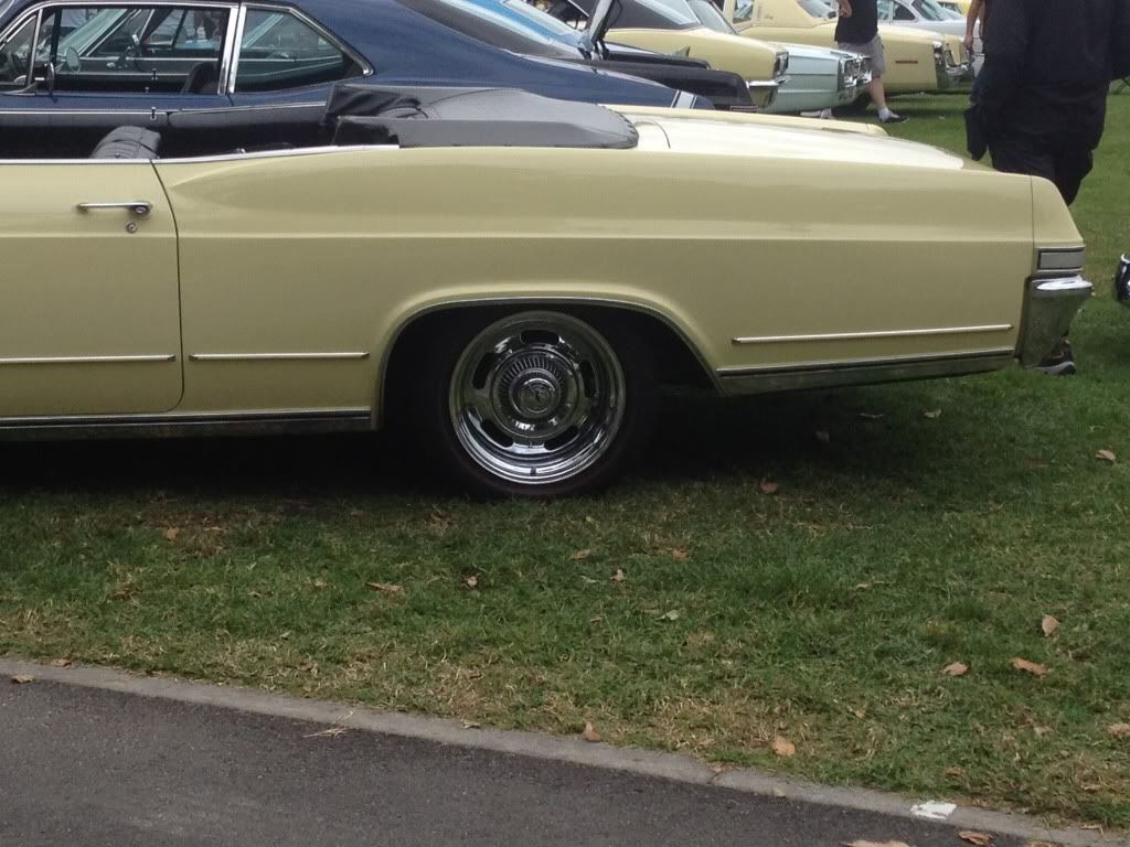

Thumpt 06-06-2012 04:48 AM
Well my new wheels and tires arrived and will be trial fitted to my car in a couple of weeks and i will post up a couple of pics then.
This at a recent car show in Melbourne.
http://i1128.photobucket.com/albums/...rtible/002.jpg
