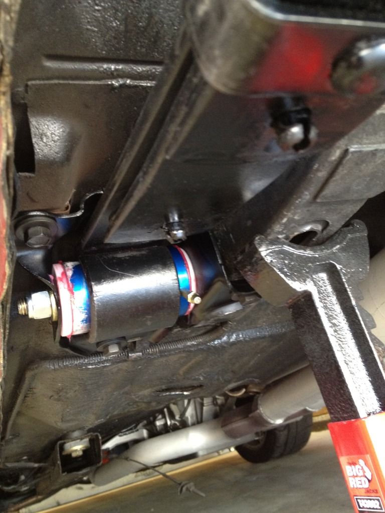

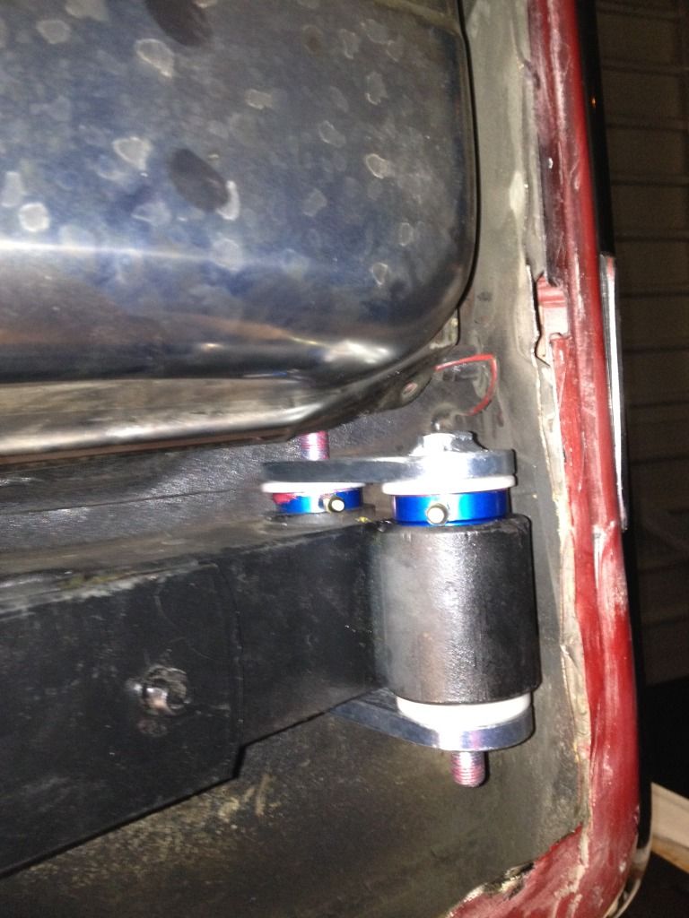

Here are pics of the reverse eye spring. Also, one side pic of the rear. I'll get some full profile shots tonight. I pulled the old subframe connectors out and got the new GW subrames in last night. Had to cut and reweld them to get them to sit up close to the floor.
[IMG]http://i1122.photobucket.com/albums/...A/photo2-4.jpg[/IMG]
[IMG]http://i1122.photobucket.com/albums/...A/photo1-4.jpg[/IMG]
[IMG]http://i1122.photobucket.com/albums/...A/photo3-2.jpg[/IMG]
