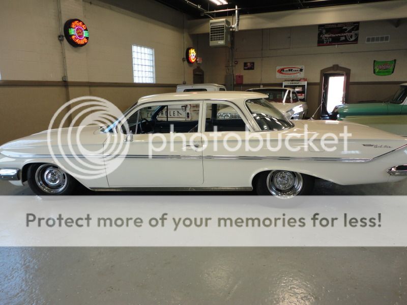

http://i590.photobucket.com/albums/s...6/2012/032.jpg
