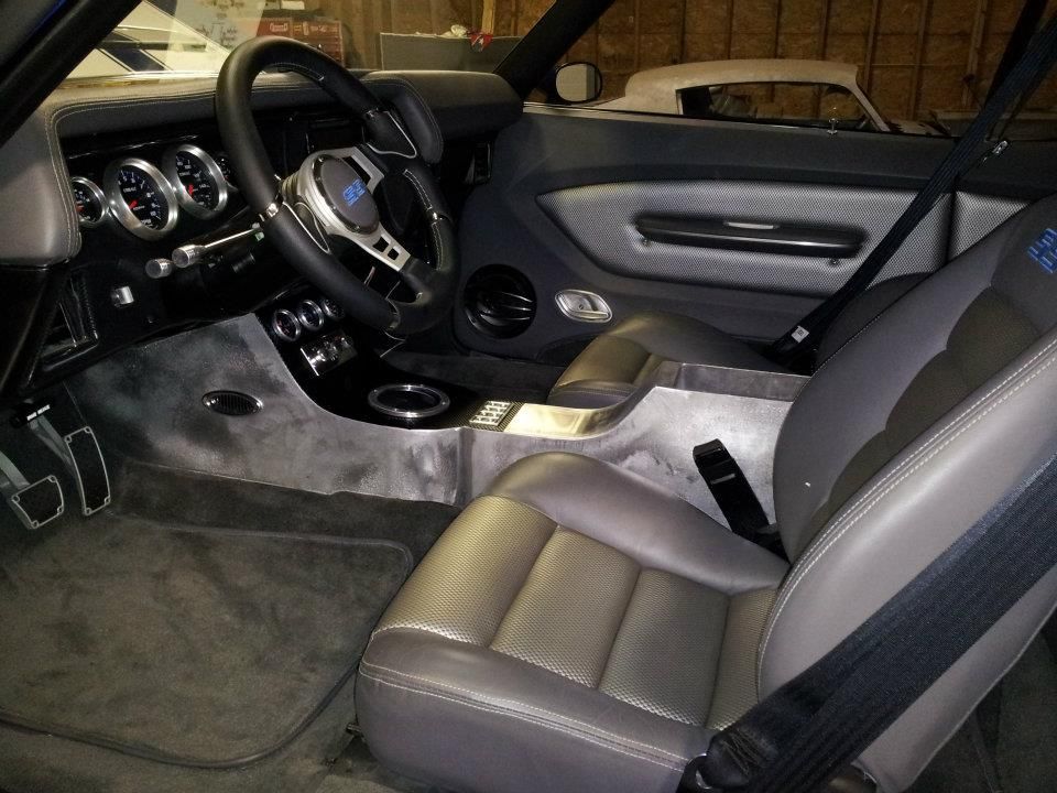

Fitment on the T56 required a decent amount of mods in the 70 Chevelle we installed it in. Required a custom console as well. Still very hapoy with the results.
http://img.photobucket.com/albums/v2...86053442_n.jpg
