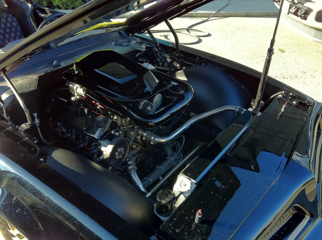

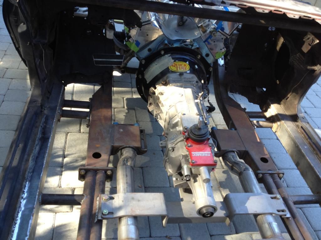

Engine and transmission finally getting fitted to the car. It looks like the engine will need to go back into the firewall several inches so it can drop in back of the rack and pinion. More work but it should help with the handling a bit. The transmission crossmember is going to have to move back a few inches as well.
http://i213.photobucket.com/albums/c...0Black/897.jpg
http://i213.photobucket.com/albums/c...20Black/94.jpg
http://i213.photobucket.com/albums/c...20Black/95.jpg
[IMG]http://i213.photobucket.com/albums/cc231/dcamburn/1979%20Trans%20Am%20-%20Black/784

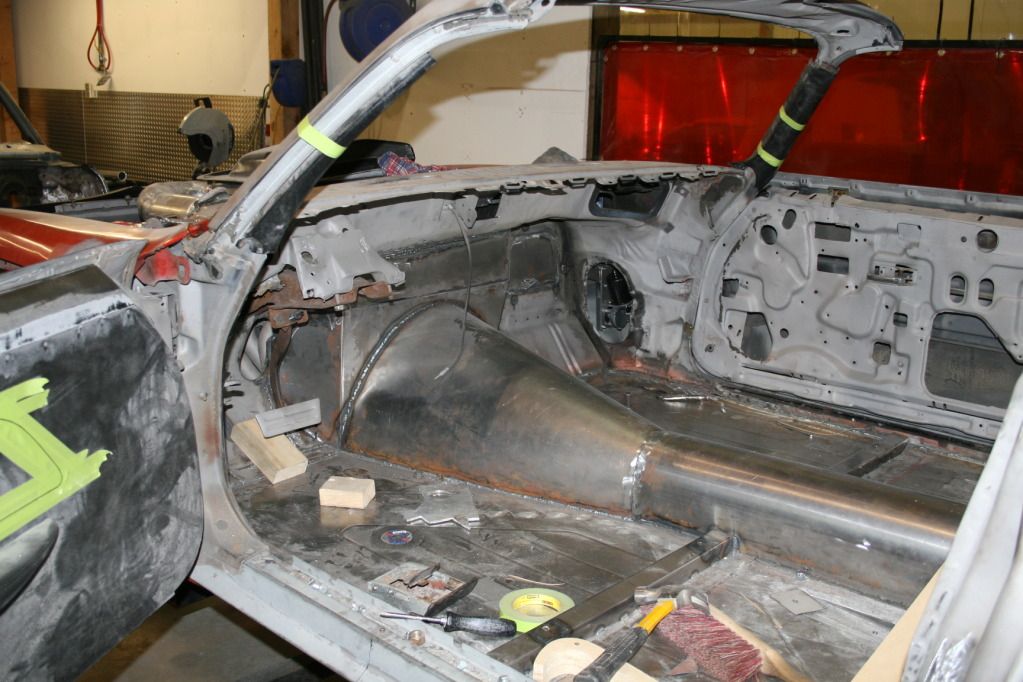

Well, as with all such projects, this one is taking a long and winding road to get to completion. The car is back at my home now as Chad was unable to finish the car. Took it to Dan Holohan for an assessment and he gave me the unvarnished truth. Basically, I have a lot of really cool parts and a lot of problems to solve.
So at first I decided to just sell it off for parts and start over but since then I have had a change of heart and decided to do this as a general contractor type job. I'll sub out the stuff I don't feel comfortable doing and do the rest myself.
Here are some "as it sits" photos...
http://i213.photobucket.com/albums/c...k/IMG_0862.jpg
http://i213.photobucket.com/albums/c...k/IMG_0880.jpg
http://i213.photobucket.com/albums/c...k/IMG_0873.jpg
http://i213.photobucket.com/albums/c...k/IMG_0872.jpg
One of Dan's suggestions that I liked was to make this a full frame car so the body can be removed in order to powdercoat the chassis. I'll get rid of the round tube stuff that was added in which I highlighted in the large blue oval and tie the front and back chassis together with the same tubing used by AME. The tie in within the small blue oval will be left though I prefer to use something other than round tubing since it just doesn't fit well visually with rest of the frame.
http://i213.photobucket.com/albums/c...IMG_0865-1.jpg
Then we'll cut the frame loose from the body in the only other point it is welded in, which is where the cross member hits the rockers. See area highlighted in red.
http://i213.photobucket.com/albums/c.../IMG_0868a.jpg
I'll put plates on the ends of the frame crossmember and matching plates in the rockers and have it bolt in there.
Then we'll cut the fuel cell "cage" that was fabricated loose and move it forward a few inches in order to trim the rear frame rails to the proper length and move the cross rail back so it can sit behind the tail panel without interfering with the bumper mounts as it does now.
http://i213.photobucket.com/albums/c...k/IMG_0881.jpghttp://i213.photobucket.com/albums/c...k/IMG_0882.jpg
Once these are located properly, I'll put end plates in place with bolt holes that will allow the endplates, body and bumper supports to all be held together with the same 4 bolts on each side.

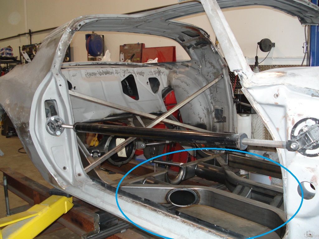

Frame Changes
We will be replacing the subframe connectors with a setup similar to AME's maxG chassis. The area circled in blue to get a mental picture. I have been in contact AME to get the materials needed. They sell a similar center section in pieces that I think we will be able to use.
http://i213.photobucket.com/albums/c...87markedup.jpg
