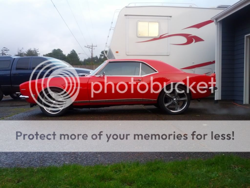

Surfman423 12-06-2012 09:13 PM
http://i452.photobucket.com/albums/q...206_160831.jpg
Finally got her back on her own feet with new shoes and new suspension.
camsdad 12-07-2012 07:44 AM
She looks sweet. Nice ride, nice stance!:thumbsup:
You running 2 different wheel sizes there?
Surfman423 12-07-2012 08:52 AM
18" up front and 20" in rear
